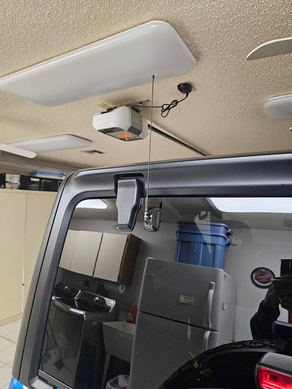

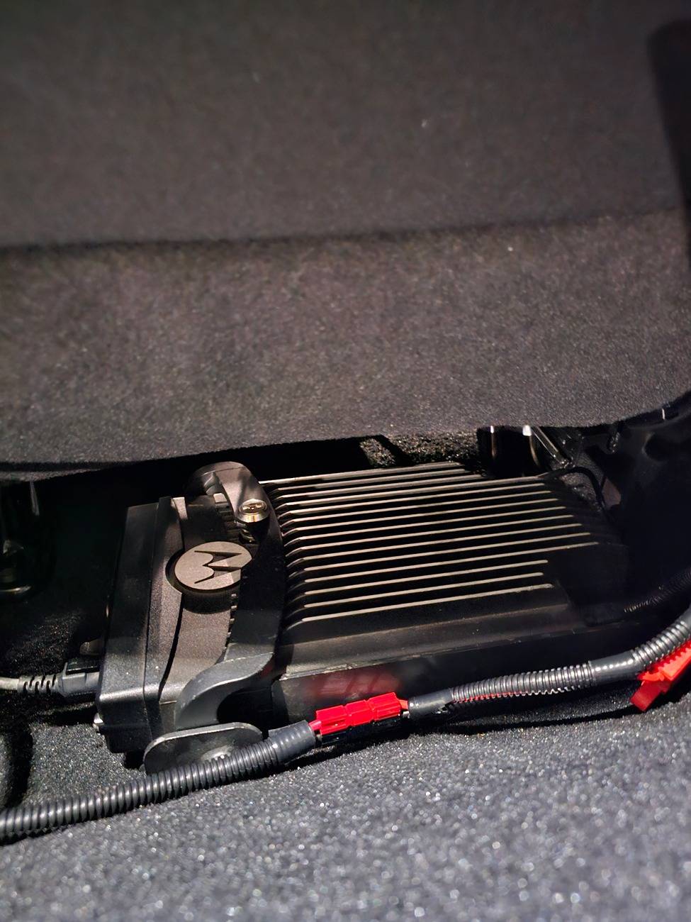

This is my GMRS antenna on my 23 Wrangler Rubi 2 Dr. The antenna performs better than I thought it would. The antenna tuned out at 1.25:1 on 462 Meg freqs and 1.7:1 on 467 Meg freqs and thatvis with 49.7 watts to the antenna.

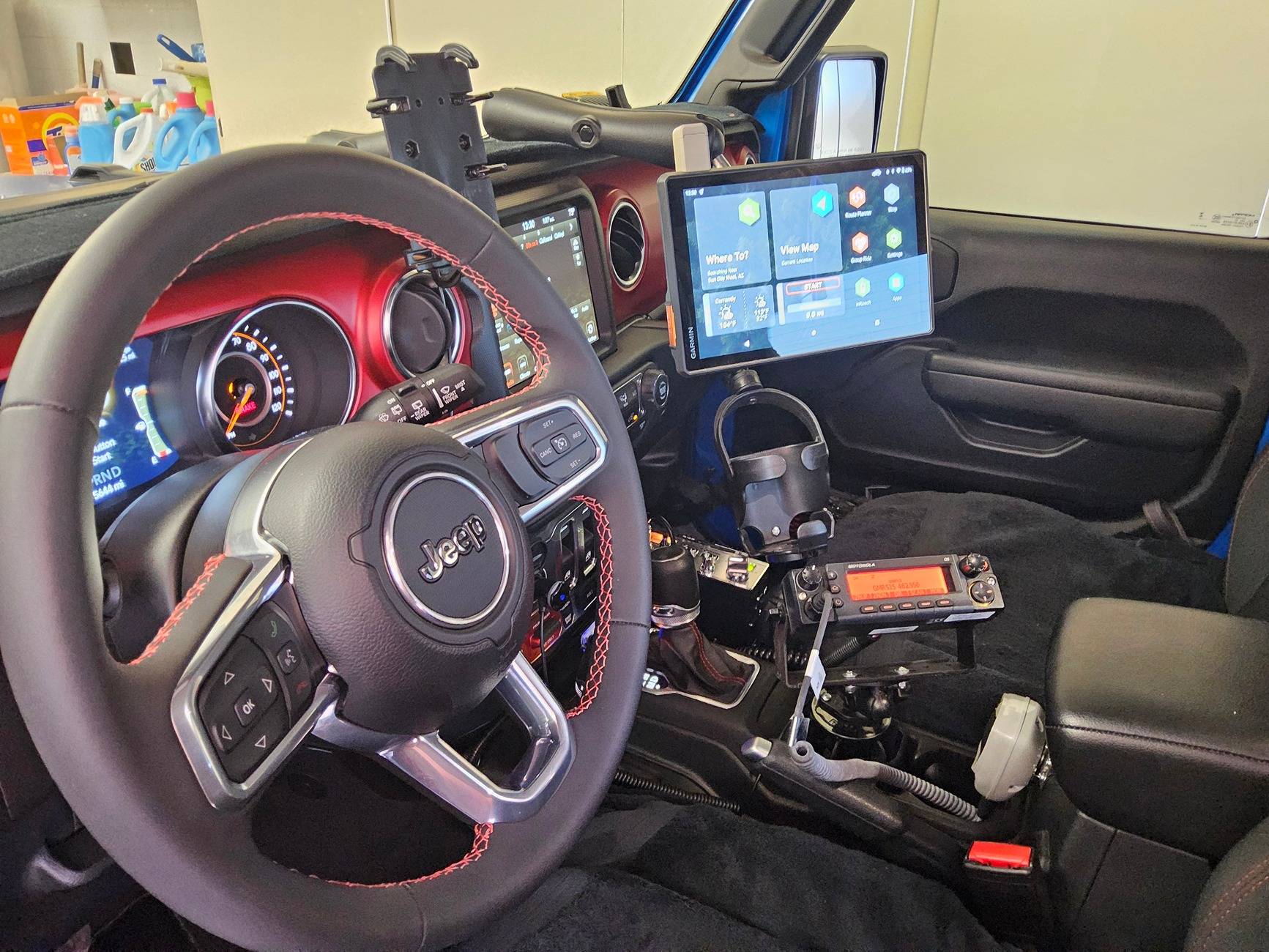

This is my CB Radio Antenna setup for my Cobra LTD Classis AM/FM. I'm using a 5 Foot Firestik II Tuneable Tip with a Walcott Radio cable. My VSWRs is 1.15:1 on Ch. 1 and a tad shy of 1.3:1 on Ch. 40. Occasionally, I do hear some CB radio trail comm on Ch. 16.
