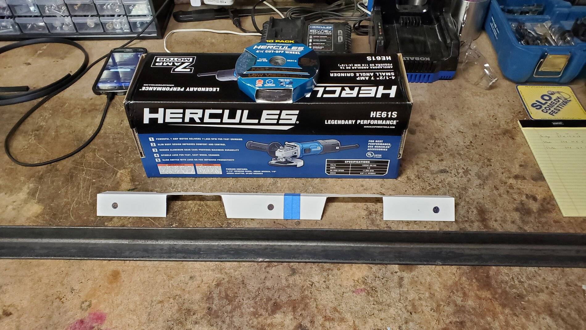

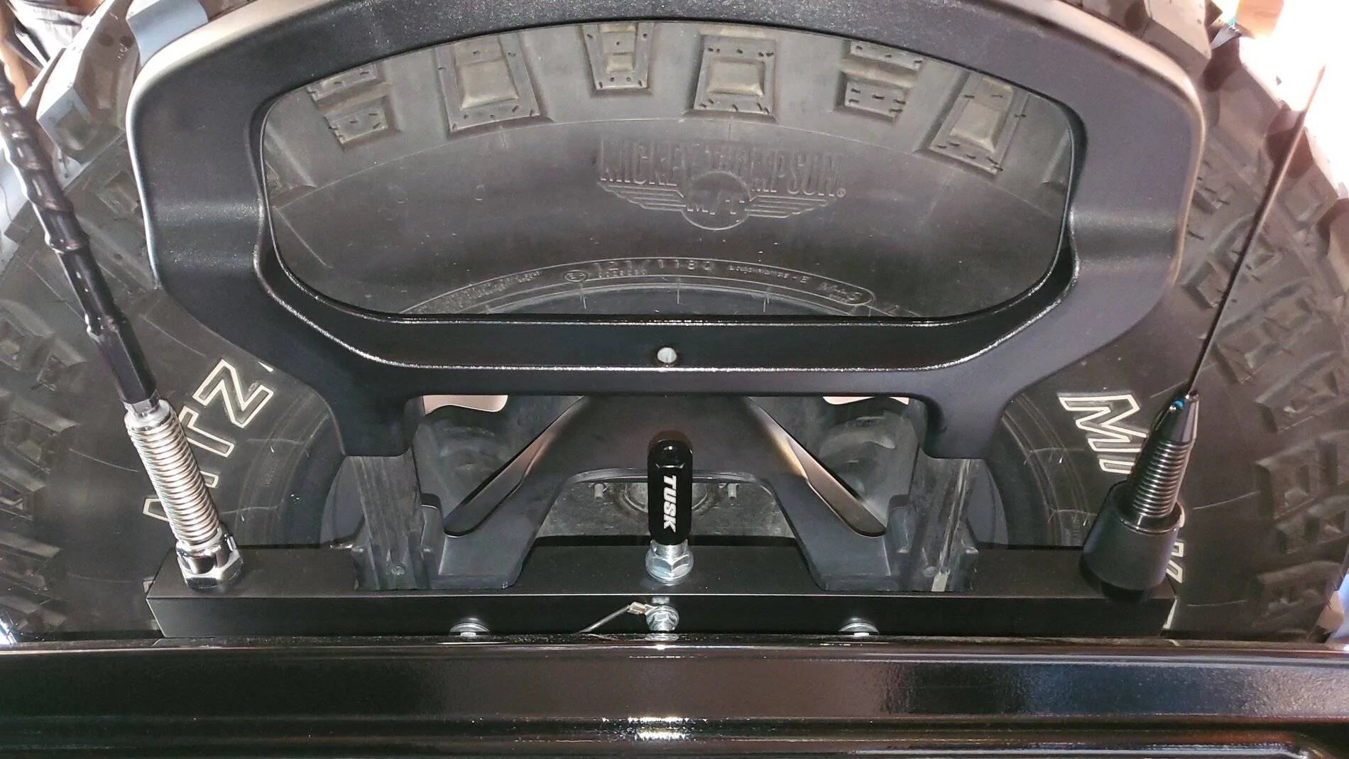

Did some digging for an all in one antenna mount for the Rough Country Relocation Bracket, to my surprise, nothing existed for what I wanted. So off to the hardware store I went.
Picked up a 3ft piece of 1.25in angle steel bar from Lowe's and grinder from Harbor Freight... made a template and got to work.
Jeep Wrangler JL All In One GMRS/CB/Flag Mount 20210523_160524
Jeep Wrangler JL All In One GMRS/CB/Flag Mount 20210523_163556

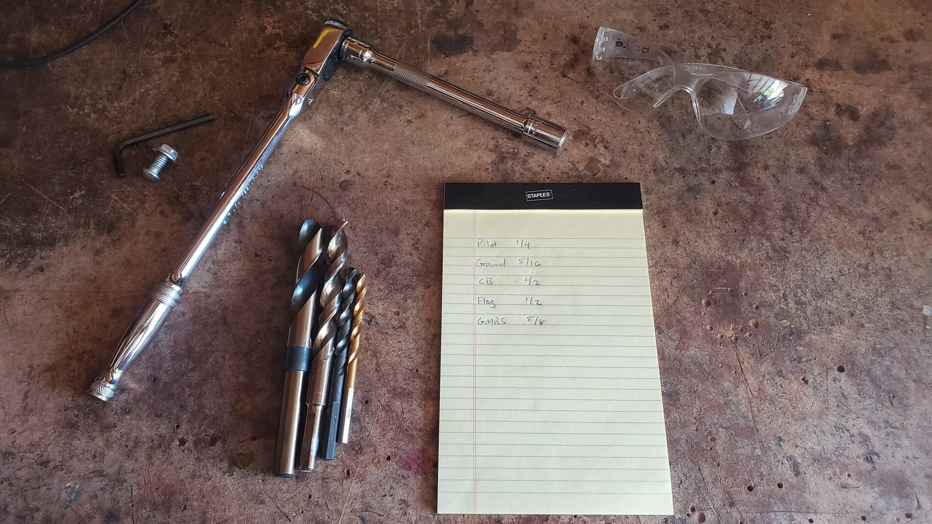

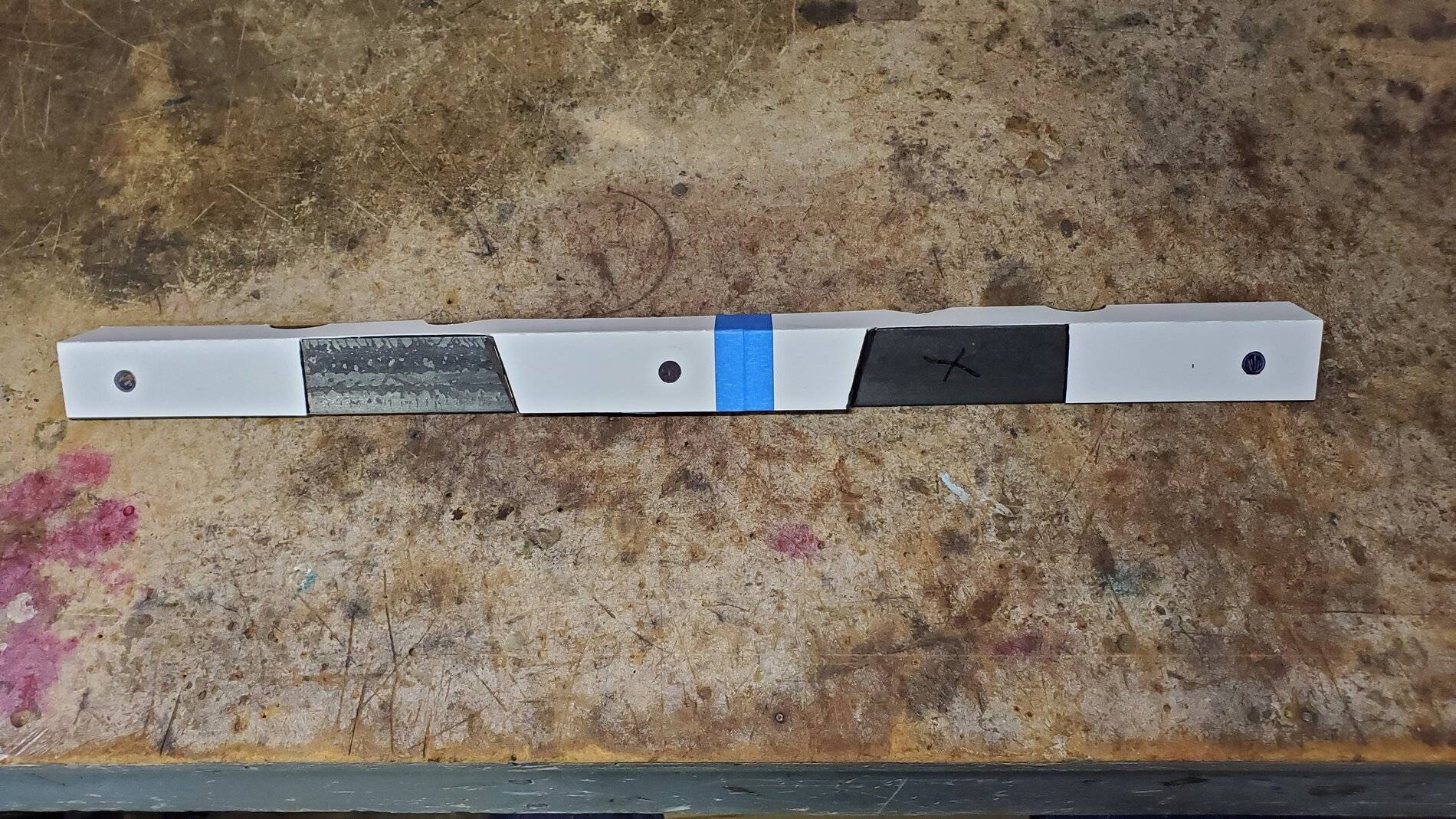

Marked out all the holes for each mount.
Jeep Wrangler JL All In One GMRS/CB/Flag Mount 20210523_182704
Jeep Wrangler JL All In One GMRS/CB/Flag Mount 20210601_142446

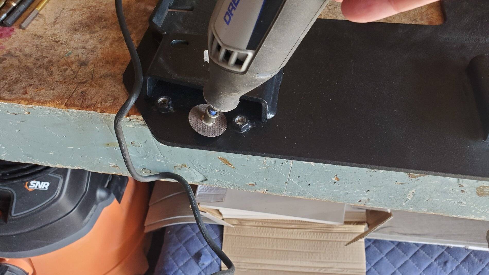

Now on to the spare tire carrier. Removed the Rough Country Relocation Bracket and buzzed off the two top nuts that are welded on.
Jeep Wrangler JL All In One GMRS/CB/Flag Mount 20210601_144726
Reattached the the spare tire bracket and spare tire holder, using the top two holes to mount the all in one mount flush to the carrier. (you will need 1/4 inch longer bolts with 2 washers to secure the mount... sorry did not take a pic of that step) I added a third hole in the center, this acts as a ground and more stability for the mount.
Jeep Wrangler JL All In One GMRS/CB/Flag Mount 20210601_211811

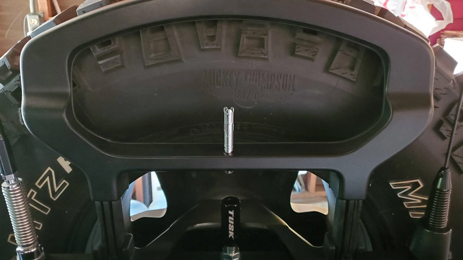

Next comes the hole in the third brake light mount, to allow room for the quarter inch Whip Flag to drop straight in.
Jeep Wrangler JL All In One GMRS/CB/Flag Mount 20210602_154132
I used a Red Head 3/8 inch diameter sleeve anchor and cut it down to size. I glued this in place, this will reinforce the third brake light mount and keep the flag from bouncing up against either of the two antennas.
Jeep Wrangler JL All In One GMRS/CB/Flag Mount 20210602_171023

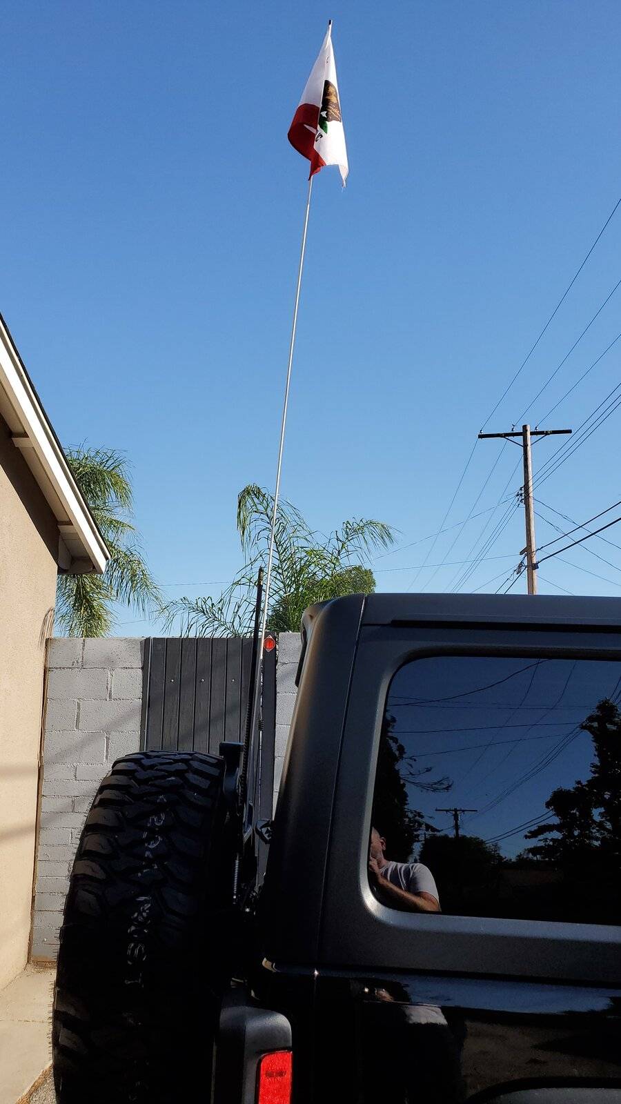

Last was the test fit for the flag.
Jeep Wrangler JL All In One GMRS/CB/Flag Mount 20210602_172051
Final side view pics of everything installed, with plenty of room all the way around.
Jeep Wrangler JL All In One GMRS/CB/Flag Mount 20210602_172100
Jeep Wrangler JL All In One GMRS/CB/Flag Mount 20210602_172111

Thank you. It was a bit of a PITA, but worth it. I wanted everything behind the spare tire. The hardest part was grinding it down to get the angles right around the brake light mount. Once I painted it, it blended in perfectly.
