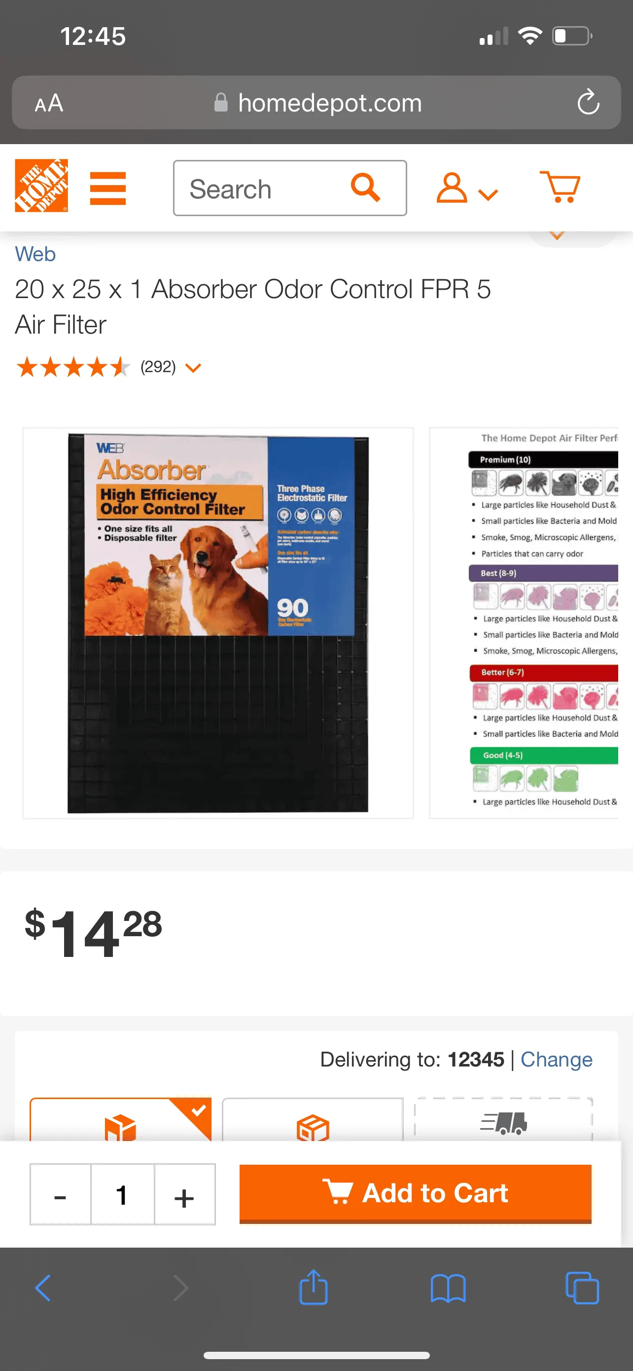

I’ve never tried this but… A couple of people in the Jeep clubs here buy these and cut them to fit, and or cut to fit the washable ones. $20 and forever use supposedly.
Thanks man, definitely going DIY for the Cabin filter for sure. Will give it a whirl..

Since they are basically the same as the air filters your home A/C uses, you can make your own for a lot less. Buy one of the "cut to fit" home A/C filters and you can make enough to last for months. I've been using homemade filters for quite a while with no issues, and most of my driving is in the desert so I need to change them often. The approximate dimensions of each filter is 7 5/8 x 4 3/4 x 1 inches.
