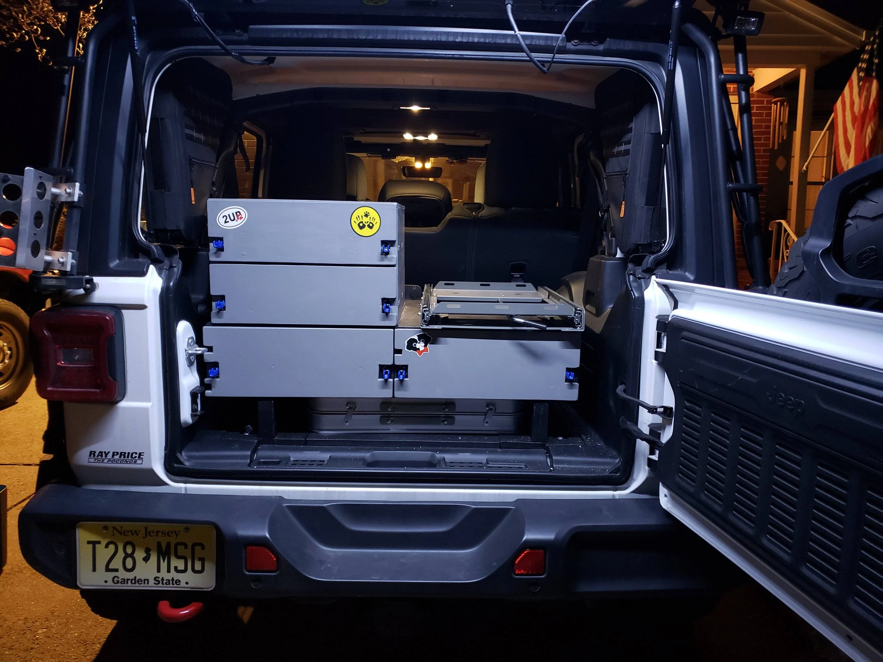

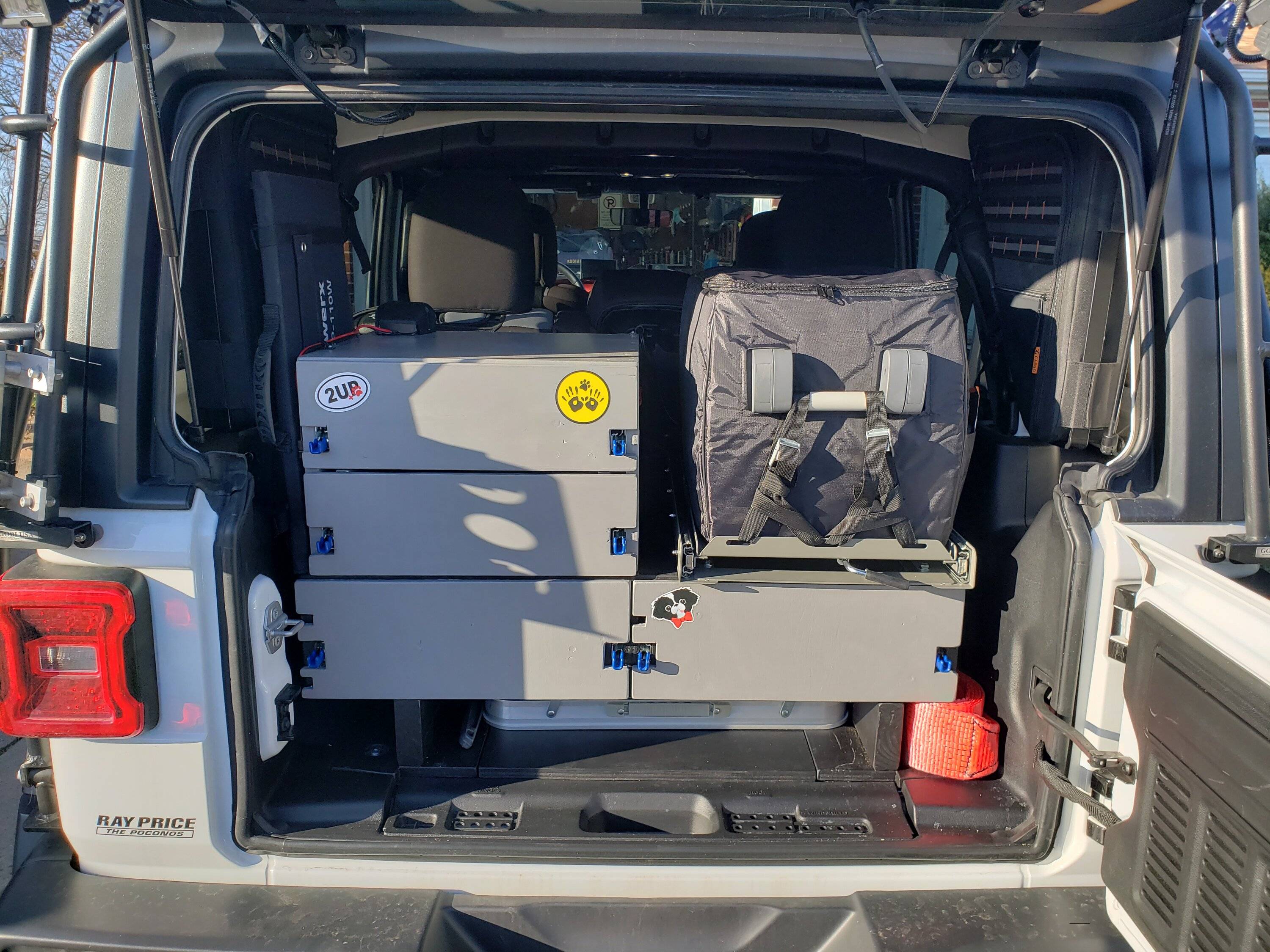

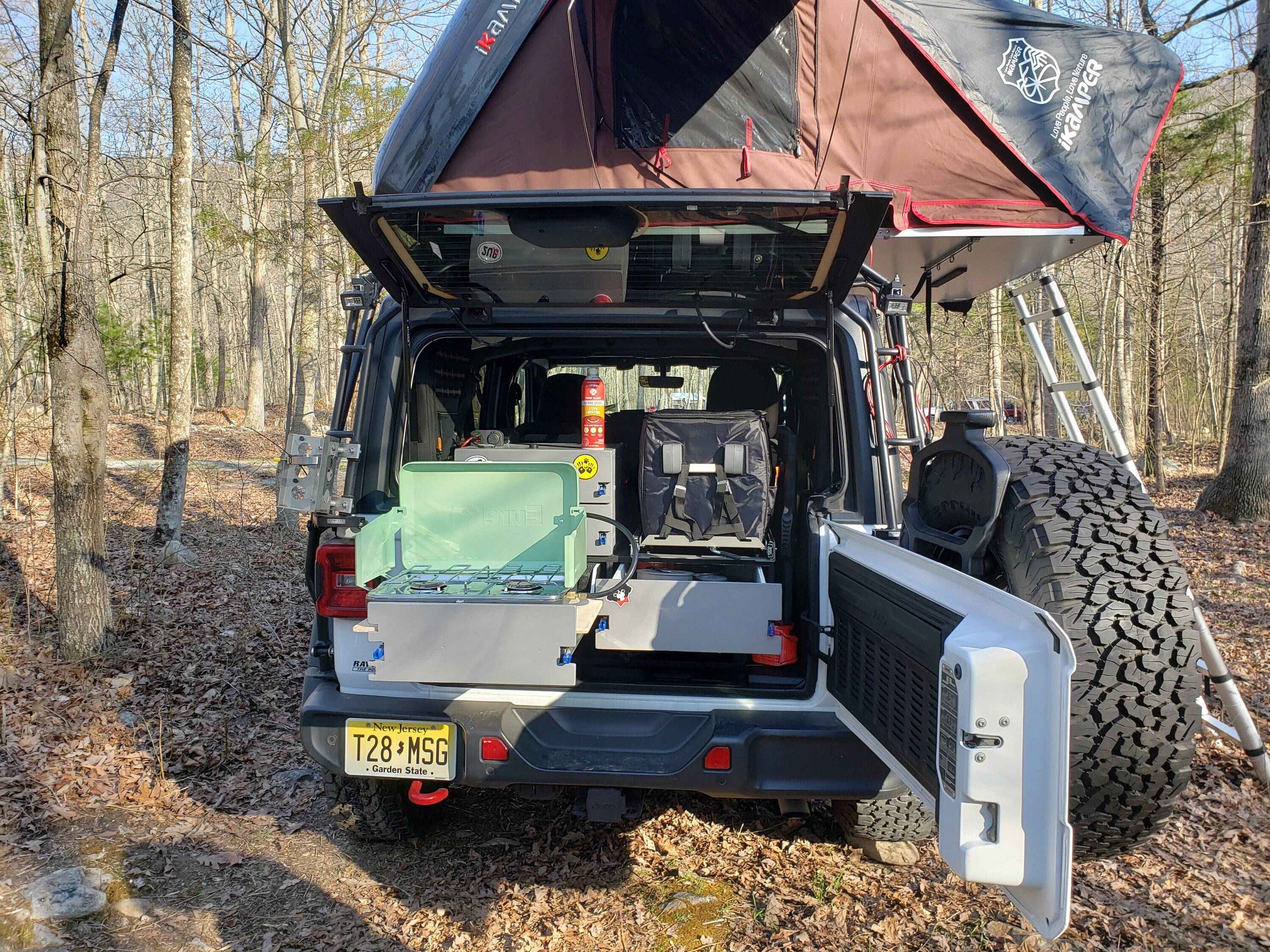

this is the first revision of my box, i've since found it didn't work for me and the only thing i kept was the base and the box under the fridge. i would recommend lifting the base a little like i did so you can access the storage cubby and slide a table under the whole thing without losing much space. the fridge rent right to the rear seat and on the drivers side i had my house battery behind the upper box. sketchup helped me layout and plan the whole thing.
Jeep Wrangler JL Building custom rear storage boxes + camping gear 2020-11-29 15.21.15
Jeep Wrangler JL Building custom rear storage boxes + camping gear 2021-03-08 19.42.00
Jeep Wrangler JL Building custom rear storage boxes + camping gear 2021-03-20 17.41.51
Jeep Wrangler JL Building custom rear storage boxes + camping gear 2021-04-03 17.30.53
Jeep Wrangler JL Building custom rear storage boxes + camping gear 2021-03-20 17.48.48

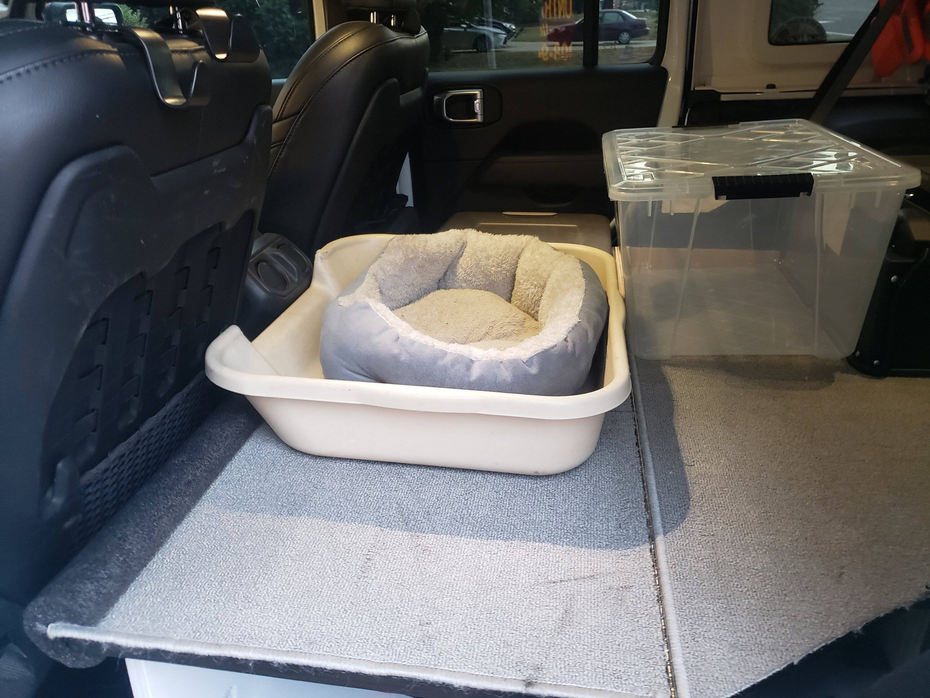

this is where i'm at now, with the rear seats gone i prefer using containers and having more flexibility of having a platform and dedicated doggie space for Kodiak. i really wanted to like camping out of a dedicated "box system", but there was just never room to pack what i wanted. the house battery is now a GZ 1500x thats now under the platform in the passenger drivers side footwell.

Super helpful, thanks for the photos! Is that a permanent solution? My goal isn't permanent - it's for the ~4-5 times/year that we go camping, I'm basically trying to consolidate all of my stuff from two big, bulky, tall plastic bins down into these two flatter boxes, so that I'm really only losing 9" of height in the rear cargo area. More boxes, not drawers.
I like your idea of a slot for a table or something, as well - good call.

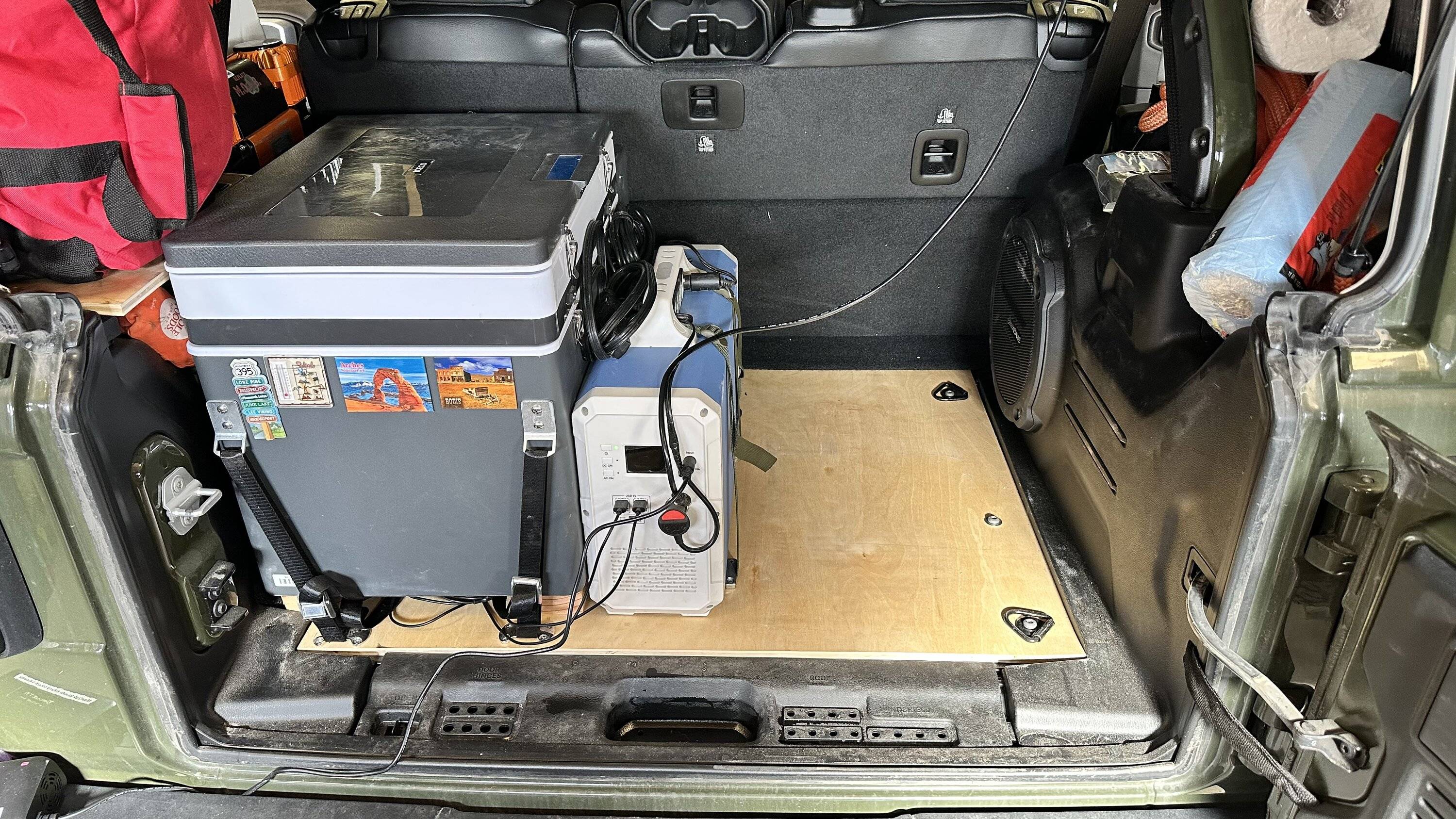

I have already started constructing out of 1/2 inch plywood. I have replaced the large flat carpeted bottom with a sheet of 1/2" plywood (29" x 36.5") tied down using the six factory bolts. I use it to screw in some tie-down for my battery & my fridge. Also, it now lets me access my scissor jack without having to unload the entire trunk (like the original flap forced me to do).

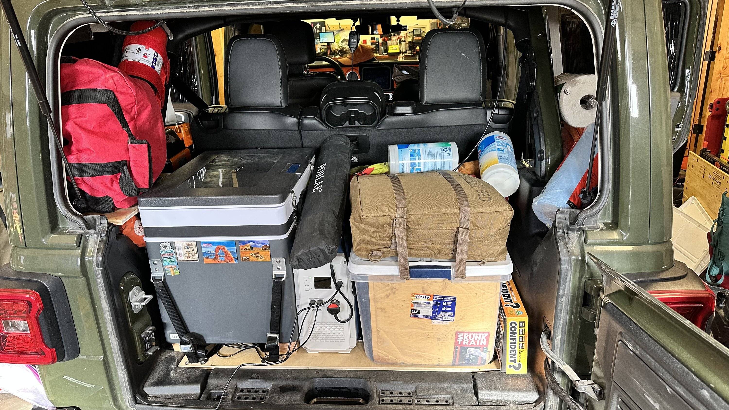

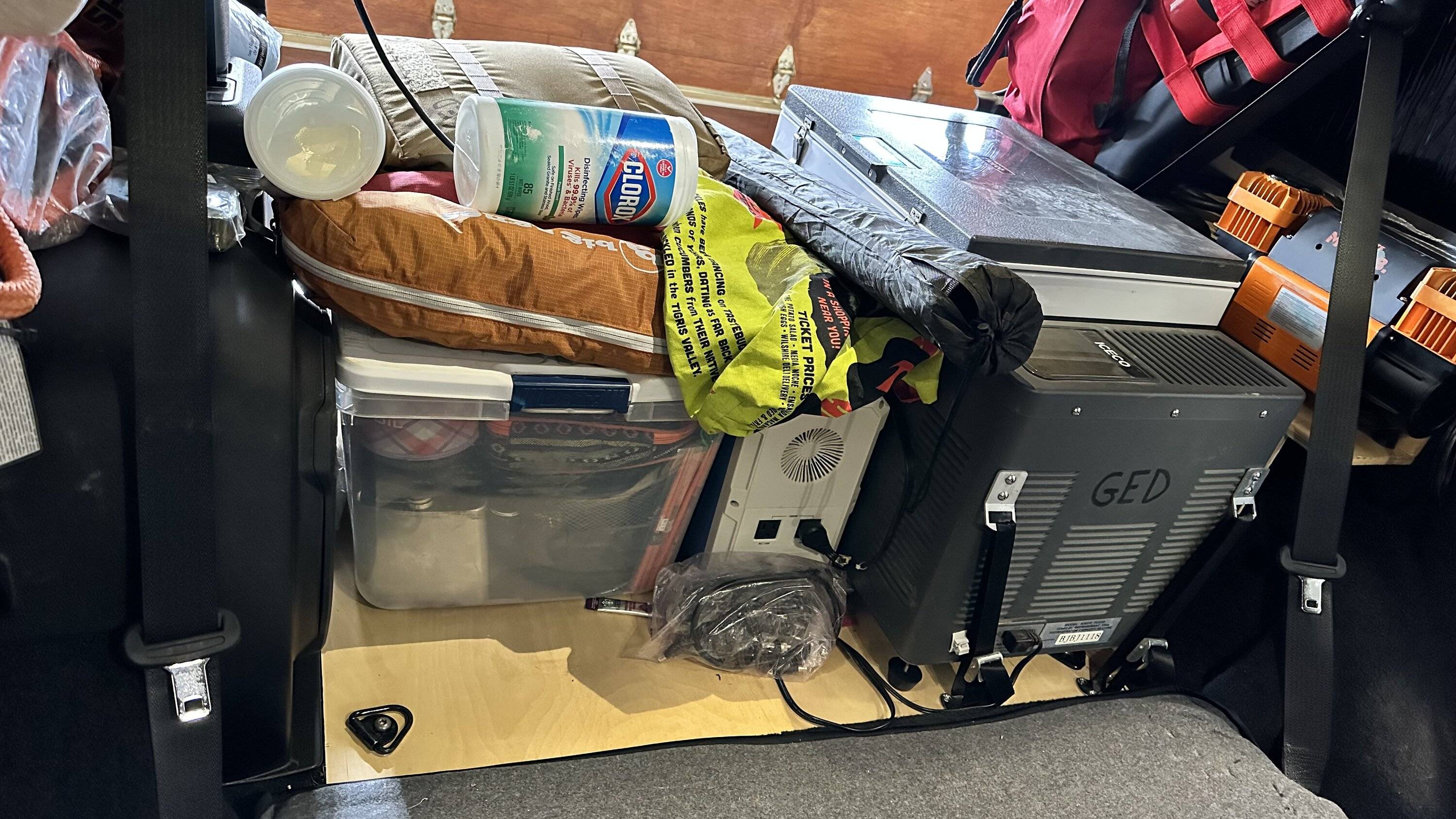

I just got my Jeep and was leaving for an off-road camping trip five days after.
I just had time to install the rack, the RTT, hardwire the Air Compressor and a few more accessories.
Here it is looking at it from the rear passenger door with the rear seats folded:
Jeep Wrangler JL Building custom rear storage boxes + camping gear IMG_6972
With all the trip crap still present:
Jeep Wrangler JL Building custom rear storage boxes + camping gear IMG_6973
Removed the 13 gal box so that you can see 3 of the six factory bolts:
Jeep Wrangler JL Building custom rear storage boxes + camping gear IMG_6974
I just have footman loops screwed into that floor so that my fridge and power station are strapped. I did not have time to make a nice cut for a door to be able to access the under floor storage. I just emptied it as it is quite small on my jeep.
I am now able to access the scissor jack without emptying the trunk. This is verified as somebody on our trip busted a tire of the wheel, and we used the scissor jack and air compressor to reseat it on the bead.

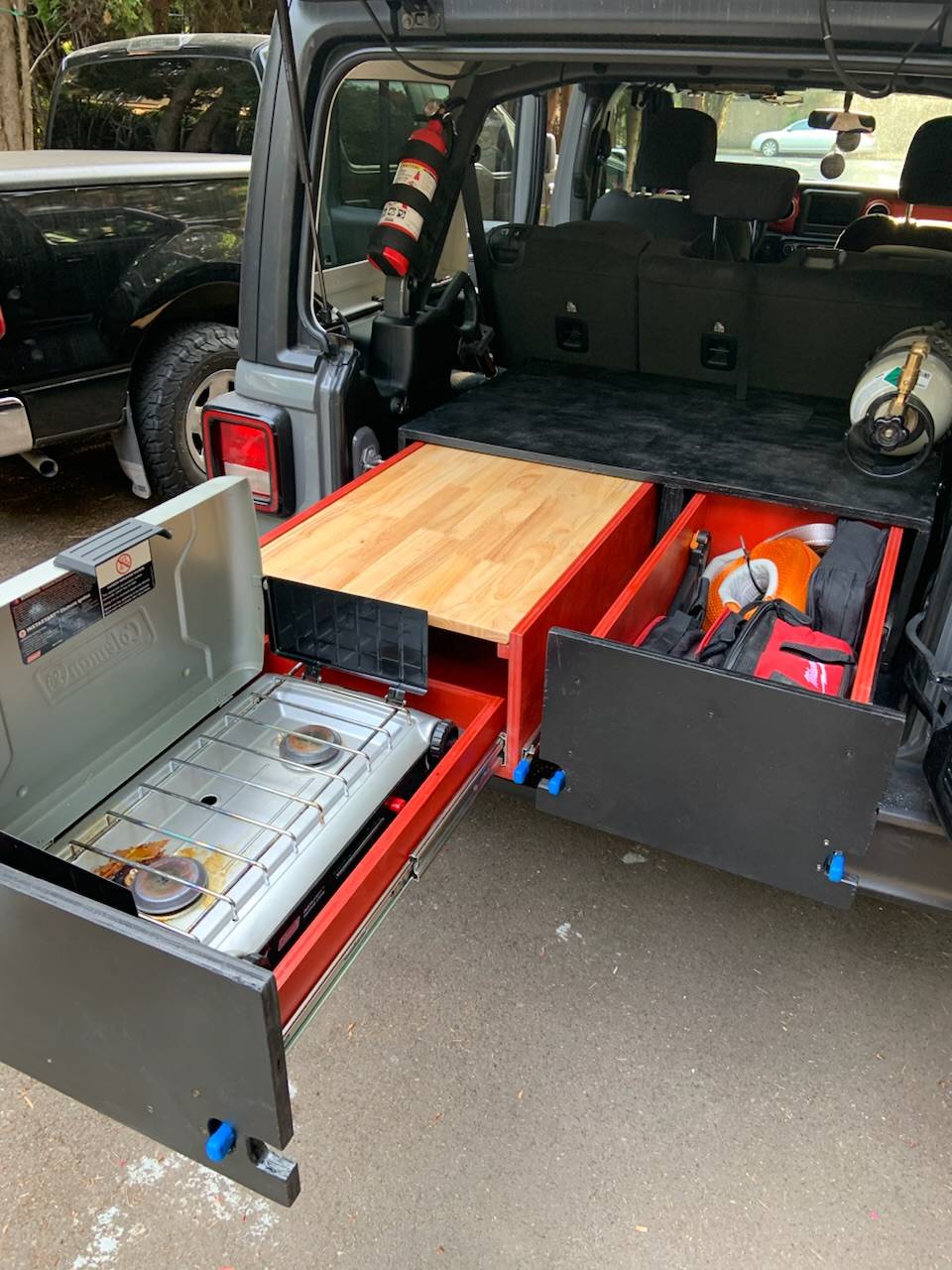

Here is my setup, build from 3/4” plywood, first time building with wood and it turned out pretty good ??

So is the whole enclosure removable? I hadn't thought about approaching it like that - a short, two-drawer "chest" that I just pick up and place into the Jeep (vs two separate boxes). I also like the idea of the cutting board - do you have trouble reaching it in there, or do you typically pull it out to use?

it is removeable, it’s held in place with some ratchet straps to the rear set brackets, not at all the cutting board slides back and forth on some rails.
