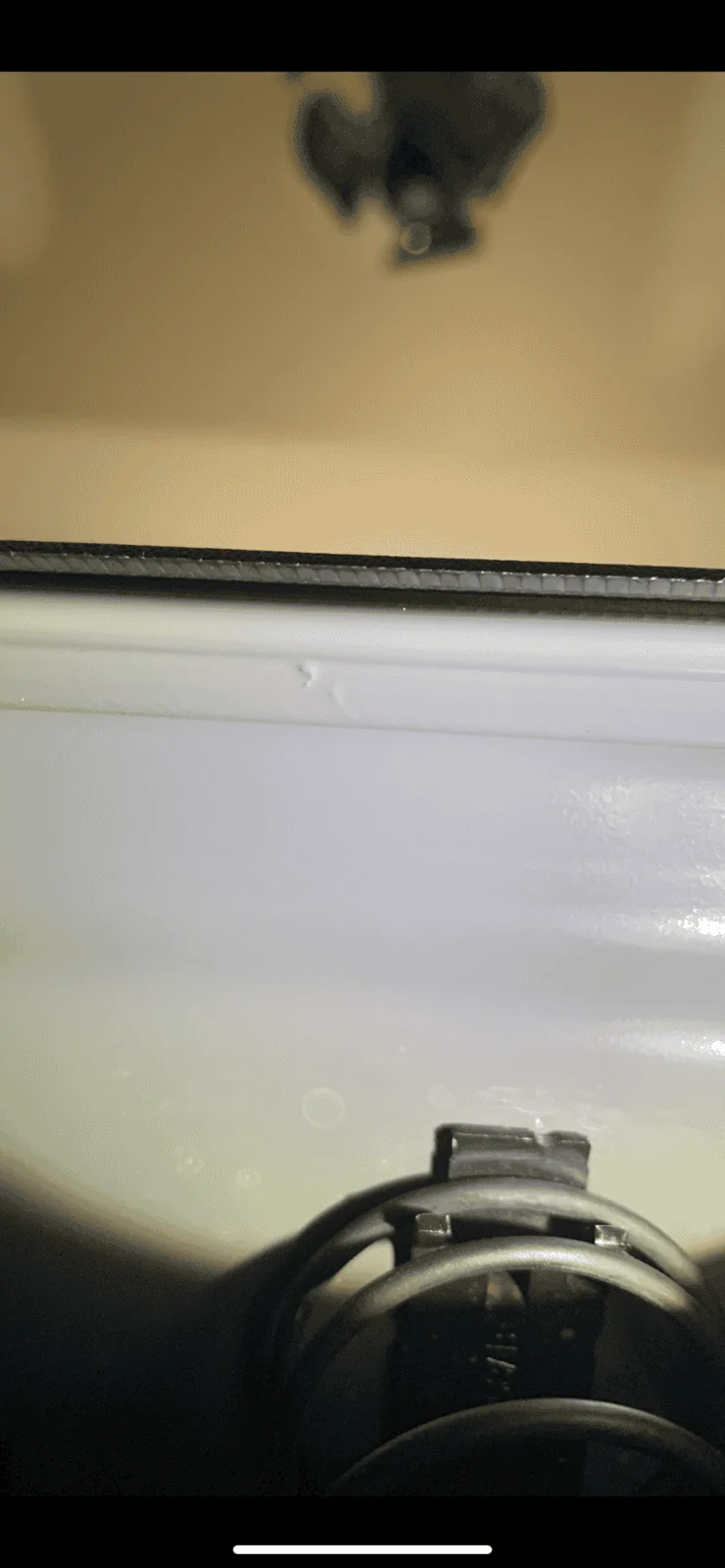

not a door hinge, but this is underneath my hood, right by the spring. Does this look like corrosion , or just an imperfection in the paint job? I’ve noticed spots like these on the insides of my doors right when I picked it up, thought it was most likely just a dirty spray nozzle or something in the paint finish (not corrosion). Anyone else have spots like this and know for sure what it is?

To me that looks like the seam filler that they use.
Thanks! That’s pretty much what it looks like on the doors as well. I’m on high alert with keeping an eye out for corrosion on my Jeep haha
