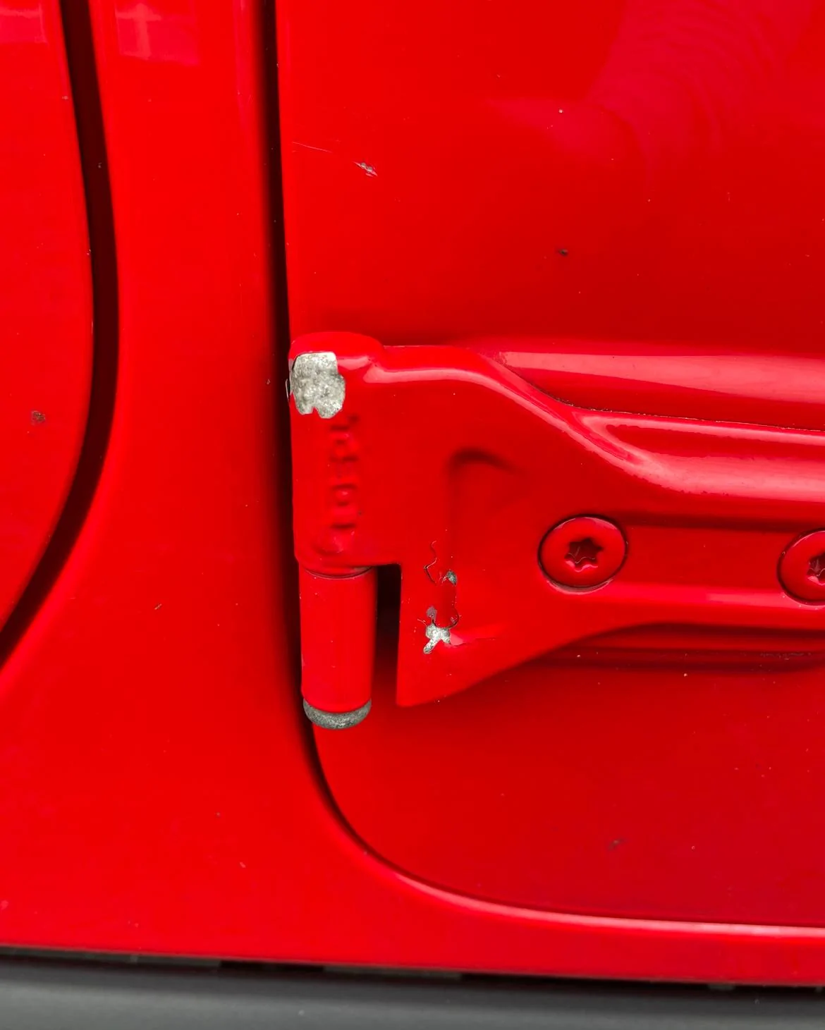

I basically have paint bubbling on all 8 of my door hinges. That being said the hinges on the hood look ok for now. I am wondering if I should jump the gun and pay to have them replaced. My 5 year rust warranty is up within the next few months. I believe someone mentioned that new hinges come with some sort of metal spacer which I would assume helps to prevent the galvanic corrosion which is what appears to be going on here...
I haven't seen a single person post a picture of the spacer once the door is removed. I don't believe this is true. I think they're confusing the primer / bare metal under the hinge for a spacer because it's a different color.

If I’m not mistaken, there is a zinc shim, that sits between the door panel, and the new hinge.

Don't believe it's available separately... It's a redesigned hinge assembly. Unless you're very creative, and could make a shim from a sheet of a zinc material...

Wouldn't your new door's hinges already have the shims? Otherwise your looking at about $70 per door for new hinges. Also, for maximum affect the zinc shims need metal to metal contact which may not be practical with a repaint.

I don't think in 2021 they had the new style hinges yet, so there would be a visible difference between the new hinges and the old ones. The old hinges are flat on the back, the new hinges have a small offset ridge around the perimeter and will have a small gap around the perimeter when they are installed. Here's a pic with the old style on top and the new style on the bottom.

New style also appears to be painted to match before being bolted on vs old style painted after being bolted to the door.
