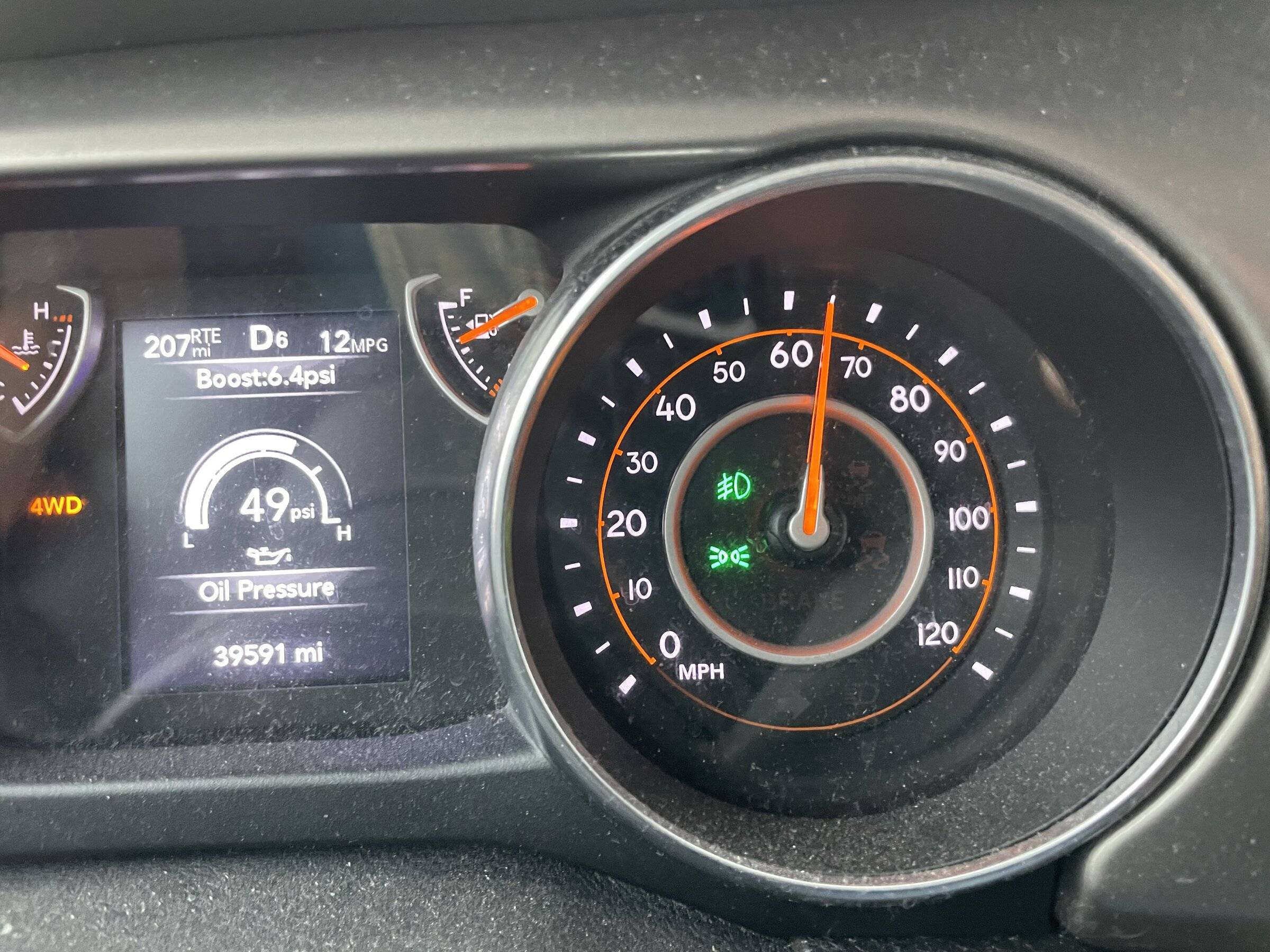

I'm aware. This is where I have mine set.

It's instructive to observe that you have the fuel mileage display immediately adjacent to the boost pressure data. ;) The higher the latter, the lower the former?
Oh of course!
Interesting observation though. It wasn't done on purpose. That's just the way I used to have my Cherokee KL's cluster set up, and I just set my JL up the same way. When I plugged the TazerJL Mini in, the boost gauge just replaced the radio station display. There's the story on that.

How did you get the boost on the oil pressure display?
I see Vacuum under live settings in the Tazer menu, but I don't see anywhere to actually modify the center display to show boost.
