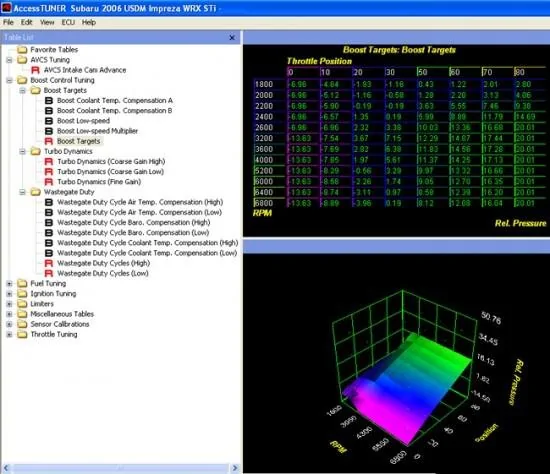

The below is basic but gets a little bit to my question.
___________________________
The ECU can vary this duty cycle signal to the wastegate solenoid to vary the boost higher or lower, to account for temp changes, atmospheric pressure changes, provide a steadier boost curve and even cut boost in situations when a failure has occurred. The ECU has many special maps/tables that determine the DC to use to control boost. This includes target boost tables, min and max DC tables, Boost error trim tables, air temp trims, speed trims gear trims and many more. The ECU uses these with a complicated algorithm to calculate duty cycle and then adjust it to reach its target boost. Here is an example of how this works and an example of the diffent typs of maps used to control boost.
Jeep Wrangler JL 2.0 boost - when & what controls boost tech_boostcontrol_boostmapscreen-550x474
If the ECU sees the driver giving 70% throttle at 4000 RPM it reads a map that says it needs to hit 14psi. The ECU starts with a duty cycle of say 50%. Say it only hits 12psi at 50%, the ECU knows its off by 3psi and adds more duty cycle based on a boost error trim table. Say this equals 5% more duty cycle. Now its running 55% and the ECU is seeing 15psi of boost. Its still a bit high and using this boost error trim table it now pulls some duty cycle from the overall 55%. Lets say it removes 2% and now is at 53%. Now it hits its 14psi target and the ECU is happy until the boost starts to fall as the RPMS rise, or until the driver gives 100% throttle making for a new target boost. The calculations start all over again. This back and forth, and calculating happens many times a second to provide the engine with a steady boost curve. This is a very simple version of what actually happens. There are things like the time it waits to see if the calculated duty cycle actually worked, and start RPM's, gear ratio comps air temp trims, and many other things. This is a pretty complicated process but its what makes modern day turbo cars function so well with little turbo lag and all the safety features.
