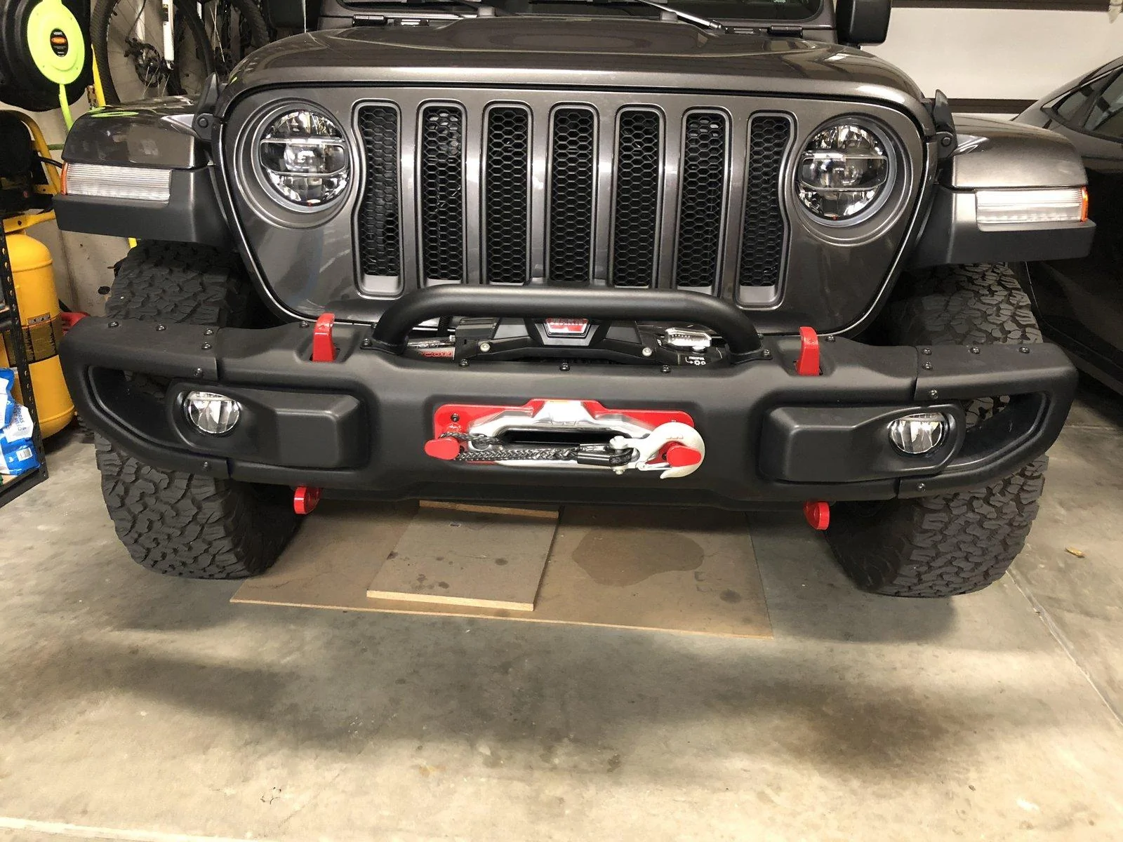

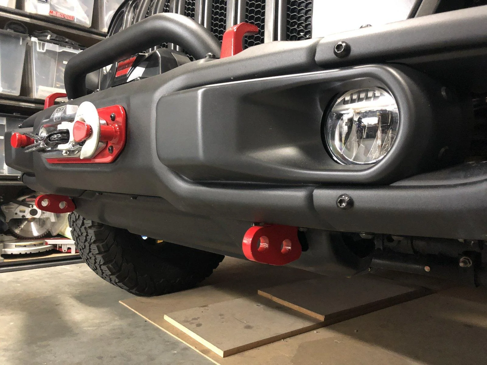

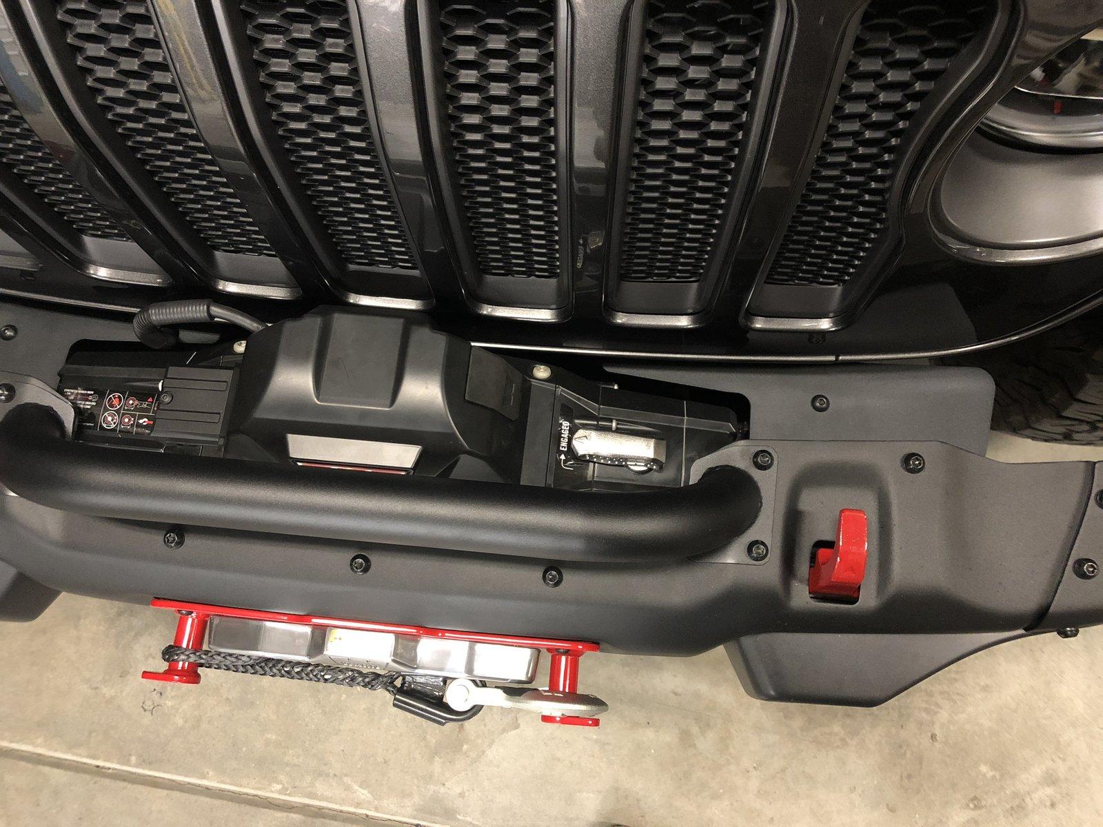

Thought I would share my latest winch and tow loop set up on my JL. Winch plate, winch hook anchor, filler trip plates, and JL tow loops from www.maximus-3.com. Winch is the Rubicon version of the Warn winch but I bought from www.moparonlineparts.com as they seemed to have the best price at the time and had it in stock.
Tow loops are not on the Maximus-3 website yet due to very limited quantities but they are heavy duty and fit great - I think they are the cleanest setup I have seen. Did not want a square-tube bar mounted under my bumper for towing. You do have to cut slots in the bottom side of the bumper but that was not too hard as long as you have a metal cutting hole saw ($10 at ACE Hardware) and a cut-off wheel for your grinder. The instructions included show using a 1.5" hole saw and making a 1.5" channel in the bottom of the bumper. With the tow loop being 5/8" thick, I chose to use a smaller 1" hole saw and cut a 1" channel and had no problems (forgot to take a picture of that).
On the winch plate install, I did have to do a little grinding on the winch plate to make it fit. Mainly because there was some excess weld on one side of the Jeep near a bracket and that bracket on the Jeep appeared to be in a slightly different location from the left side vs the right side. Maybe 1/16" different but that was enough to need to grind down the winch plate slightly so the bolt holes would line up (did not want to grind on the Jeep). Easy fix though.

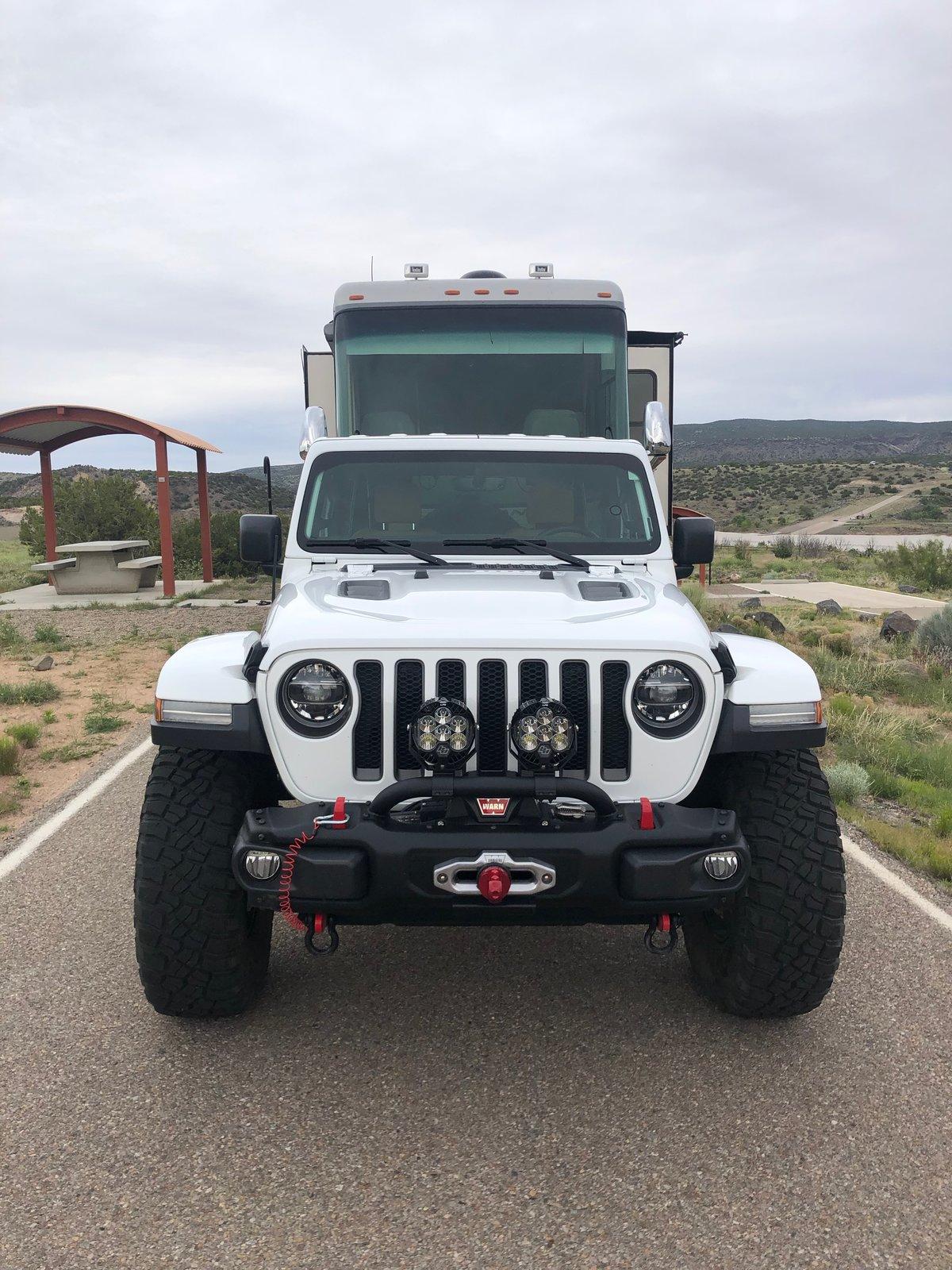

I am thinking about going with this same setup. What solution did you use for the safety cables? I don’t see a good place to hook them up.

@Sweetpea, I've seen people use the rear most hole of the tow loops to attach safety cables. I've also seen people use safety cable extensions, and loop them around the frame to connect to.
I use the rear holes of the tow loops for the safety cables. The chances of the tow loop failing before the tow bar is probably minimal.
Also, I run my break away cable through the passenger cutout for the tow loop and attach that to the bumper of the RV.
So far Ive towed the Jeep a little over 10,000 miles since January and all is well. Do yourself a favor, check the bolts on the tow loops after your first tow and every so often. You also might want to use loctite.

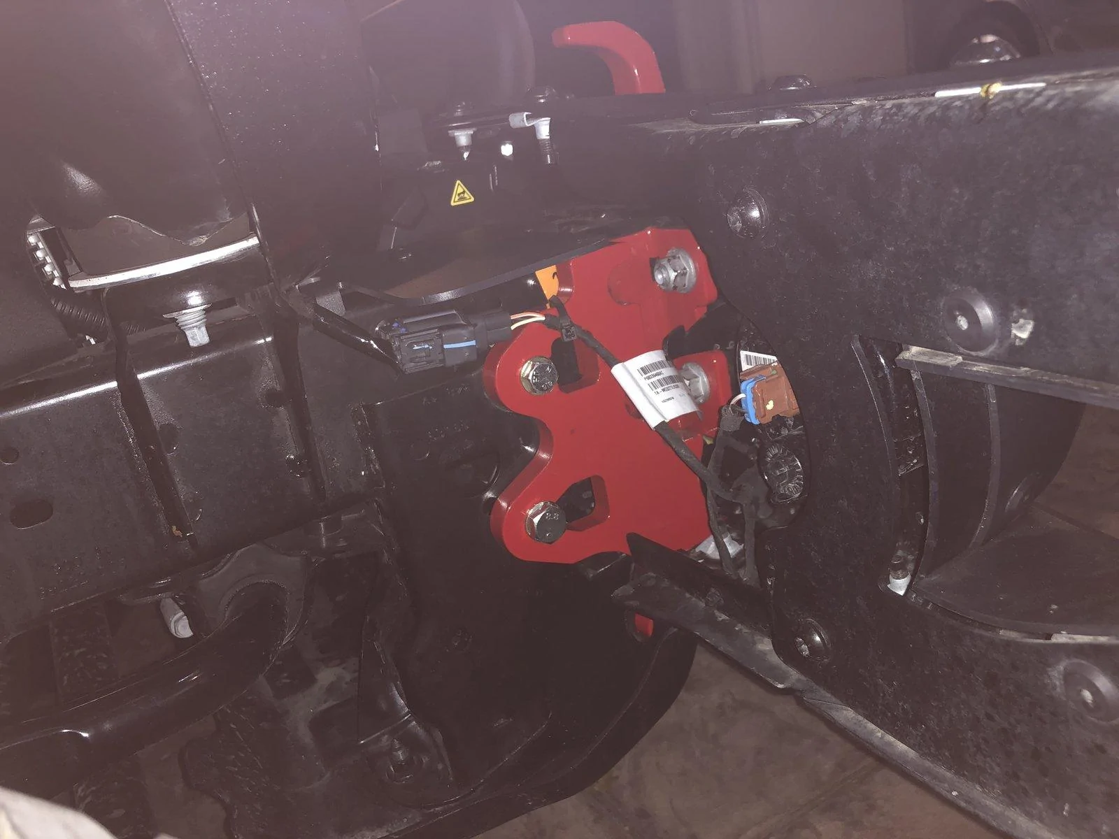

Safety cable connections to the Maximus tow-loop brackets. . . the standard cables that came with my Blue Ox tow bar were not able to connect to the lower / back hole in the brackets, as the clip at the end couldn't handle the thickness of the bracket. The tow bar connects to the forward / upper holes in the bracket. I ended up buying these Curt clips from Amazon (https://www.amazon.com/gp/product/B000LOI69C/ref=ppx_yo_dt_b_asin_title_o03_s00?ie=UTF8&psc=1) to add to the ends of the safety cables and they fit the Maximus holes. I chose those clips since they have a stated load rating and have had no issues so far. I hope this helps!
