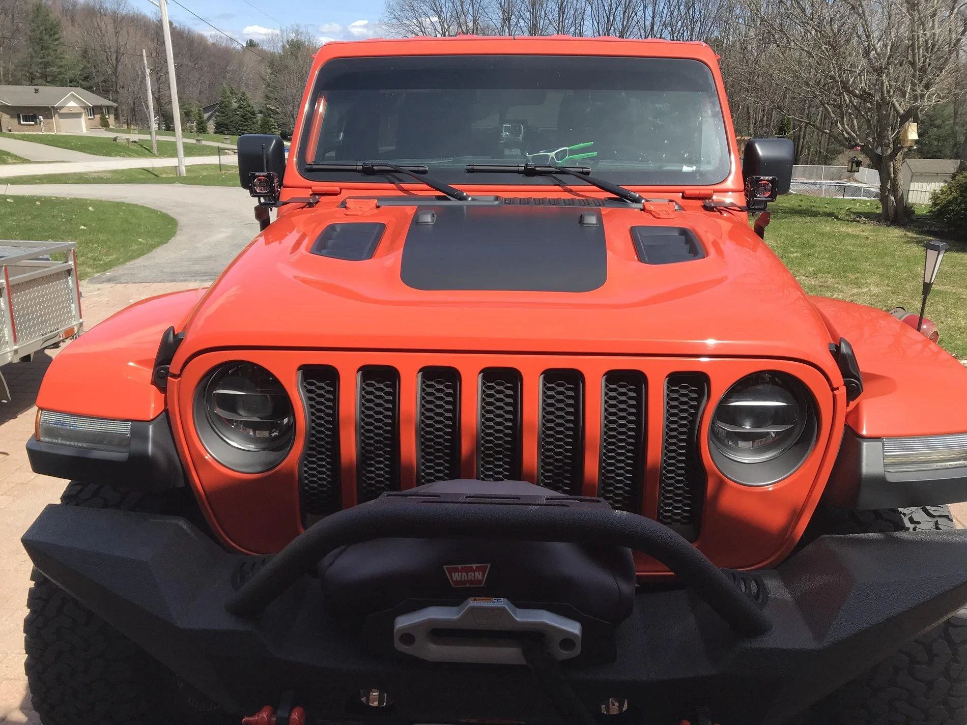

I just put that on my 2018 JL with a Smitty Built winch. Easy to install, got the tow adaptors for a Roadmaster tow bar, really solid and structurally sound. Looks good too. Yea it was priced a little high but it works exactly as advertised.

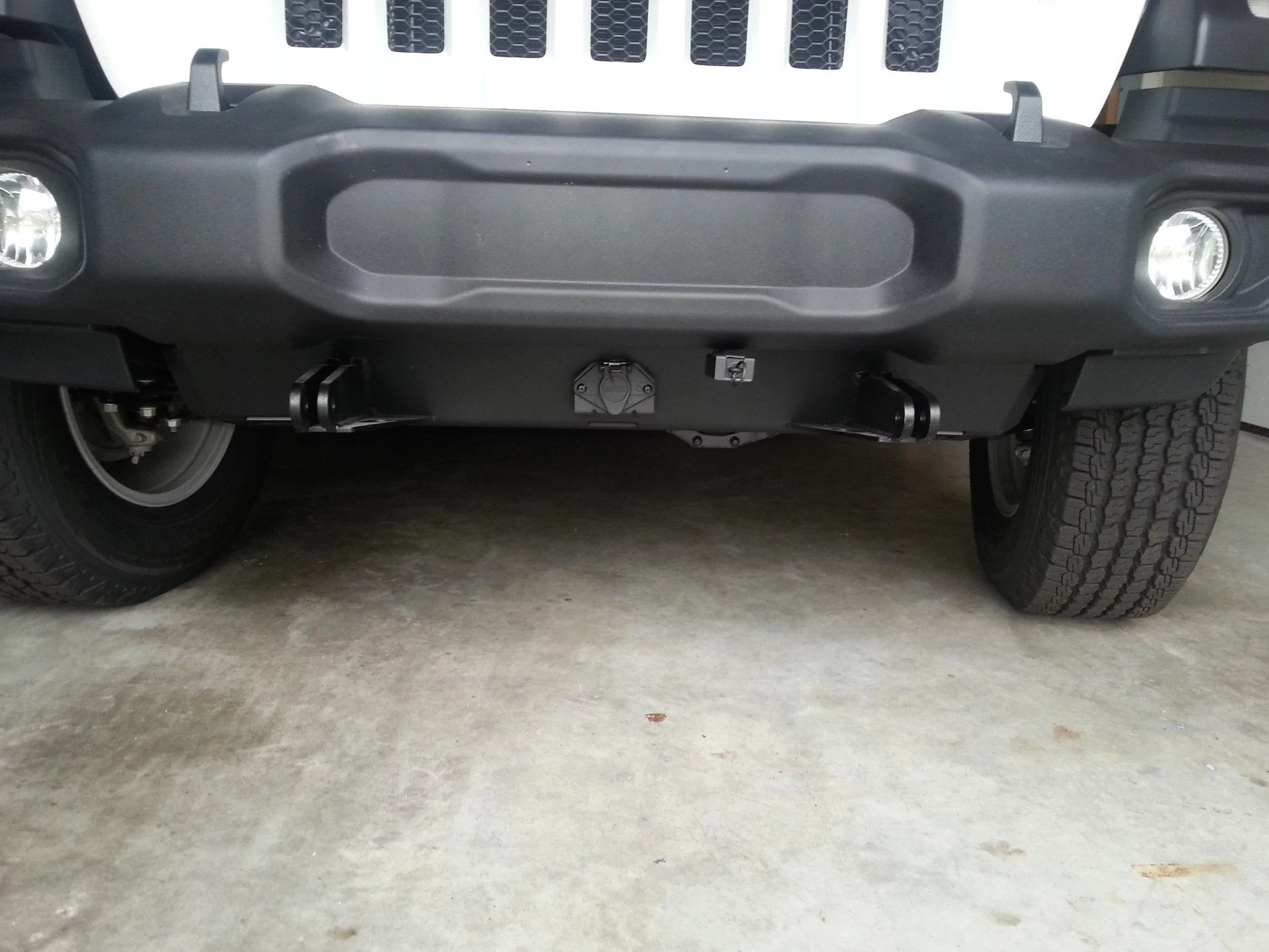

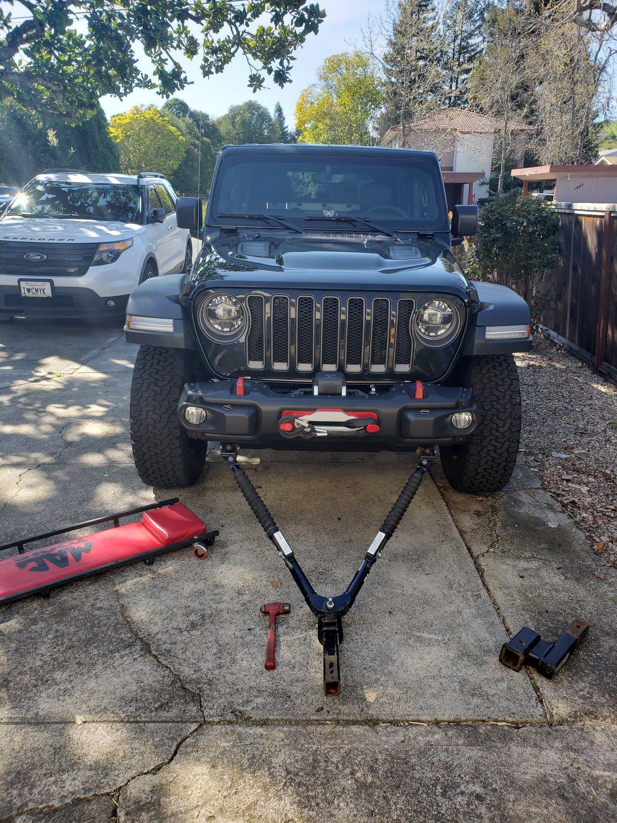

I just completed setting up my rig to be flat towed. I used the cooltec harness and then wired it with a 4 way flat connector since this is how my other jeep is setup to flat tow. I also installed Maximus-3 tow loops to connect the tow bar. I am using the Mopar steel bumper, I am not a fan of most of the aftermarket bumpers so this is why I went this way. I can confirm on the 2019's all of the color call-out wires in the Cooltec instructions are spot on. Photos show tow bar connection and how I wired the Cooltec to the 4way; the connector now rests behind the winch.

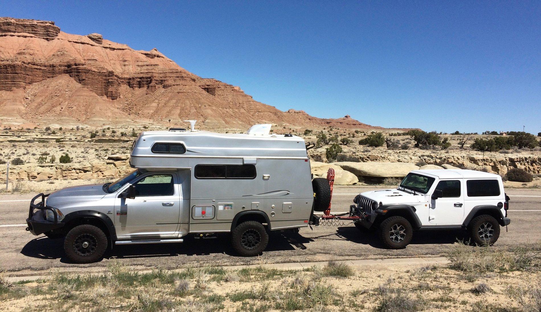

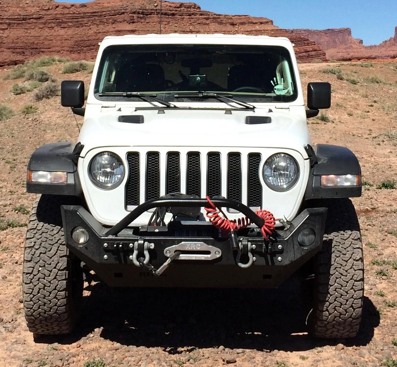

I don’t know what is best. I installed a Rock Hard Patriot aluminum bumper on my JLR. It’s light weight, has tow bar options, winch mounts low, has some frontal protection for the grill and fenders and I kept my fog lights. Not real thrilled about the price but it seems made well and in America. Already logged 1,600+ tow miles.
About the only unresolved issue is where to relocate a 7 pin plug. I hole sawed into the diagonal wing on drivers side and installed the receiver plug. While on 1st trip towing during a rain storm the plug filled with water and set off a slew of dash lights on my tow vehicle. Once I dried out the connection and sealed it with silicone, all was fine. I ran around E.J.S. Moab with the orange umbilical cord connected. I’ve yet to relocate the plug.

Blue Ox tow bar and braking system. Cool Tech flat tow wiring kit. Everything worked fine on 1st trip except for the wet plug issue.

I still need to look into the water matter more closely. I’m not really sure having the plugs verticule will make the difference.The water intrusion was between the male and female connections. Two different brands both quality but just not made for each other. Both connectors had cable side sealed, so I know how the water got in. The two aren’t sealing when plugged together.
Do you have the "door" up or down". Should be up.
I would try a shot of silicone spray in the female terminals. See if this precludes moisture intrusion. Perhaps a couple wraps of electrical tape would help form a seal?

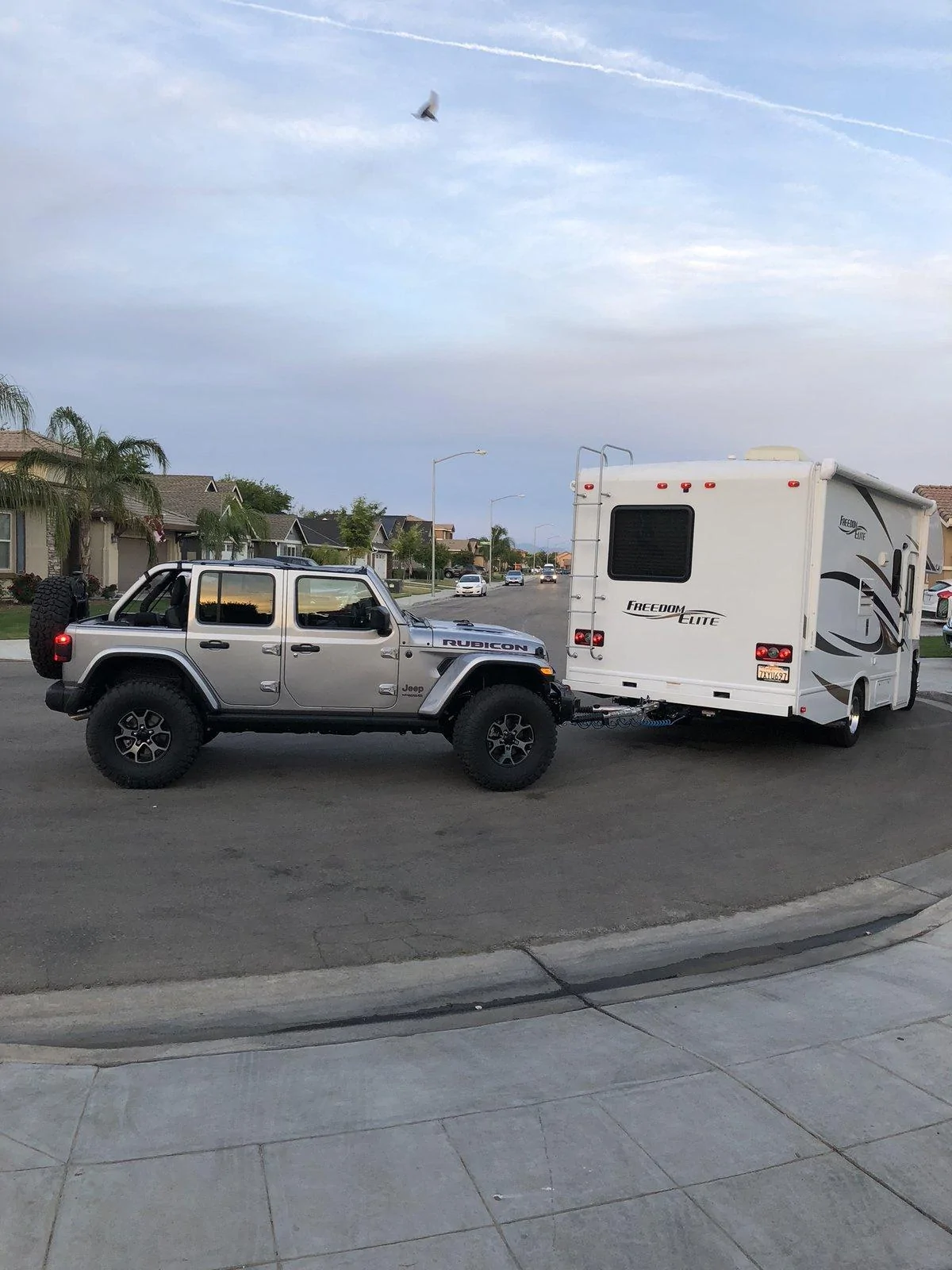

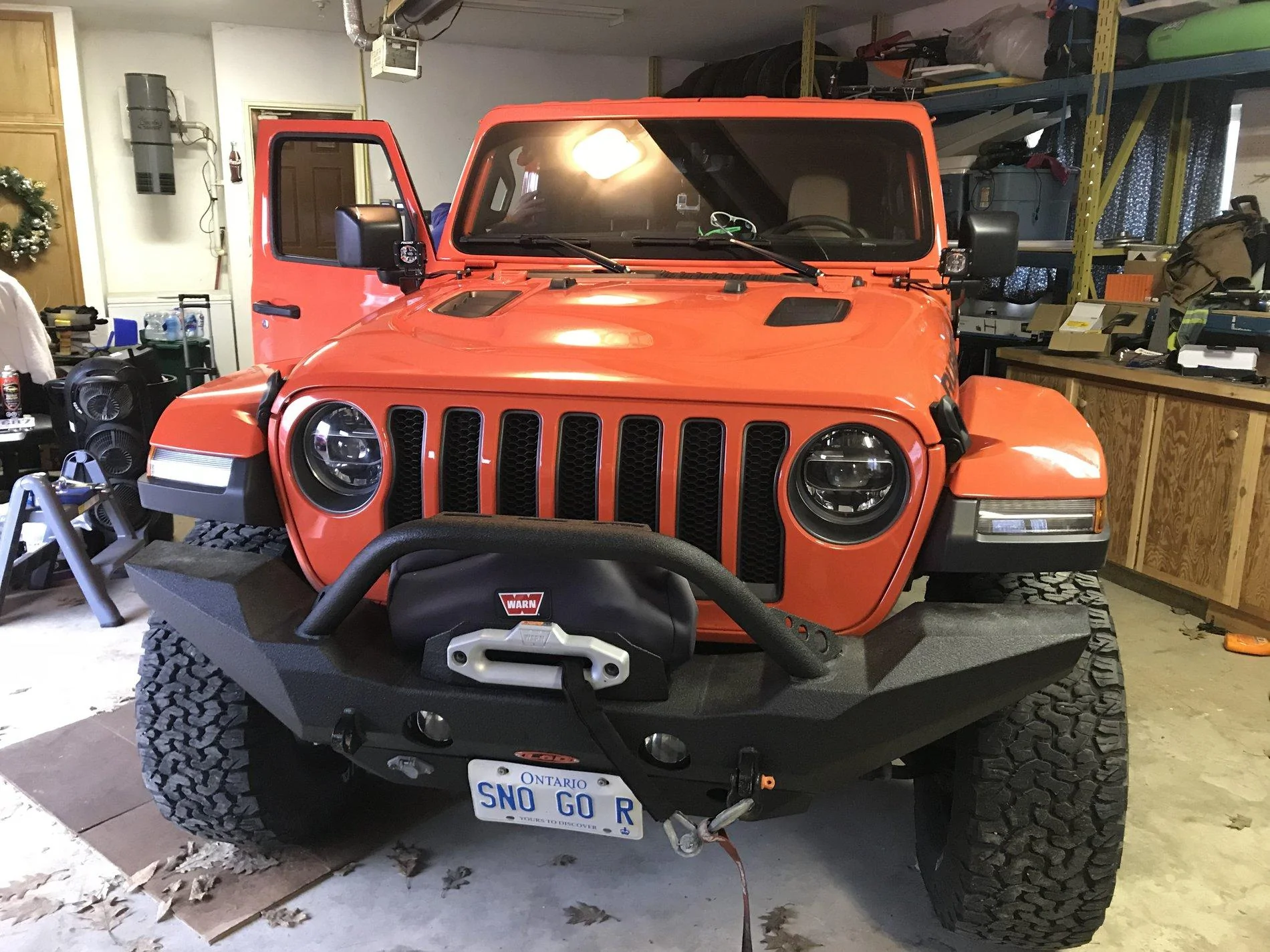

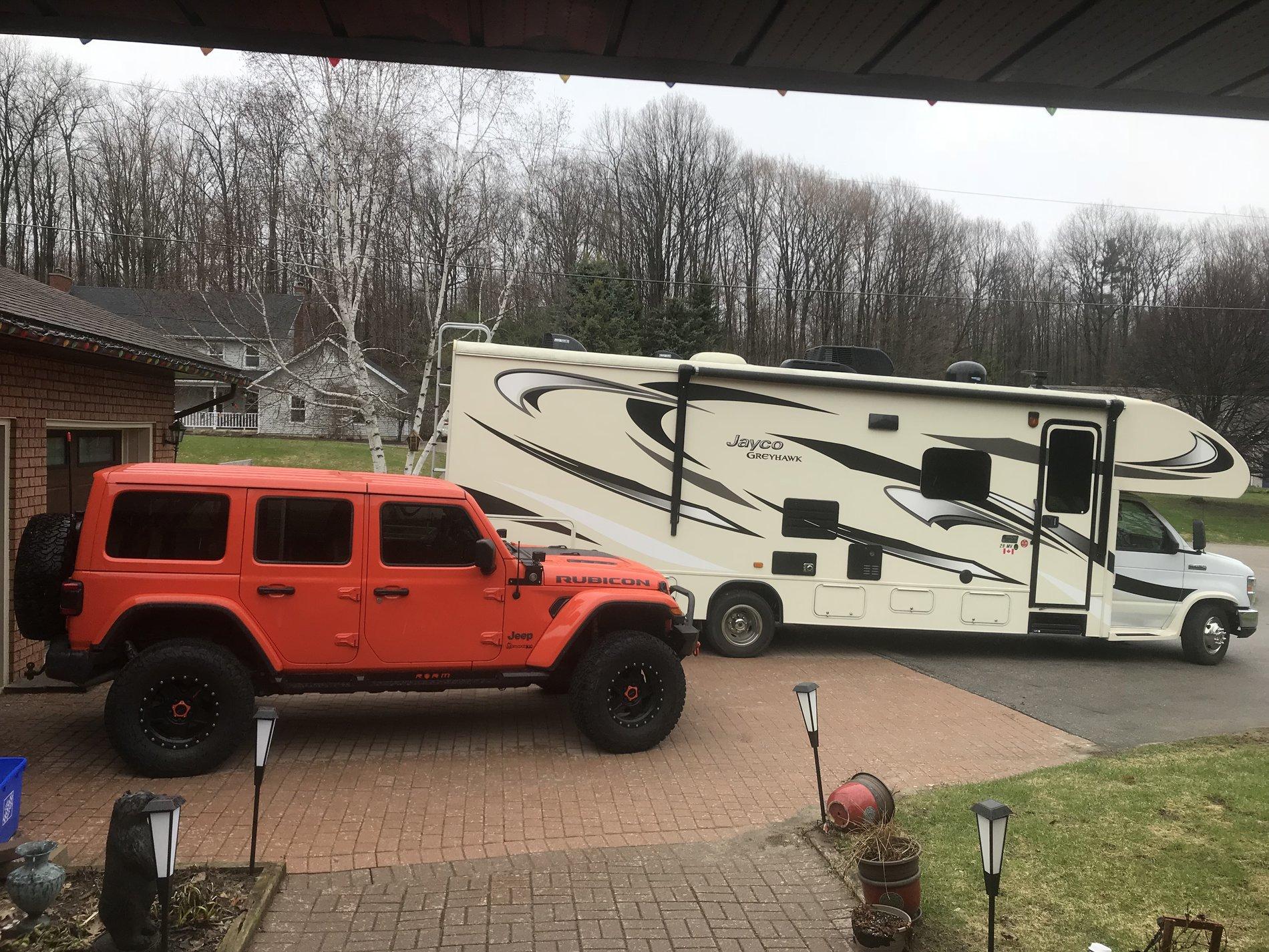

I will be flat towing for the first time in 2 weeks. I got the motorhome out of storage and will start getting ready this week. I will be using my LOD bumper with blue ox adapters. I also order LOD new Bracket safety just to be extra safe. I hope they arrive before my first trip.
Tow package
2016 Jayco 30ft class c Motorhome
2018 Jeep JLU Rubicon with mopar lift and 35 inch tires
LOD flat tow ready Bumper
Blue Ox 6000lbs tow bar.
Blue ox Patriot brake system
Cool tech light harness
