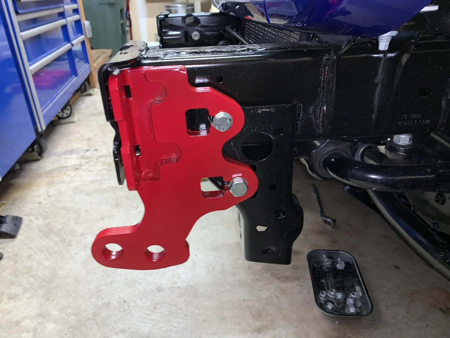

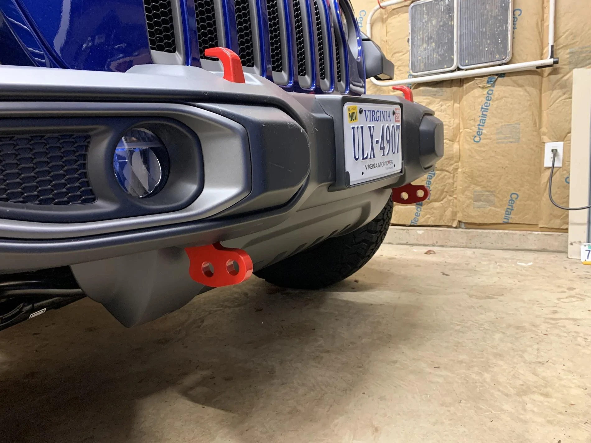

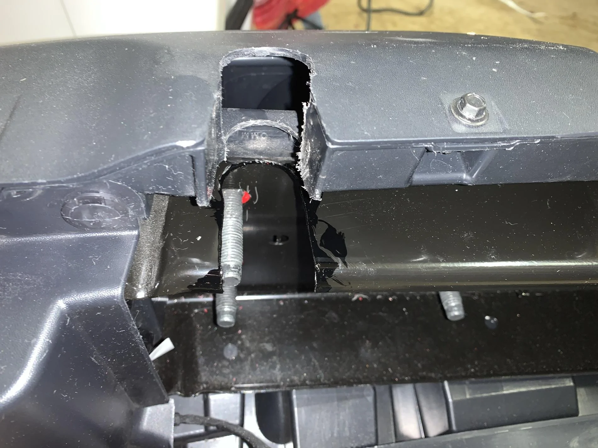

I've posted about this a few times now, but my quest to set up my Toad has been more complicated than originally planned. I settled on Maximus-3 tow loops based on recommendations here. Installation wasn't too bad, but it took longer than it should because the directions were for the metal bumper and my Rubicon came with the stock plastic bumper. Here are a few photos:
Jeep Wrangler JL Best Setup for RV Flat Tow 9aWvg1H
Jeep Wrangler JL Best Setup for RV Flat Tow lKOb5lw
Jeep Wrangler JL Best Setup for RV Flat Tow AmzzRy
Jeep Wrangler JL Best Setup for RV Flat Tow uIpjNOm
Jeep Wrangler JL Best Setup for RV Flat Tow iRUGWNE
After soliciting input and researching tow bars, I decided I wanted the Ready Brute Elite II from NSA. Before I installed the Maximus loops, I sent them to NSA so they could determine if they had clevises that would work. They advised they had clevises in stock which would work, so I bought their system.
Last Wednesday, my tow bar arrived. The clevises were 1/4" wider than the Maximus loops and took 1" pins vs the loops needing 7/8" pins. I wasn't comfortable with the loose tolerances, so I called to see if there were any other options available. They explained that making custom clevises was not a viable option as they make several pieces at a time and were afraid they'd be stuck with unsold inventory. I completely understood their position but needed to figure out what to do.
On Saturday, I ordered a Blue Ox Ascent tow bar and Blue Ox BX88303 clevises. Everything arrived yesterday and the clevises fit perfectly. I was given a Brake Buddy Classic by a friend, so I planned to use that for braking. I had resigned myself to the fact I needed to return my Ready Brute tow bar.

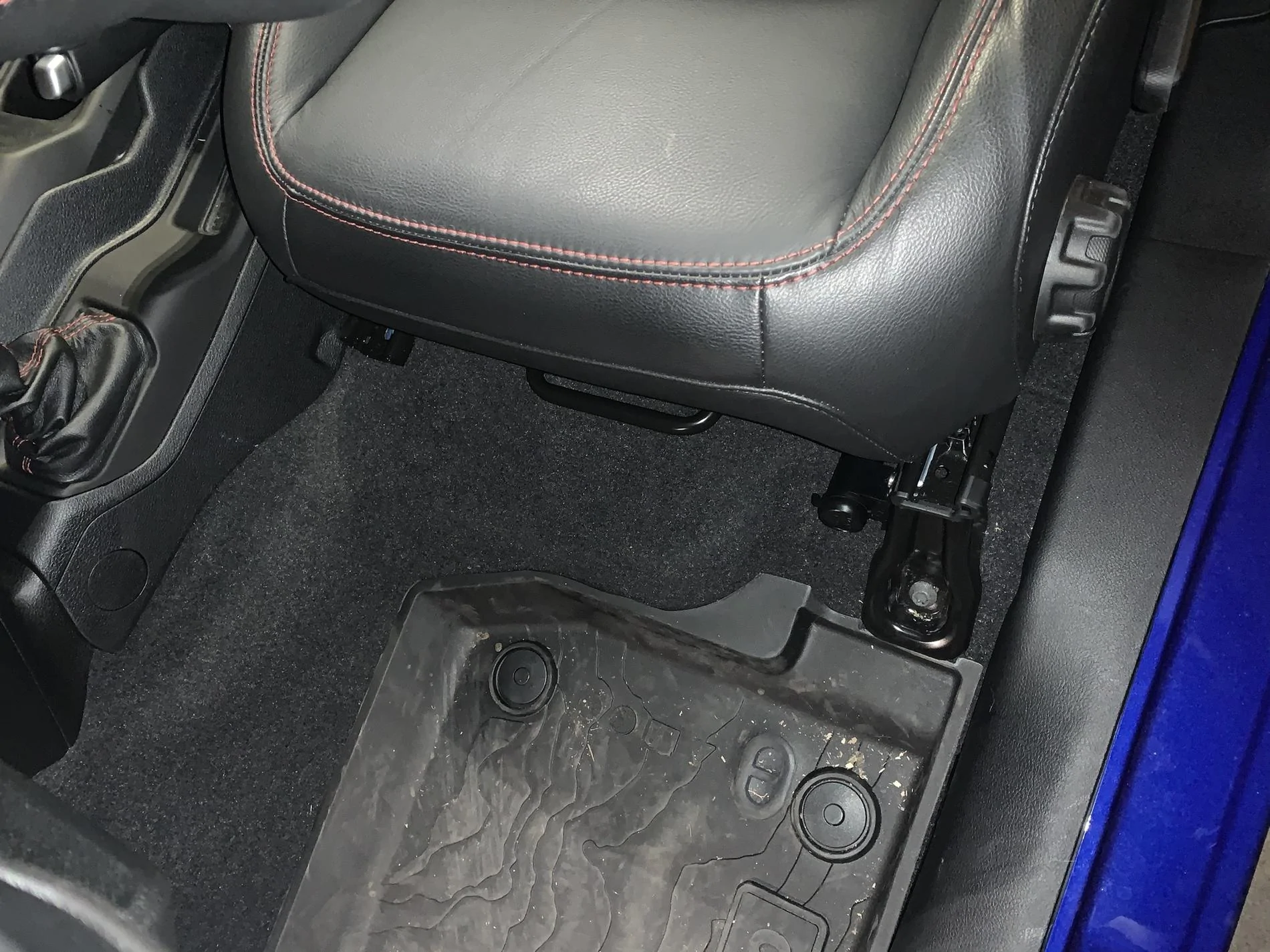

I needed a 12-volt outlet that was hot while the vehicle is turned off. I decided to wire one to the Aux. 3 switch on my dash and made it useable (via UConnect) while the vehicle is off. The install was super easy with the wiring supplied under the glovebox. I used the ground which is hidden under the plastic trim on the door sill of the back seat.
Jeep Wrangler JL Best Setup for RV Flat Tow i4nq8QB
Jeep Wrangler JL Best Setup for RV Flat Tow WLUfbPN
Jeep Wrangler JL Best Setup for RV Flat Tow TkeAgnD
Jeep Wrangler JL Best Setup for RV Flat Tow kjA6mqd
This morning, I received an email from NSA advising they have received enough inquiries about the tow loops that they are now willing to manufacture the correct clevises and can ship them to me next week.
To make a long story short, I am now in possession of two brand new tow bars and one needs to be returned. I can go with the Blue Ox / Brake Buddy combo or the Ready Brute Elite II. Anybody want to offer their advise on which direction you'd go if you were in the same shoes? I need to decide which direction to go and ship one of these tow bars back.
