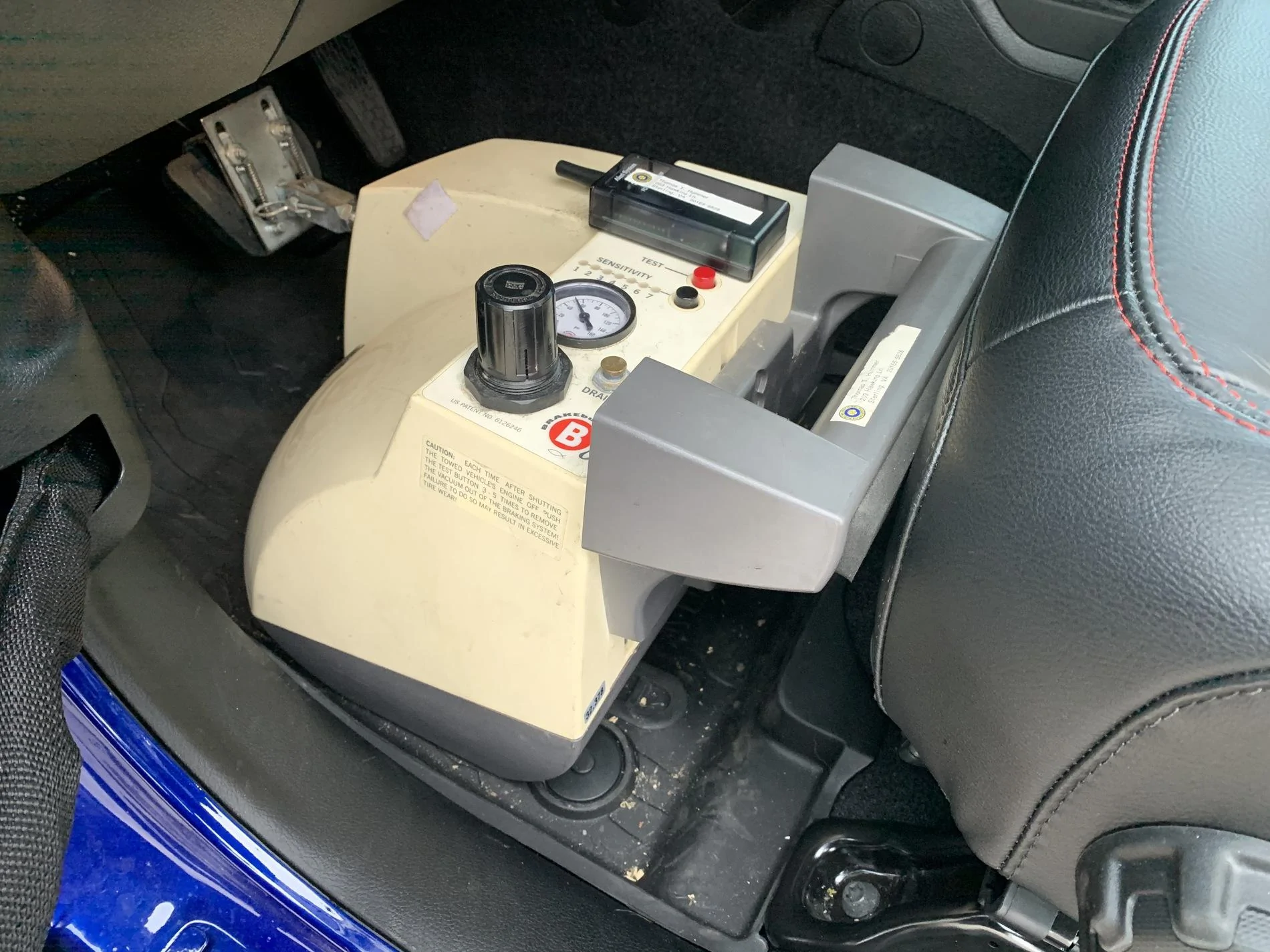

Thanks for all great info in helping me set up my JLUR for flat towing. I'm using a Brake Buddy and tried it out in the driveway today. The BB does not rest against the seat but up against a rise in the floor. When a do a test it moves all over the place and I'm afraid after driving longer distances it will no longer be in the correct position. Has anyone solved this problem?.
By the way, I'm having the local Jeep shop install Maximus tow loops for $150 as it more than I can do. I did install the Cooltech wiring harness myself after watching the how to video. I only had trouble finding one wire(involved two repairs) but it works as advertised. I think it would be much easier to install then running wires all the way to the back. Thanks
I think you're right to be concerned about the Brake Buddy moving around. You'll have to come up with some way to brace it or choose a different system. I don't know what you'll be towing it with, but our new JLUR will be the 4th "toad" I've used the SMI Air Force One system on, but it requies tying into the coaches air system. The same company also makes a poplar all electric version.
You might take an idea from RVi. They supply a short piece of angle steel that fits over the floormat studs. The brake unit has a bit of rubber bonded to the back corner and it stays in place well. The only thing I'd do differently is to use a taller piece than RVi supplies. Very simple to fabricate.
I am new to flat towing, but used a Brake Buddy Classic recently for a 1000 mile trip. I did not have any issues getting the system installed correctly. It does jump a bit when activated, but it never moved from position. I put it in place with the seat all the way back, then pushed the unit forward so the arm was compressed and adjusted the seat to where it just barely touched the unit.
