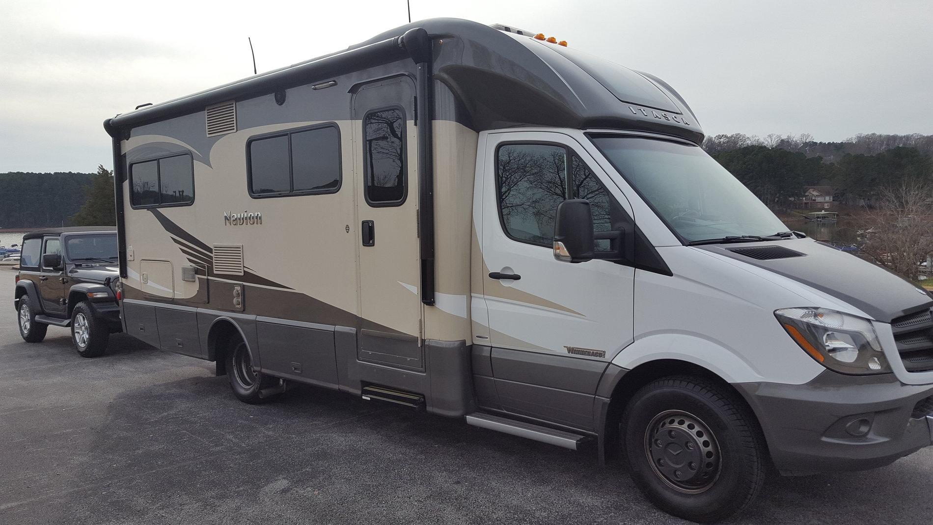

Certainly no problems with the RVi3 towing our 18JL Wrangler behind a Winnebago Class C Mercedes Benz TD Sprinter.
Our Mountains have been limited to the Smokies and Cumberlands thus far.
Thanks for the confirmation... Did you install a braking system....?

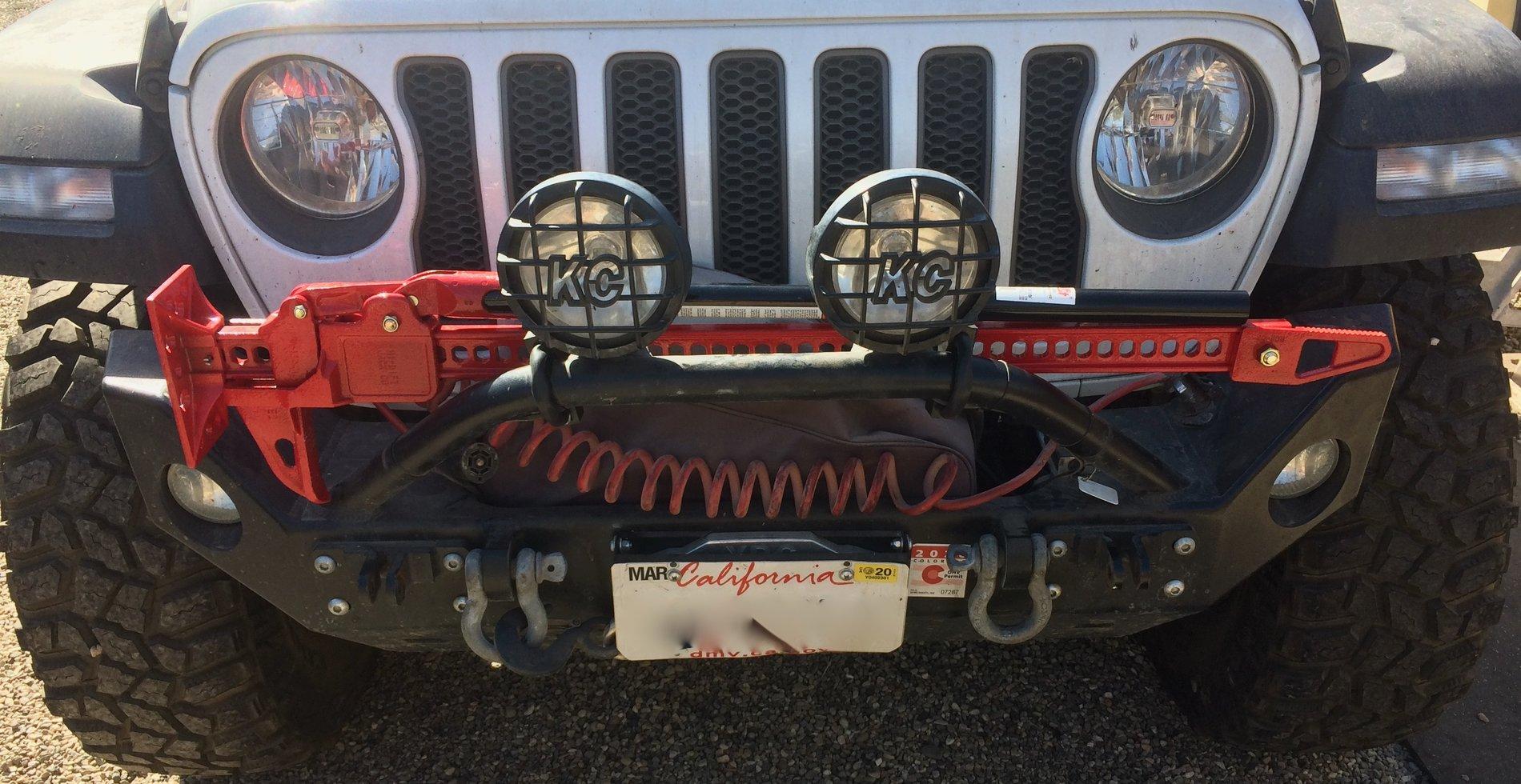

I have my bumper loaded with accessories
Jeep Wrangler JL Best Setup for RV Flat Tow Hi-Lift Jack mounted
RVi3 Braking System. When I purchase the JL no one had any experience with the Stay N Play and it was beyond what I wanted to take on. It's also transportable.
We tow about 50% of the time and so far the RVi has worked well. The dash mounted tablet displays how much braking force is being applied so it's definitely not an all or nothing, indeed there is proportionality going on. The test feature allows testing of the system up to 30 MPH by pushing the test button on the tablet which fully activates the brakes which provides a level of certainty things are working properly.
The tablet has to be plugged in all the time as the battery life is limited, a downside, but not a big deal as the brake system is not dependent on the tablet or transmitter. No, It is not a flip of the switch, but now that I have become proficient it's up and running in under 3 minutes. Very small box so it's easy to store.

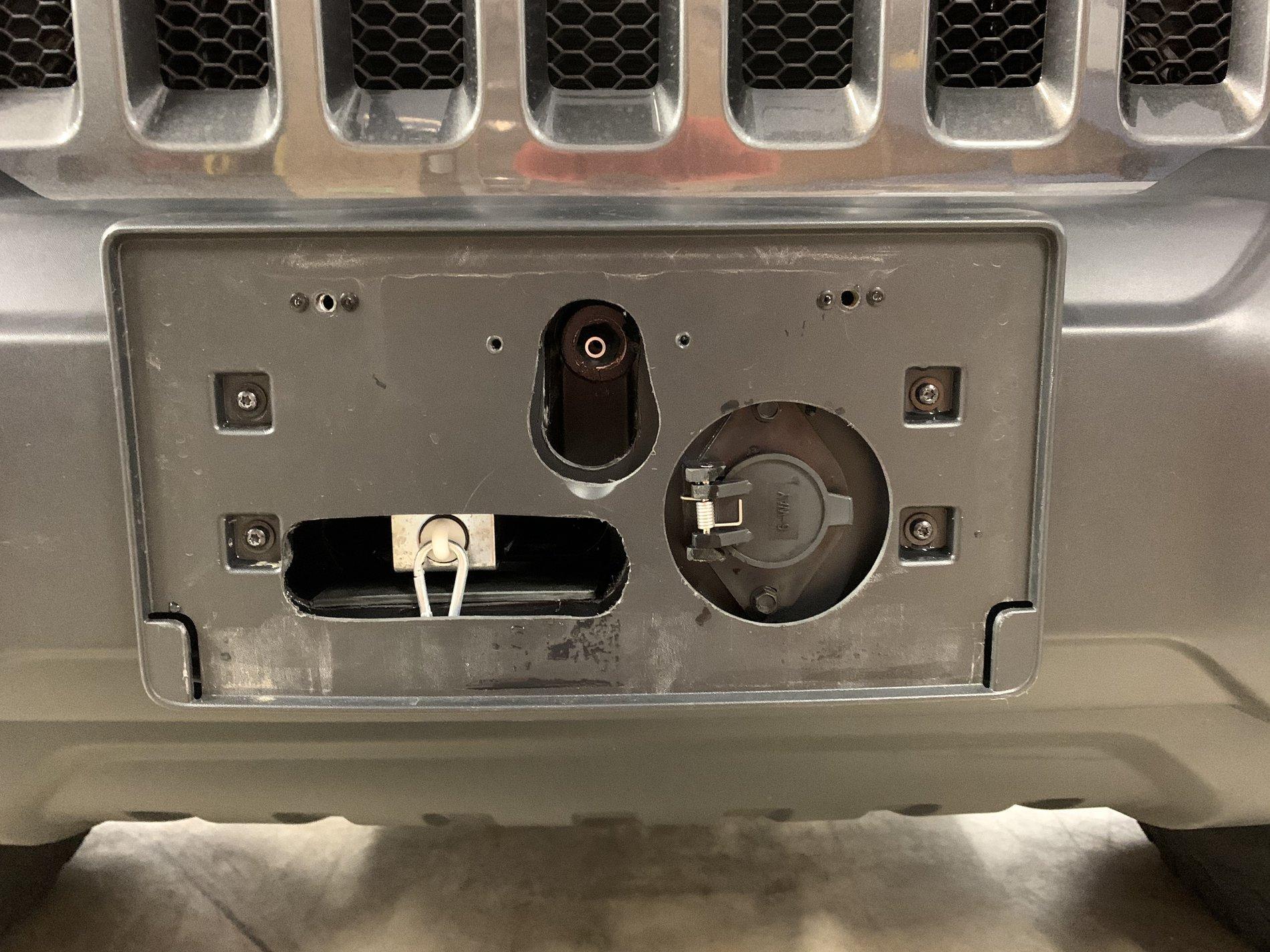

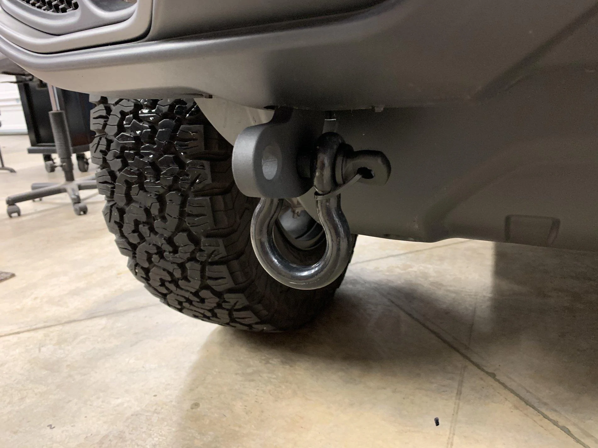

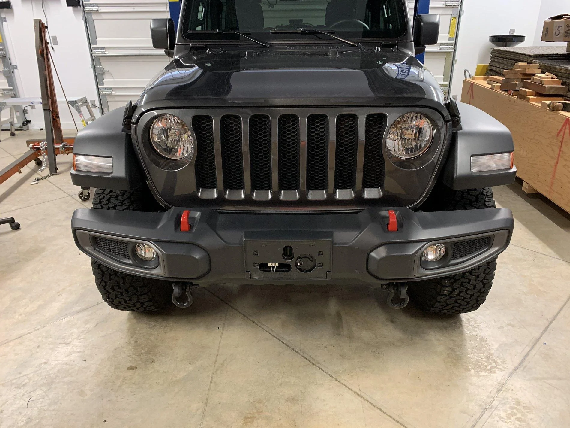

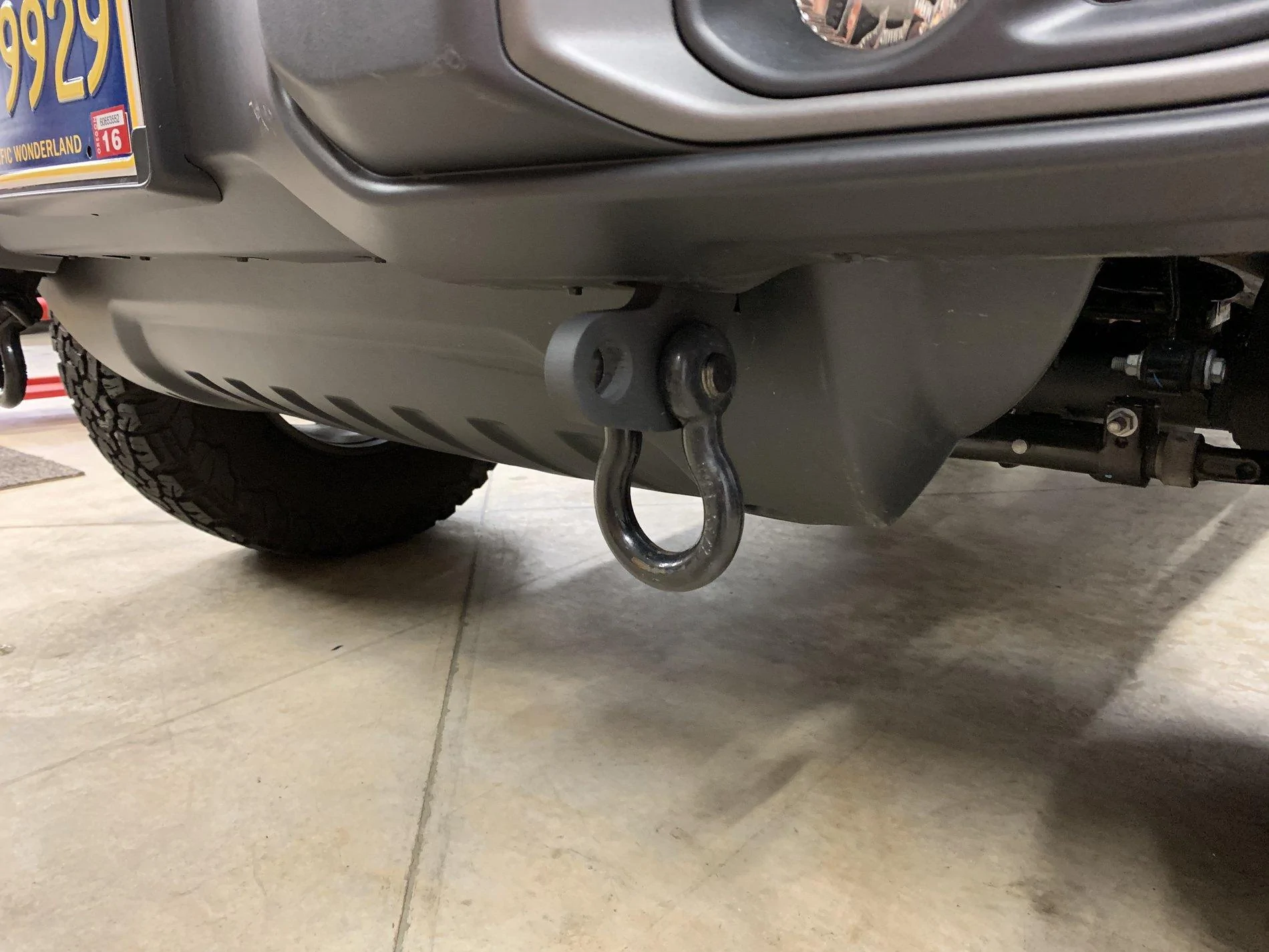

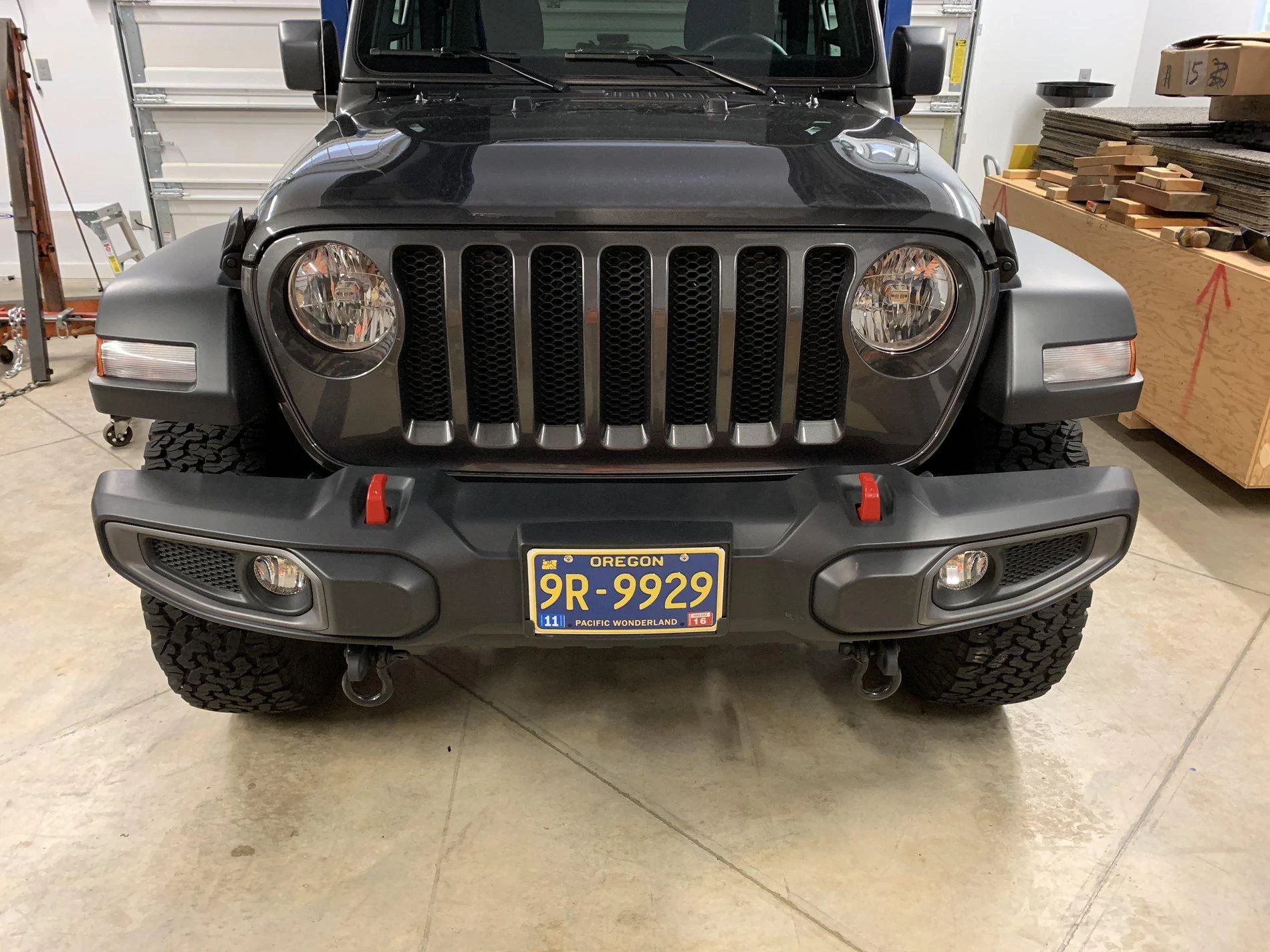

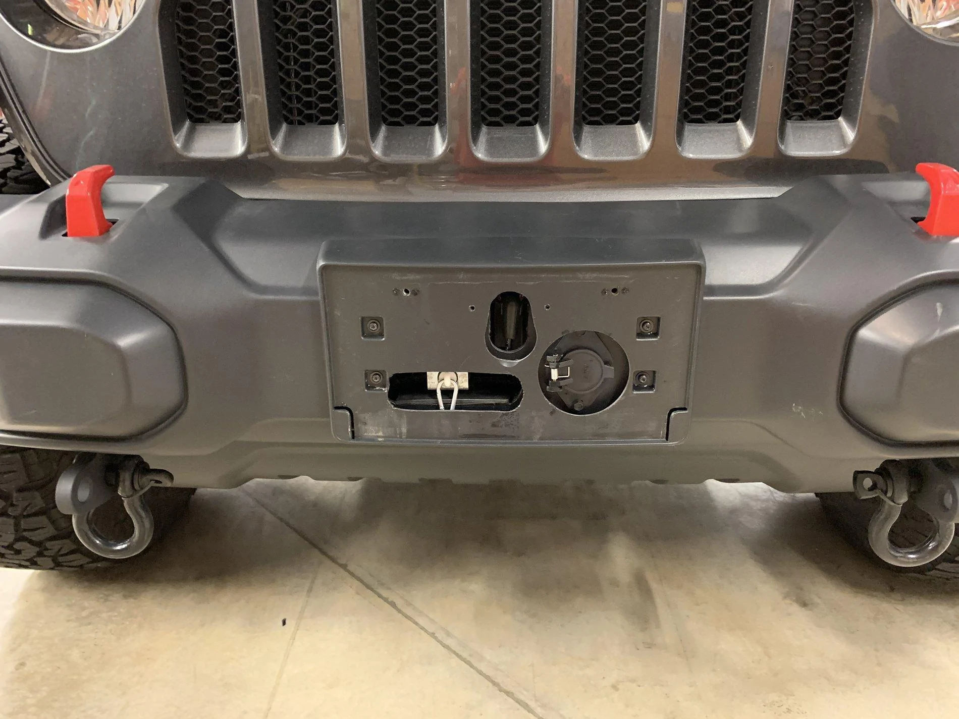

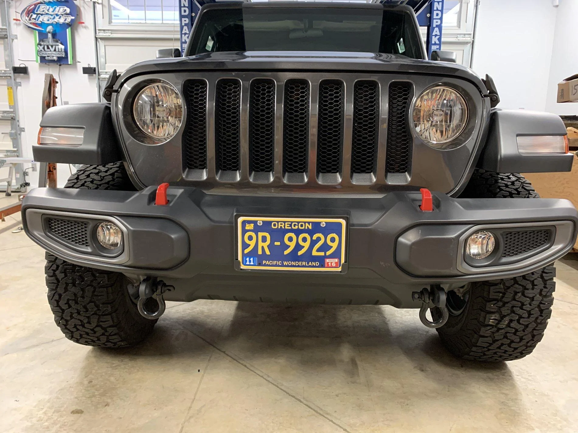

I just finished setting up my 2019 Jeep JL to be towed behind a diesel pusher. I used the Maximus -3 Tow Loops, M & G 2.0 brake air system with break away. I wanted to conceal everything possible and this is what I came up with.

That is amazing, great job.

Looks good. I like the stealth behind the license plate mounting. Similar to what I did but we don't need a front plate.

Silly question, do you take off the license for towing and then re install for driving? Also after reading this forum it seemed like you needed a different bumper if you were going to tow off the tow loops, looking for education please
The Maximus-3 tow loops are rated to tow from, you are not connecting to the stock bumper. The Maximus-3 tow loops are connected to the frame. And yes the license plate is removed to tow.

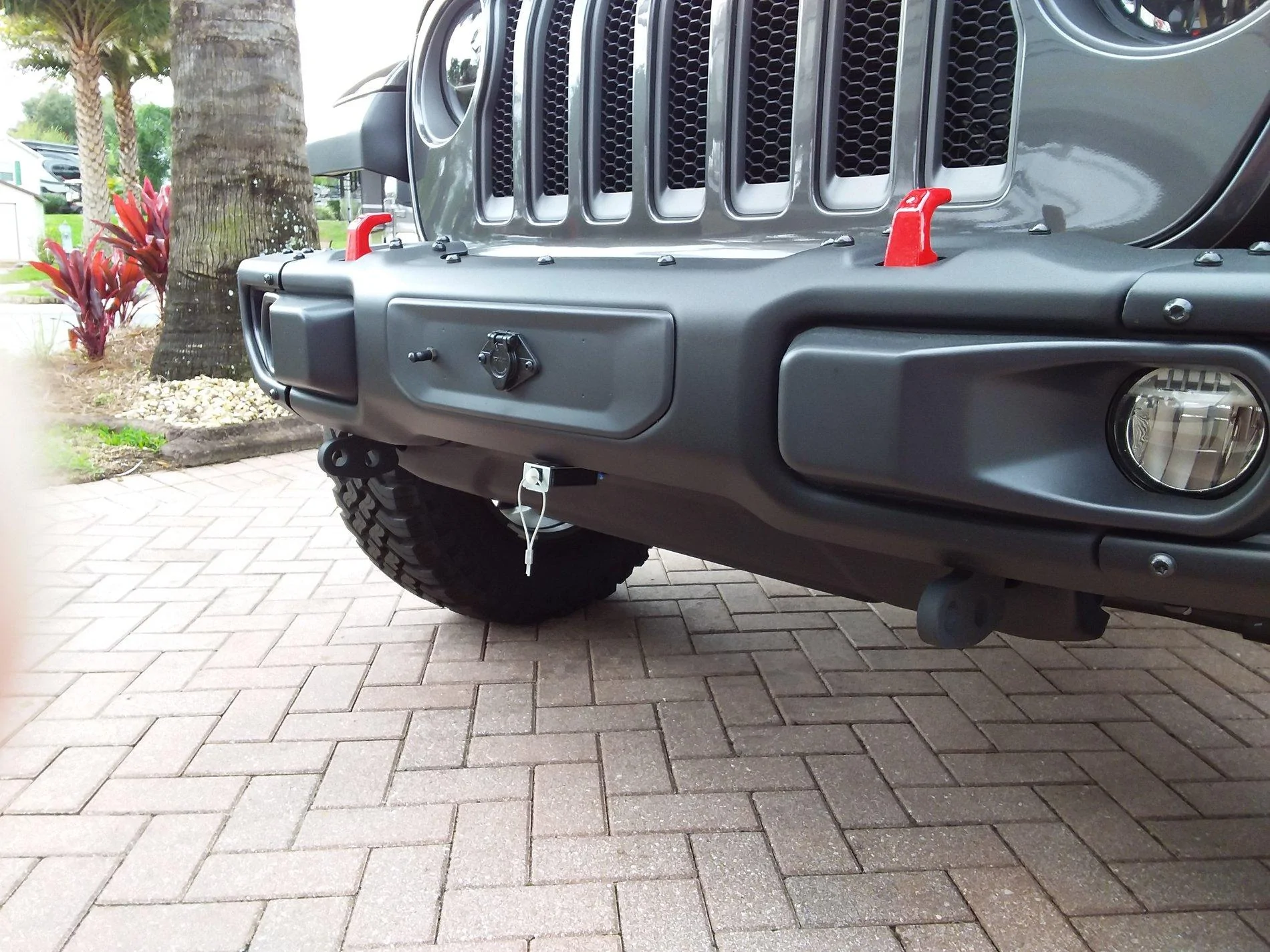

Just finished the maximum 3 tow loops install about three hours from start to finish.
I was teetering between the rock hard aluminum bumper and the Maximus 3, the Rockhard stubby bumper the way I want it set up with run me about $1,000, the only part that was holding back was winch placement, I don't like all that cool that being blocked on hot NM day.
Maximus 3 setup on the stock steel Rubi bumper allows for the winch to be recessed inside and provides a clear the air channel for the radiator. JMO
This is a straightforward install are they going to have to do ia use a c-clamp to hold the brackets in place when you put the spacer washer between the bumper bracket and the new maximus-3 to loop bracket.
