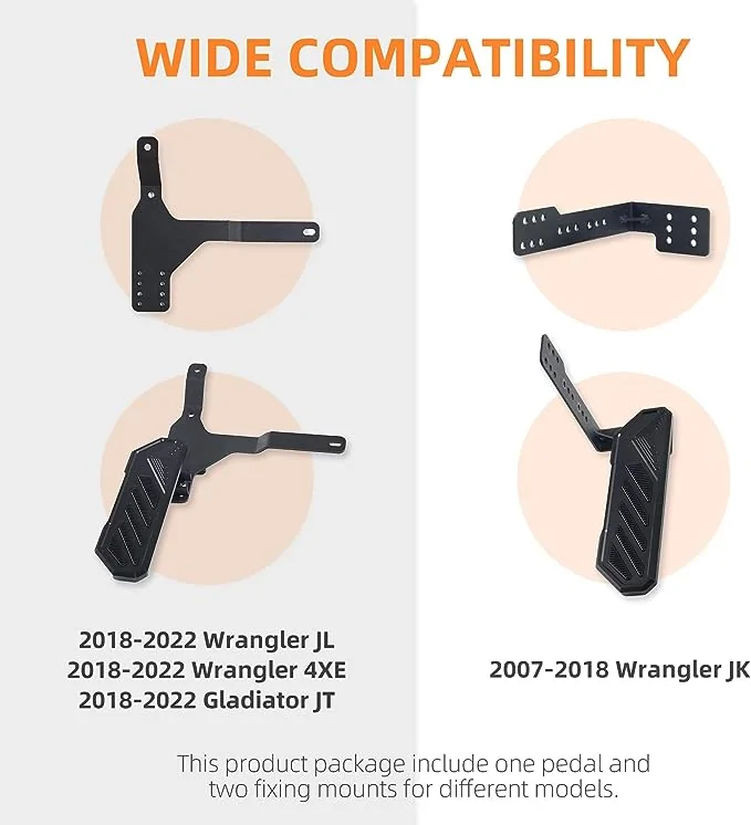

@813 Fabrication & Design The 4xe doesn’t use the same firewall bolts as the JL / JT unfortunately…. The mounting bracket would need to be modified as the top center hole is about 2” higher than the normal JL and appears that there is another they tap into about 5“ to the right. No one with US fabrication has solved this for the 4xe…only viable options are Chinese made….sadly.
’thanks for taking a look at it.

You will need to find one that mounts from the side, I believe the MOOR pedal may work. The 4xe does not have the bolt coming through the firewall used on a design like ours.
