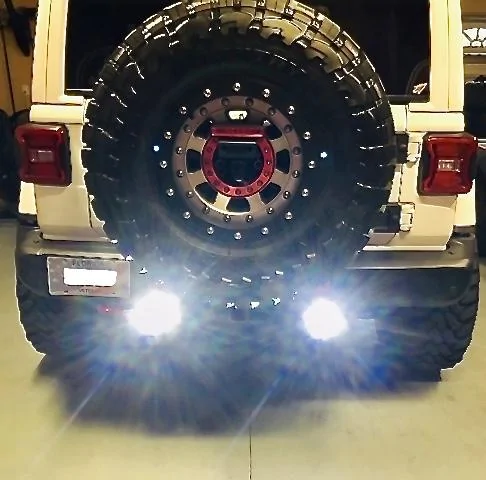

Got around to putting the Rigid lights in today!
Not a bad project and improved lighting. Did the reverse light and aux 4 option.

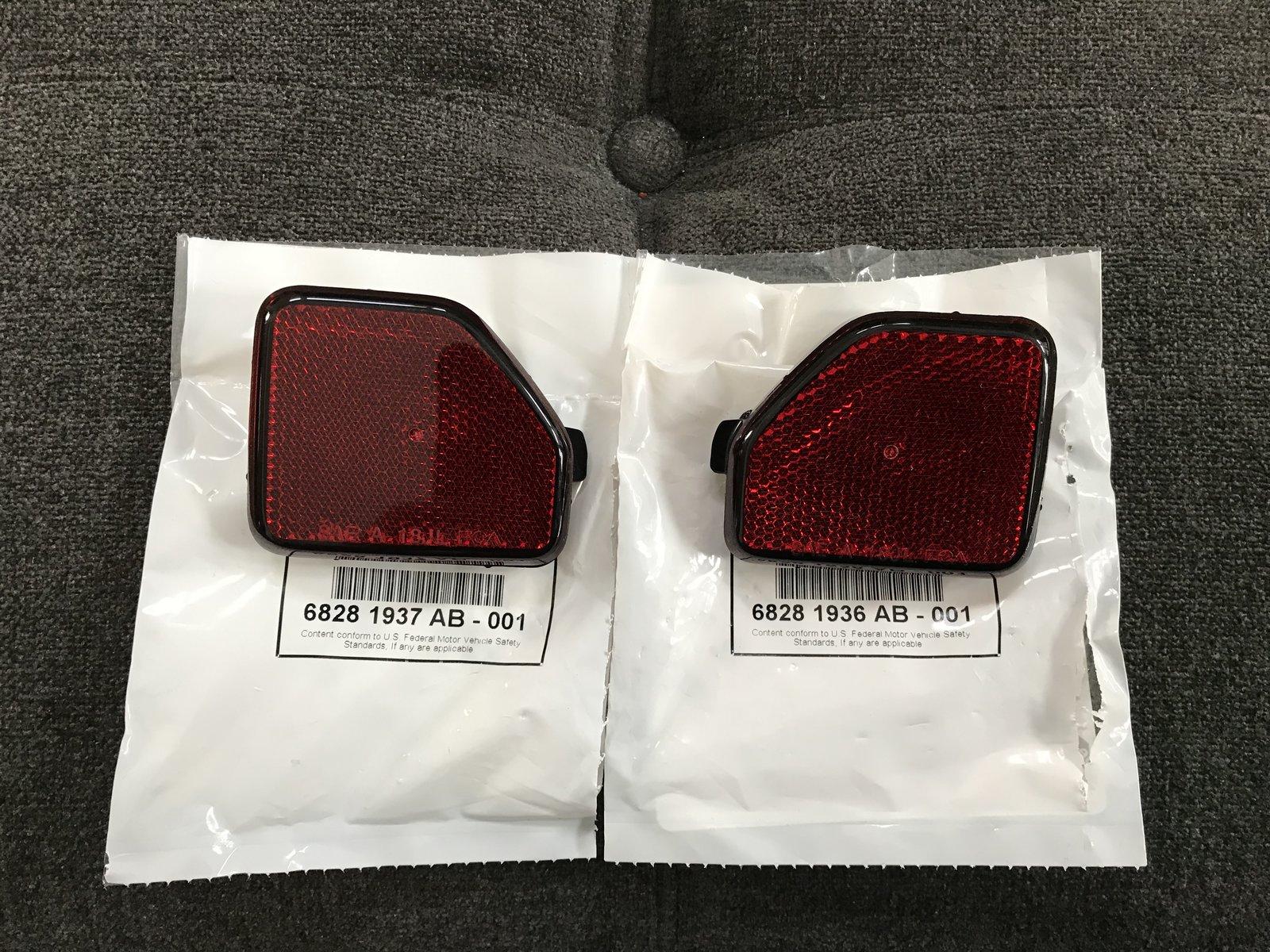

No updates yet, still deciding on direction. Have a few options I am looking at:
  • Drill out center to install the rigid backup lights and be flush, the issue is there is a mounting tab that needs to be cut to have the light centered
  • Drill out the back of the light and leave the red reflector, mount rigid backup lights behind the reflector
  • 3D scan the reflector, then 3D print a replacement with mounting for the rigid backup lights.
Also deciding on one or two lights, the issue I am having is that I see that all photos so far have hot spots/ glare. I am looking for something that does not produce glare.

I like the 1 and 2 idea because it’s something I’m thinking of doing when we get ours in from factory. 3 sounds awesome and maybe you could sell them!
How bright is it if it just sits behind the reflector?

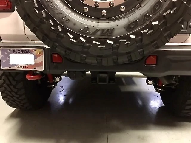

@OMTBiker I'm not seeing "hot spots/glare" with my Rigids, installed on the underside of the rear bumper.
@Jeeper 's install is slick as baby chitt, but for me, and towing trailers a lot, it would not be a way to go..
My trailer tongue would block that single aux light, when I needed it most.
When I am loading my Harley at night.... and when I want to turn on while driving, to illuminate the towed trailer/bike, so the rear camera can give me a view and let me know all is well with my tie down straps, etc.. I need rear lighting that is not blocked by the trailer tongue. Again, @Jeeper your install is real nice............. would not work for me though.
I run around a 10" drop hitch on the back of my JL. That too, would block that light completely. Most guys will be like me... dropped hitch cause of Wrangler's height.
