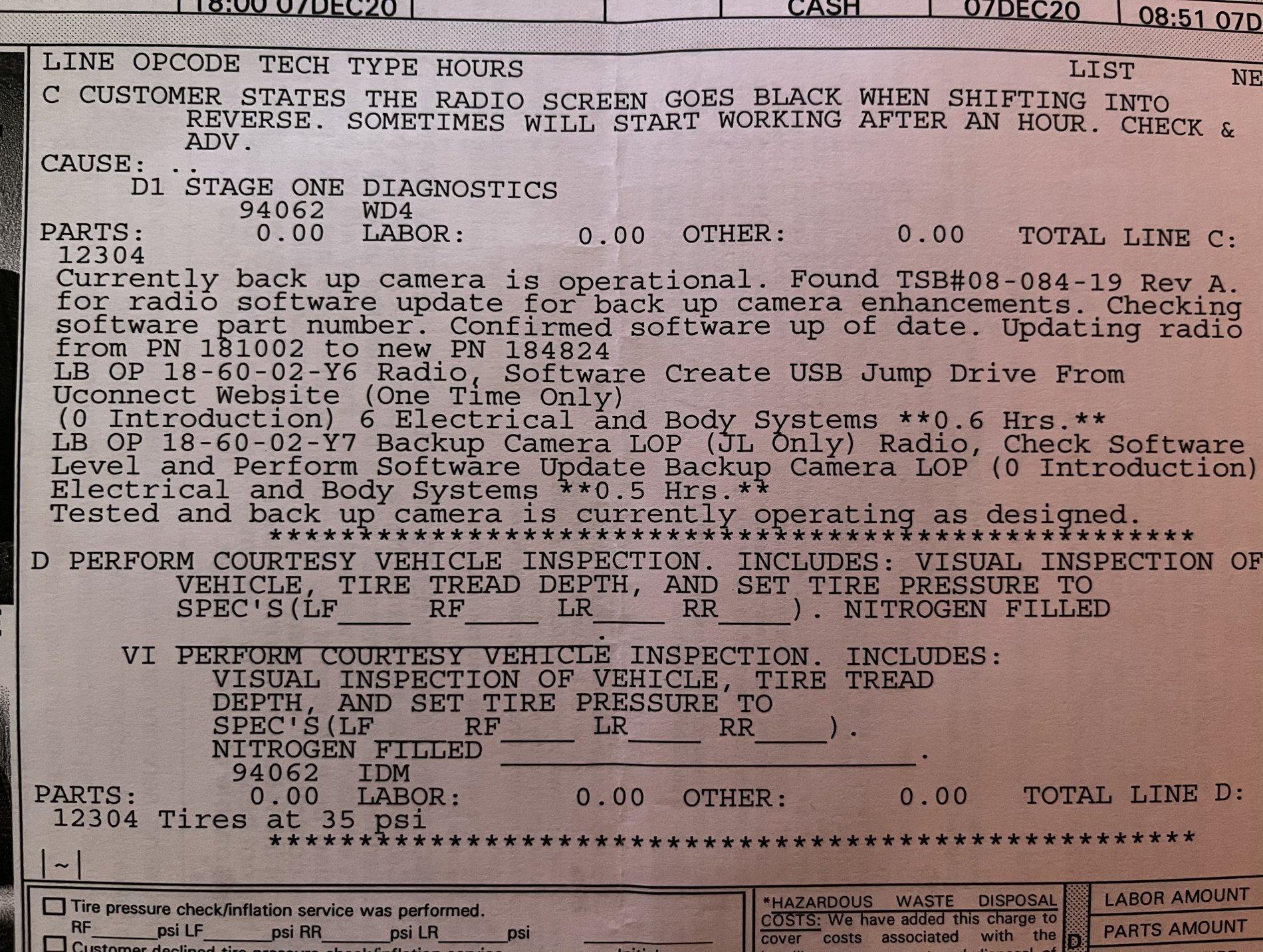

My screen was going black when I put mine into reverse. Not always but ocasionally. They replaced it once. Still does it occasionally. The screen also goes black intermittently while driving forward. Two radios and one back up camera later, still having same problem. 2018 Sahara JL
step1107
Nov 29, 2020
NorCal
2018 Wrangler JL 2 Door Sport
My new (to me) 2018 JL did that from the start. I took it into dealer and they did a software update. I wasn't opptomistic but it hasn't blacked out since over the last few weeks.

I might have to try that. But supposedly it auto updates over the air already, so maybe that air update isn't working?
