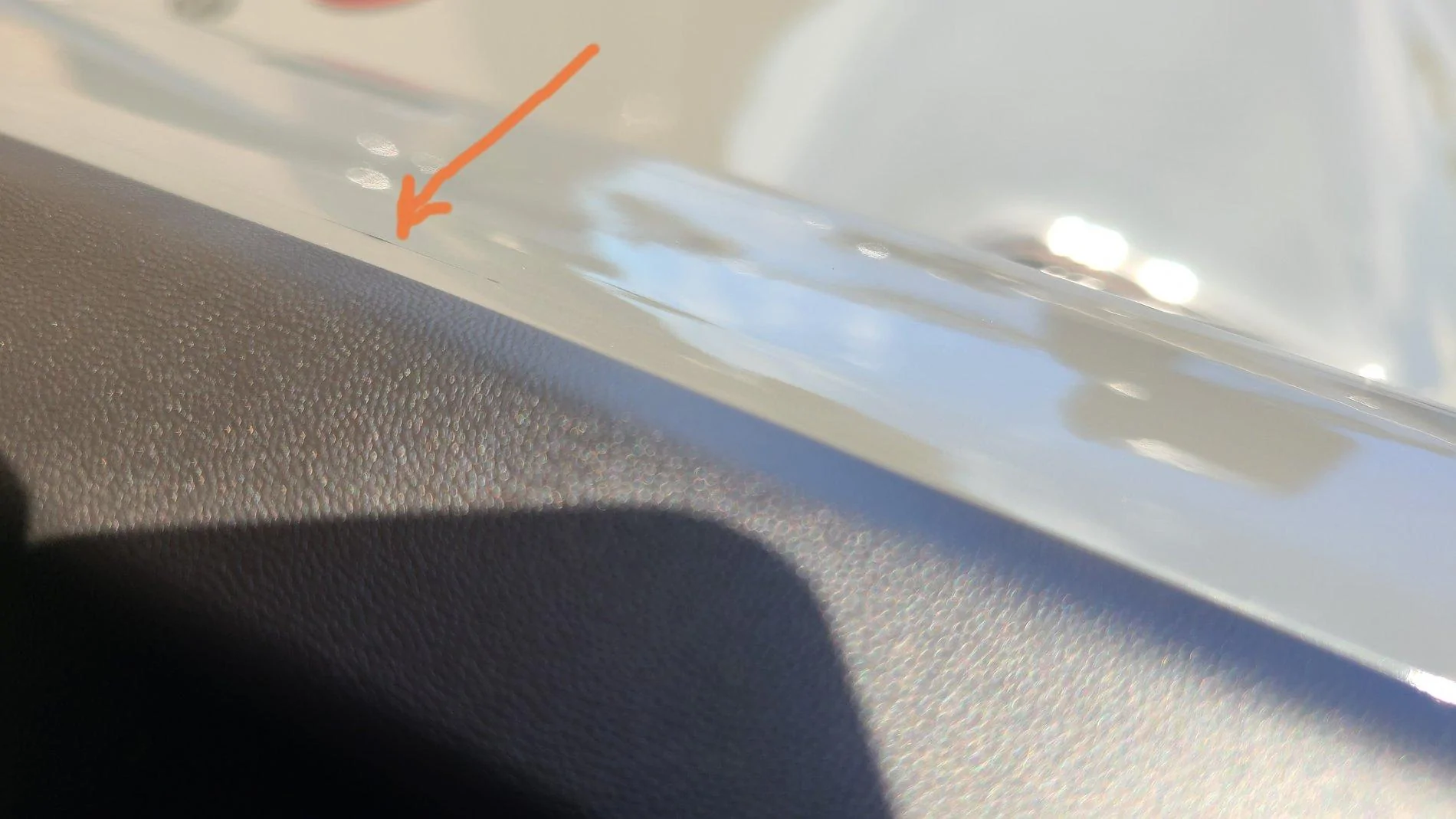

Allison,
I do plan on taking this to a dealership for the concern, as it has now happened twice (in 400 miles).
Additionally, there's another "concern".
It's off-topic, but now that you've asked about opening a case, I'd like to get both of these resolved as soon as possible.
Item number two is this:
While washing the Jeep today, I noticed a hairline "slit" along the right front fender flair (along the flare's bodyline), which looks like a place where the flare was taped off for painting.
The "slit" is a two-inch long void in the paint, revealing the flare's black plastic.
Now, after seeing it, I see it every time I look at the right side of the Jeep.
Undoubtedly something that slipped by quality control. (zoom in on photo, and you'll clearly see the defect).
COVID strikes again...
Let me know your thoughts.

Allison,
Kindly,
We're sorry to hear that you are also experiencing this concern. When you do have the opportunity to visit the dealer, please feel free to loop us in! If additional assistance is needed throughout your dealer visit, send us a PM. We'd be happy to connect you with a Case Specialist to assist.
