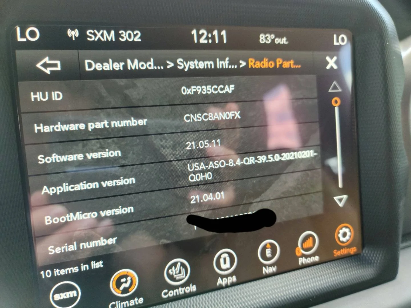

My advise is contact @JeepCares and ASK for the update. Send them your issue, your vin, and pic of your JL Uconnect software version. ASK for the over the air update.

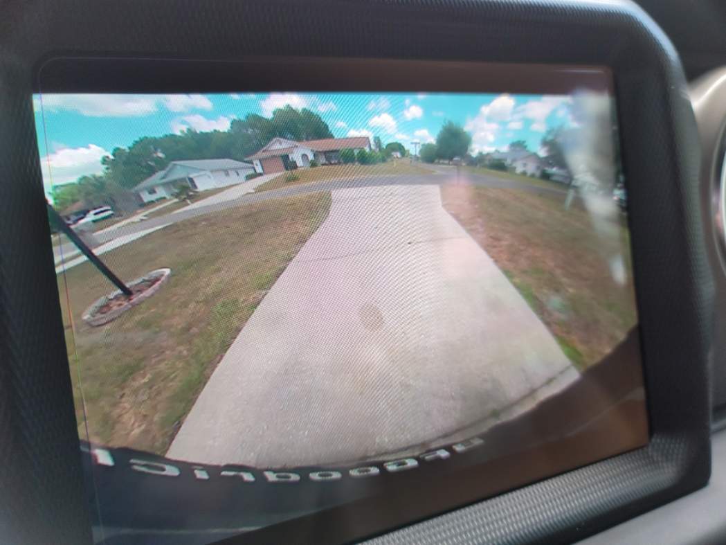

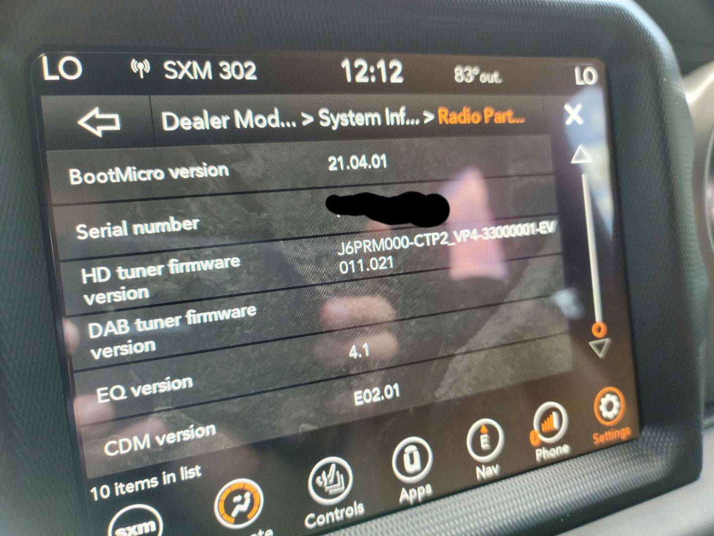

So frustrated. Got my new radio installed. Backed up no lines. How is it's they know there's a working update and yet they send an old radio with no update?!?! @JeepCares please message me
Jeep Wrangler JL Backup Camera issue Resized_20210531_121212(1)(1)
Jeep Wrangler JL Backup Camera issue Resized_20210531_121158(1)(1)
Jeep Wrangler JL Backup Camera issue Resized_20210531_121222(1)(1)
