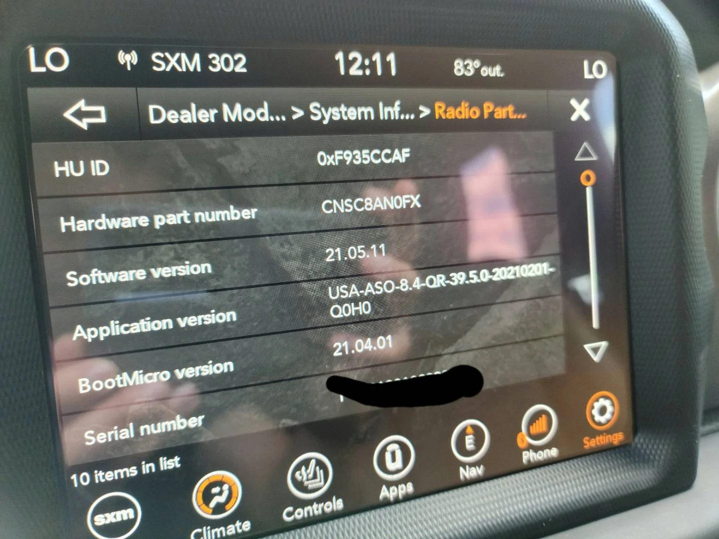

Having lots of discussions with U-Connect, they go by the APPLICATION VERSION not the software version. So the 39.6 would he the middle numbers of the APPLICATION VERSION. Looks like mine is one off. ? Waiting

App version. I previously posted the software version as 21.18.14

Good tip @JimmyZ My application version is 39.3 then. Nothing like keeping it simple, right?

I received the FOTA nearly 2 weeks ago (I think I was one of the first to get it on the 18th or 19th). My updated versions are now as follows:
Software version: 21.18.14
BootMicro version: 21.13.01
Application version: USA-ASO-8.4-QR-39.62.0-20210504-QFRM
My Android Auto seems to be more stable of a connection, and the backup lines have not disappeared at all. It also appears I no longer have to unlock my phone to get AA to connect, so that's a nice update too. All in all, good update, fixed my backup camera issues, and the UConnect OS seems to be running a little snappier. #thumbsup
