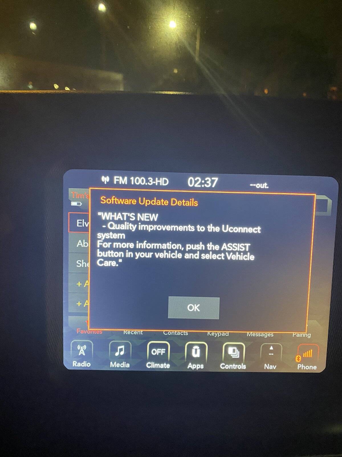

Good evening to all,
A few days ago I started speaking with Courtney @ Jeep cares.
I had received the first over the air update to the UCONNECT System, earlier this year.and I had multiple problems with the software as seen in the videos I posted..
I wanted to update you of the progress since the second Over the air download was completed yesterday for my Uconnect system.
Fingers crossed, the system now seems to be operating 100% better then before this second update.
all of the problems in the videos Seem to be resolved, only time will tell for certain, I do drive a considerable amount and all systems seem to be working and they should be..
I will keep everyone posted but I do feel like my conversation with Courtney @ Jeep cares definitely had an impact on the software being pushed out over the air in my jeep.
.I am very appreciative as this is the first time in over a year that I’ve been able to listen to the radio, back up with the camera, or simply listen to XM without intermittent interruptions from the sound going in and out.
Again I will keep y’all posted, however this second update seems to have performed miracles on my Uconnect system.

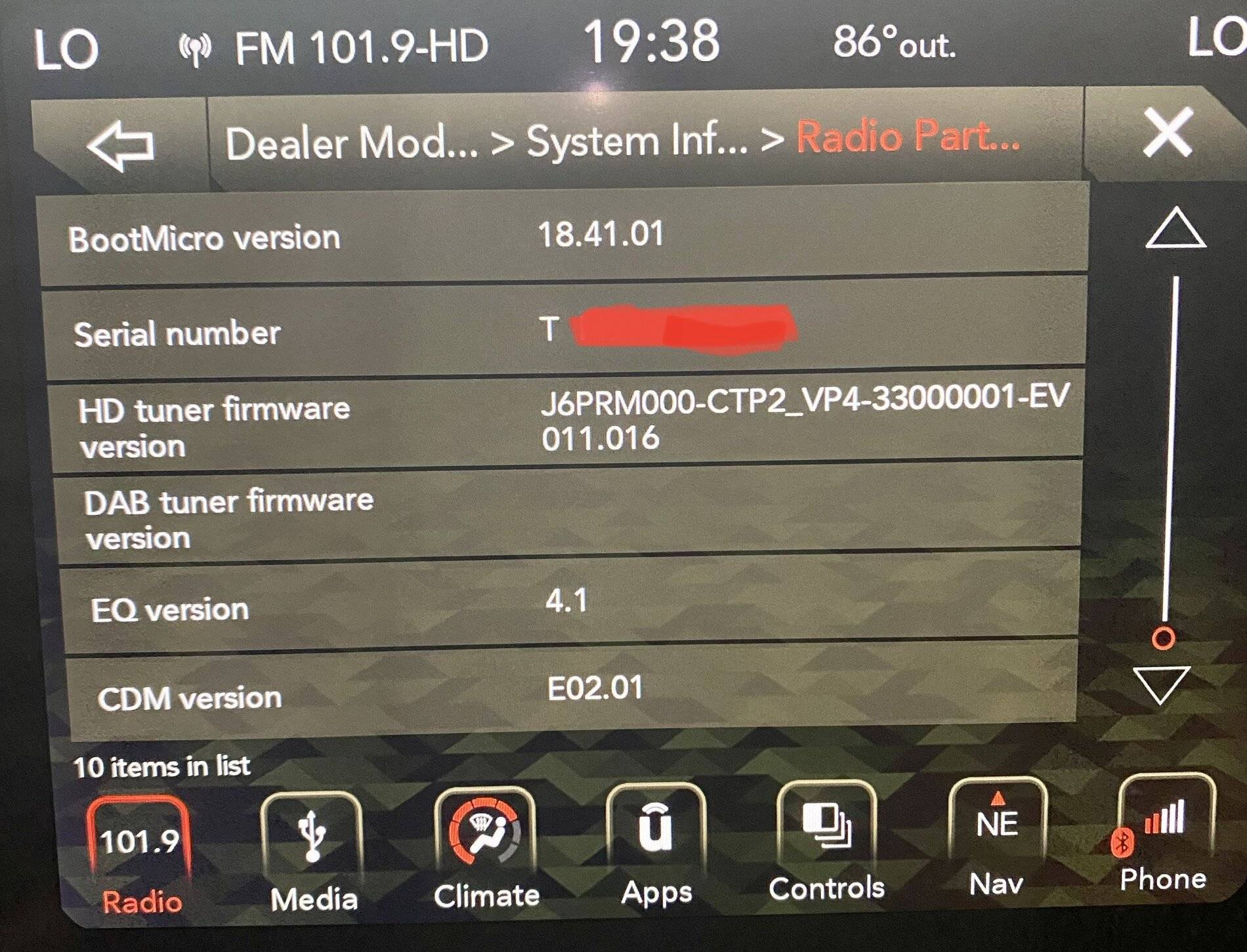

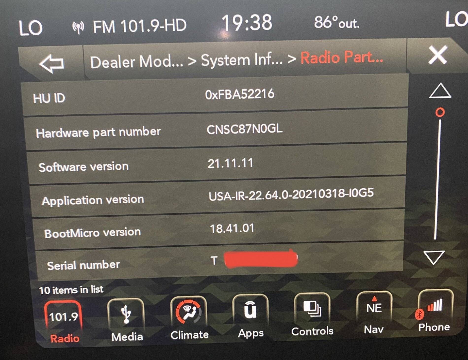

That's awesome! Do you mind sharing what the version number of your UConnect software is?

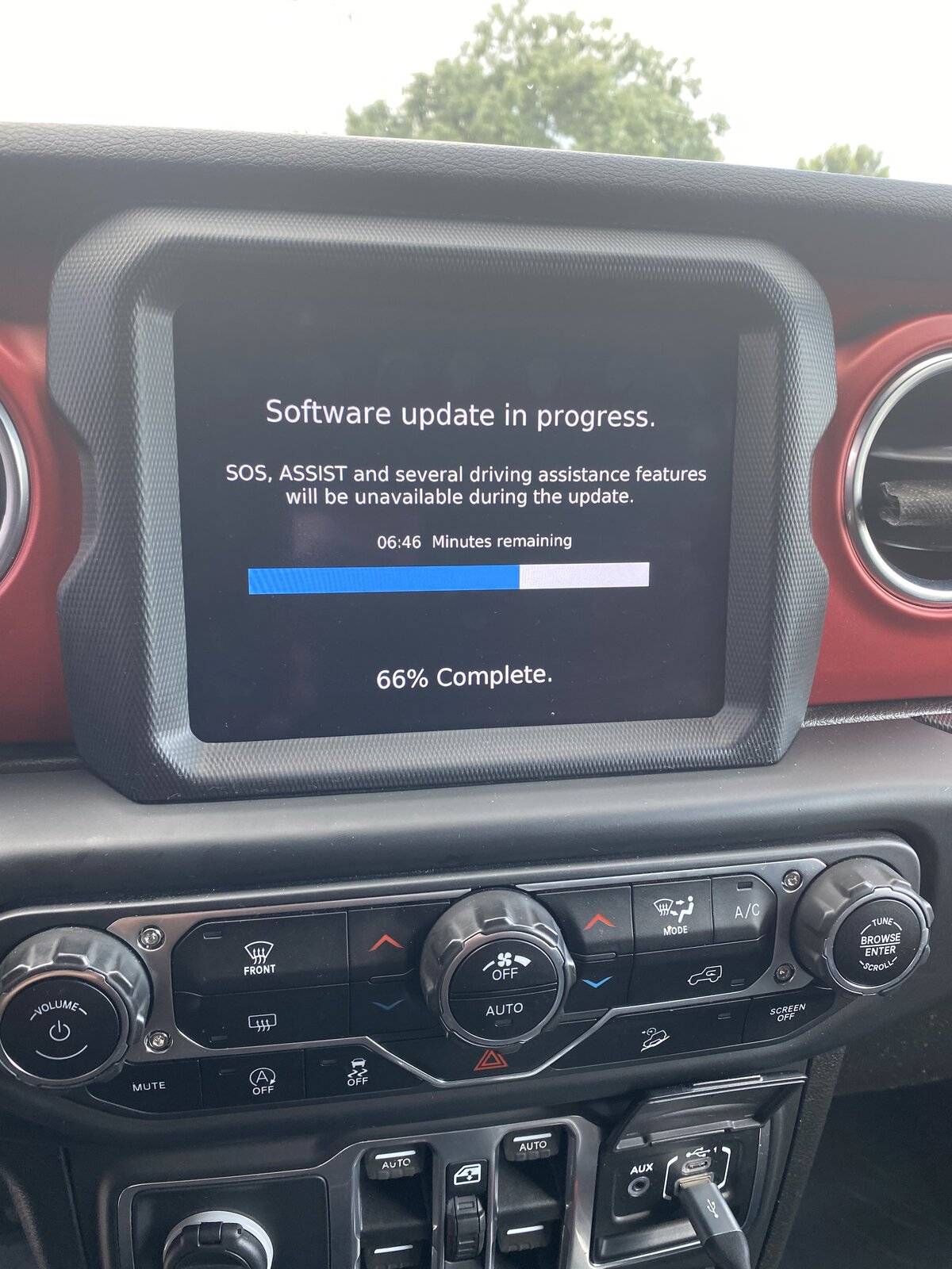

Yes sir, I do believe so, for me its been a long three years. I resorted to listening to music from my iPhone 11 pro with the ear buds for the last year.
I don't really understand why FCA / Uconnect has not fixed this problem sooner, however after three years of dealer service visits, hours of frustration on the phone with Uconnect support and their representatives... I received the first over the air update which made everything worse..... I really didn't think things could get worse, but Uconnect totally failed.
FCA Uconnect was no help, they simply ignored my emails and calls.
My last resort was posting the five video's on my post here in the forums and @JeepCares responded asking for my vin number. I again explained my problems to @JeepCares and the next day I received a noticed from them that I should be on the lookout for for an over the air download.
I was driving for about 30 minutes and when I turned the vehicle off, a notice flashed on the Uconnect screen that I had an over the air download. I selected install and when I returned from lunch the download installed. This is the SECOND over the air update,, I noticed an immediate difference.
All systems were operating correctly.....

My advise is contact @JeepCares and ASK for the update. Send them your issue, your vin, and pic of your JL Uconnect software version. ASK for the over the air update.
