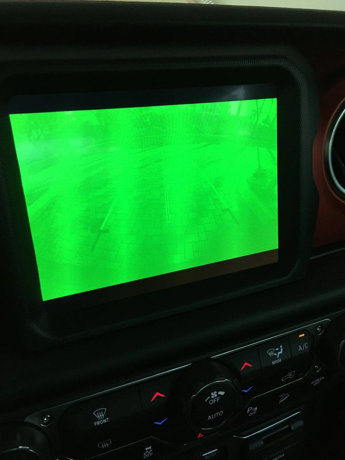

Now my back up camera is showing the blue screen... took it to the dealer this morning and the service tech was aware of the issue but said they can't fix it until FCA creates an update to fix... I was told the same thing two months ago... @JeepCares where you at?

I apologize for this inconvenience. At this time, you can send us a private message with your VIN and current mileage so we can have this documented and looked into further.

This is my back up camera screen today. Did you get yours resolved?

No. I've had an open Star case since September with absolutely no follow up from the dealership or FCA. Very disappointed. On the last visit to the dealership in September my Jeep was there for 3 days and they "reconnected the wiring" and did other things but did not replace anything. This made it happen less frequently but it still happens. Initially the dealership blamed it on Uconnect and a pending software update. I've received all the current updates and no fix. Once the dealership realized that I had all the updates and they were still able to verify the problem they then opened the Star Case (not sure what this is but they made it seem like it was something important).
