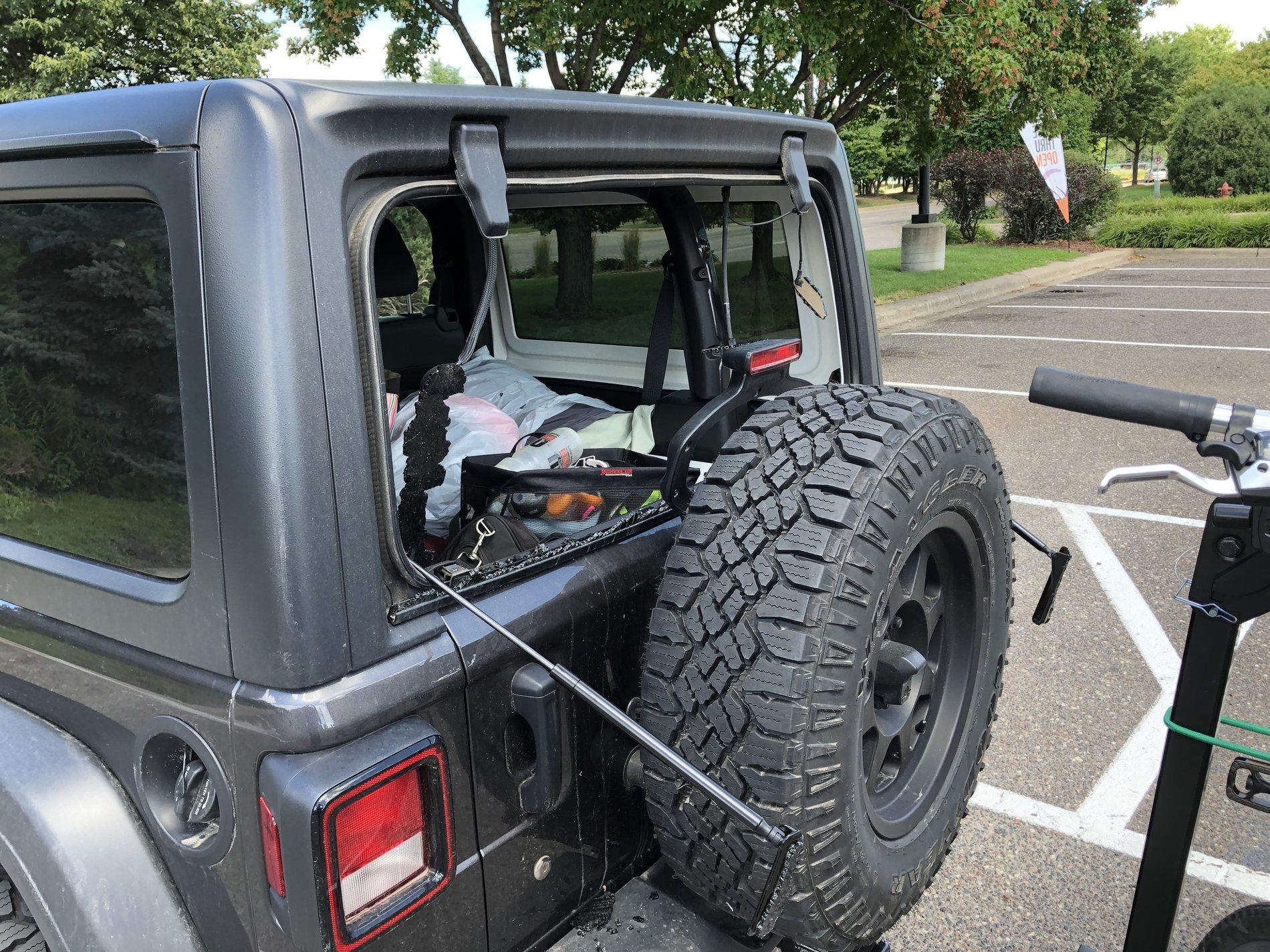

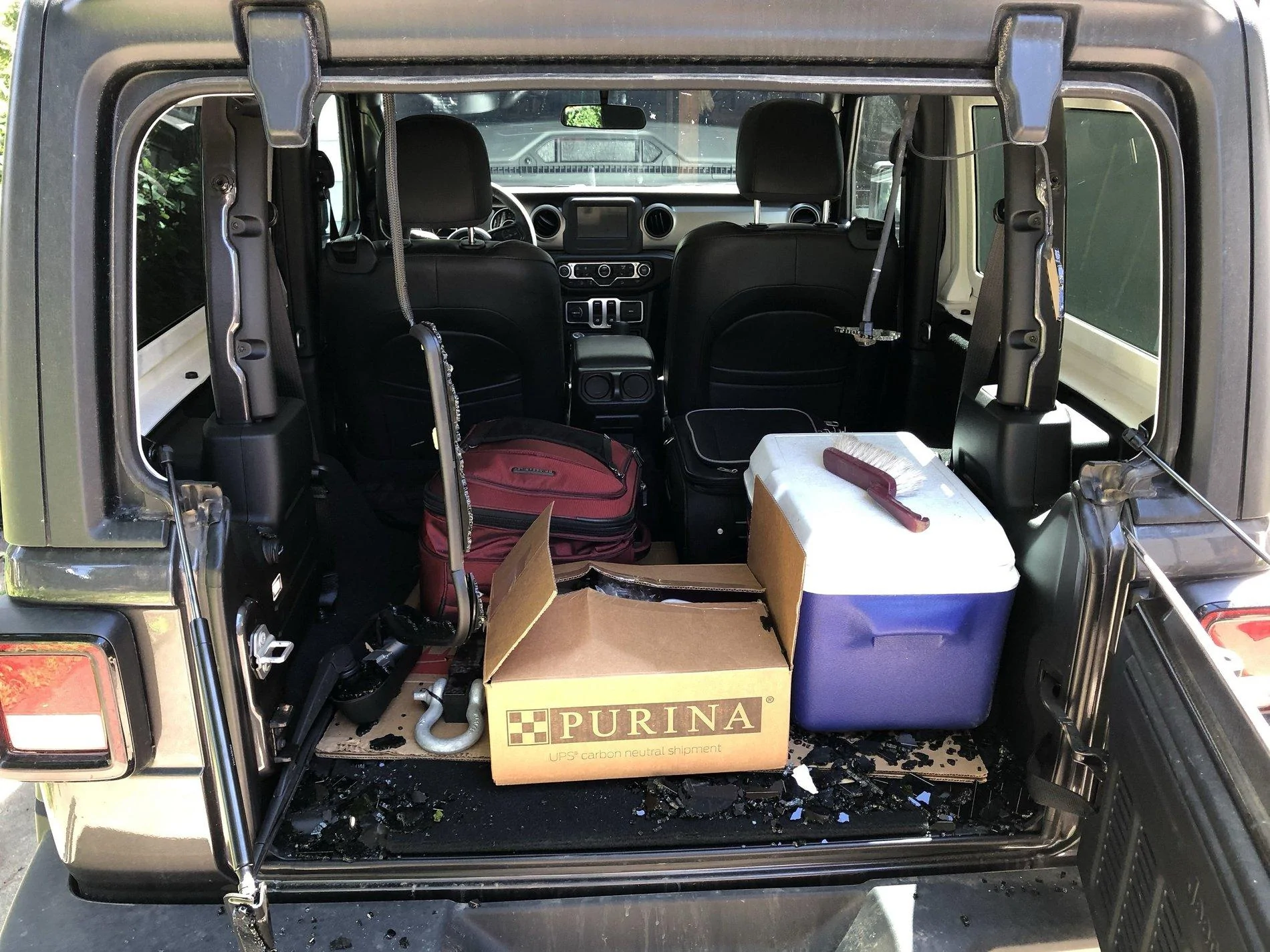

So I'm going down I 35 MN windows up and I Hear a loud bang ( not quite gunshot loud but close ) and I look up to see what use to be the back window hitting the cars behind me. The only thing left are what used to be glued to it, Wiper, spray nozzle, lift struts etc. No warning no prior damage no load on the hardtop nothing.
Anyone have this happen or hear of it happening?
Dealer will take 2 weeks to get the window and who knows about warranty? They are looking into it. Park Chrysler Jeep Burnsville, Minnesota
On the way up I got the windshield stared with a solid rock hit so i thought I was good for that trip.
Jeep Wrangler JL Back Window Blowout @ 70mph on Highway. IMG_9269

Yep, it has happened a few times. Sometimes glass has crazy stress defects, they'll get it fixed for you. I hope nobody was hurt.

Happens all the time on Porsche's from the rear defroster shorting out or causing uneven stress..
Im 90% certain it was your defroster that caused that.

I used to replace auto glass for a living and it does seem to just happen randomly. Some folks blame rocks, bb guns, the heat, the cold, the damn commies, or those evil bastards on the other side of the isle. Regardless of why, it's easy to fix and clean up.
Also, if you don't want to hassle with the dealership, try swinging by your local Safelite (or equivalent). It should only cost up to your deductable and can usually get fixed faster than the dealers can schedule it.

Hasn't happened to my Jeep, but I did have this happen in an '86 Saab 900 once. Going about 55-60 and all of a sudden, bang! Thought someone had taken a shot at me. The rear window in that car is about 1.5 acres of glass, very curvy, and heated. About 100 million little diamond bits of broken glass blew into the car. Just age and stress on the pane, was all I could ever figure.

A few months ago, one of the forum members had this happen to him and finally posted about it after the third incident. As I recall, the vendor who had installed the rear glass replacement had incorrectly centered the glass.

Park Chrysler Jeep replaced the glass under warranty. They did a great job, great outcome!

Yes they covered it under warranty. They took a few days to come to the decision and 2 weeks for the part to come in. They should cover it for you I think Jeep is aware of this issue.
