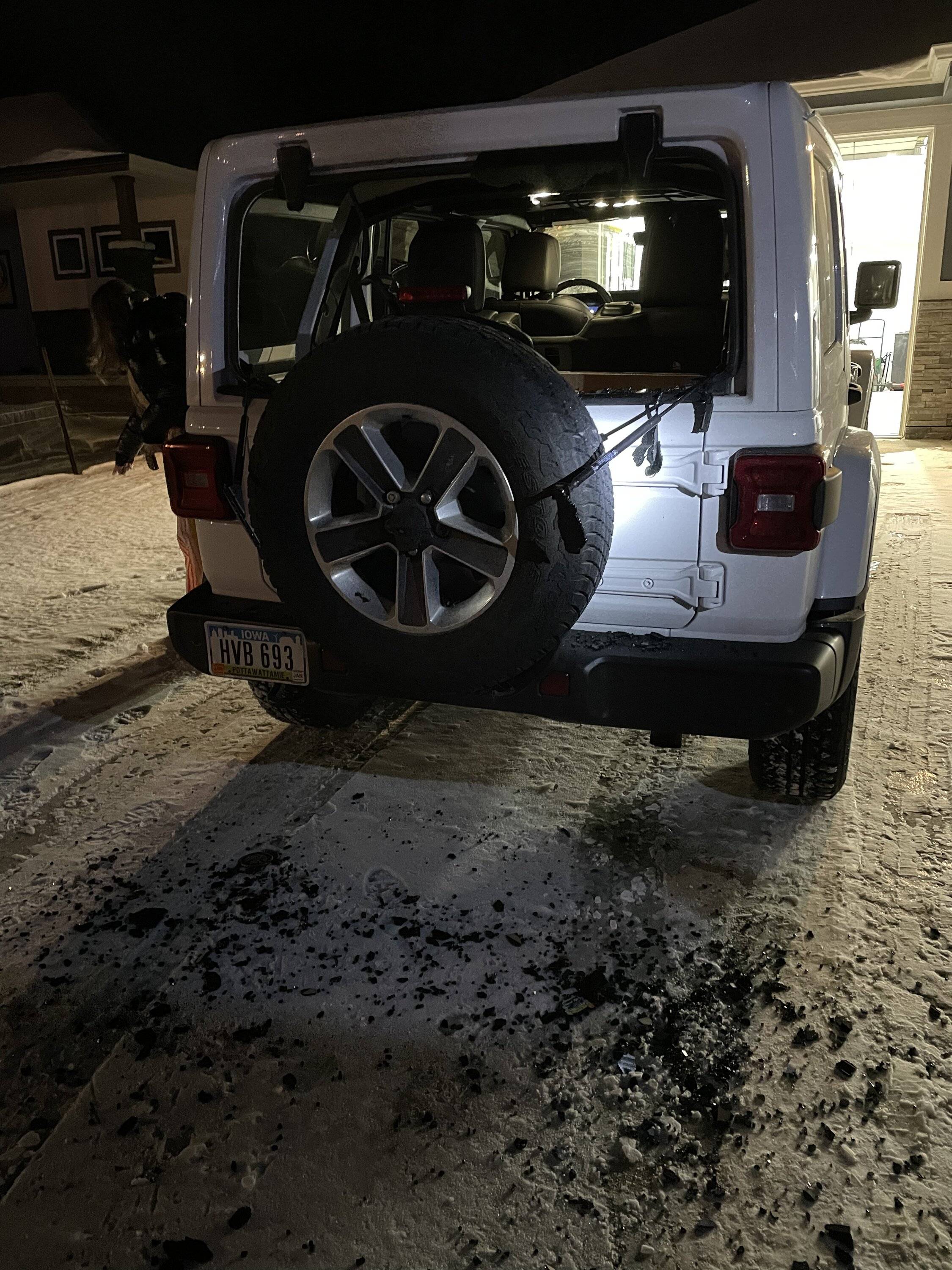

I have a 2018 JLUR with hard top. The back widow spontaneously blew out (exploded) not once but twice since I bought this Jeep in Sept. 2020. Both times it has happened it has been really cold. This morning I was looking out my kitchen window and it blew out minutes before I looked outside. 6 degrees this morning and think when the sun touched the glass it exploded. It makes me wonder if the struts for the window have to much pressure on the window when it's that cold. Has anyone experienced this before? It does not seem like I could be the only one. It happened last winter when it was this cold. These back window are expensive and I really do not want to replace one every winter.
This just happened to me last night. It was cold out (15 degrees) but happened at midnight, so the sun was not a factor with my incident.
Bummer! These back windows are expensive. The last glass shop I used to fix the glass did some calling around for me to try and get answers on why? The glass company was unable to find out why but every glass shop they called said it was not uncommon. Sad face :(
