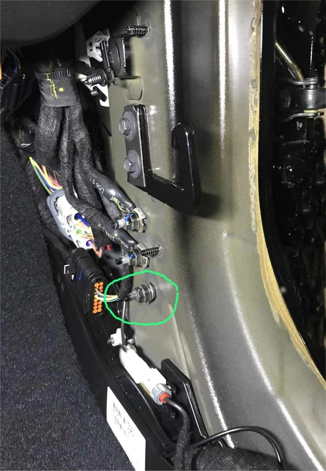

I have posted the pic of the grounding point in the passenger foot well a few times. I have gotten a bunch of Pm's saying that ground point worked out great. I have also heard from other's that the ground point did not do the job or it was not the best ground lets say.
The guys that had good experiences using that ground point, carefully, cleaned the paint off that ground point, then used it. There is often a heavy coat of paint on that ground point.
Anyway, very good ground point to use but DO, clean paint off well, before using it or expect no or iffy grounding...
