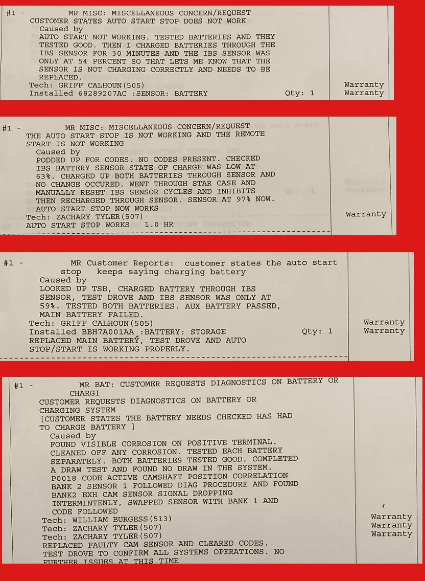

If you take your Jeep to the dealer when you are having battery trouble, one of the things they should do is isolate both batteries, charge them, and then load test them. One of the problems with this procedure is that old batteries will pass the test, but will not support the ESS Stop/Start system. That is one of the reasons that many people having battery trouble end up making multiple visits to a dealer.
It actually took 5 visits to my dealer to get my battery problem solved. Here are the write ups for the first 4. The 5th one was because when they replaced my main battery, they used a filled lead acid battery (not and AGM). On the 5th visit I got 2 new AGM batteries. BTW, my Jeep was a 2020 and this service occurred over a 6 month period near the end of my warranty.
