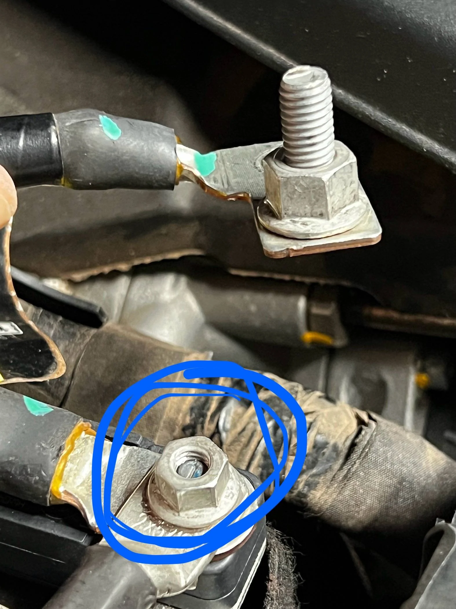

Pulling F42 (do it before isolating the aux battery negative) stops the dual batteries from breaking parallel. It actually prevents error codes, at least most of the time (depending on the state of your software and batteries). Starting and ESS should function normally, both discharging only your main battery. Displayed voltage and charging may be different than before the mod. Good luck.

Okay, now what do I do about this (OEM stud being too short to properly use it)? Damn, why does this have to be so complicated? My winch cable fits, but only half the nut fits on. AND, I can’t get my Cascadia solar panel wiring to fit on as well. I did use blue thread locker on there for the moment.
This is what I am referring to (post 2021 JLs):
https://www.jlwranglerforums.com/forum/threads/ess-battery-cable-change.86624/post-1806411

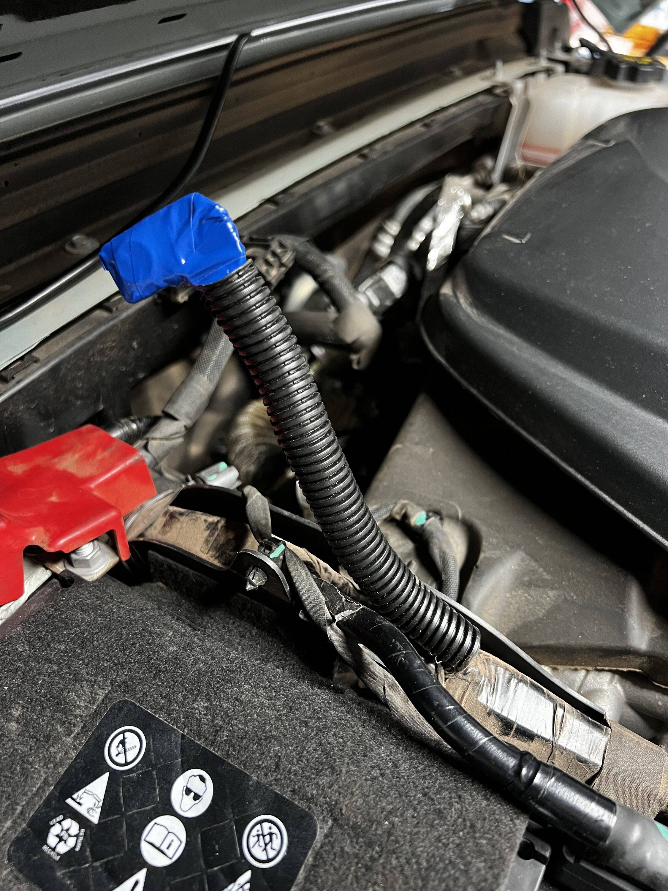

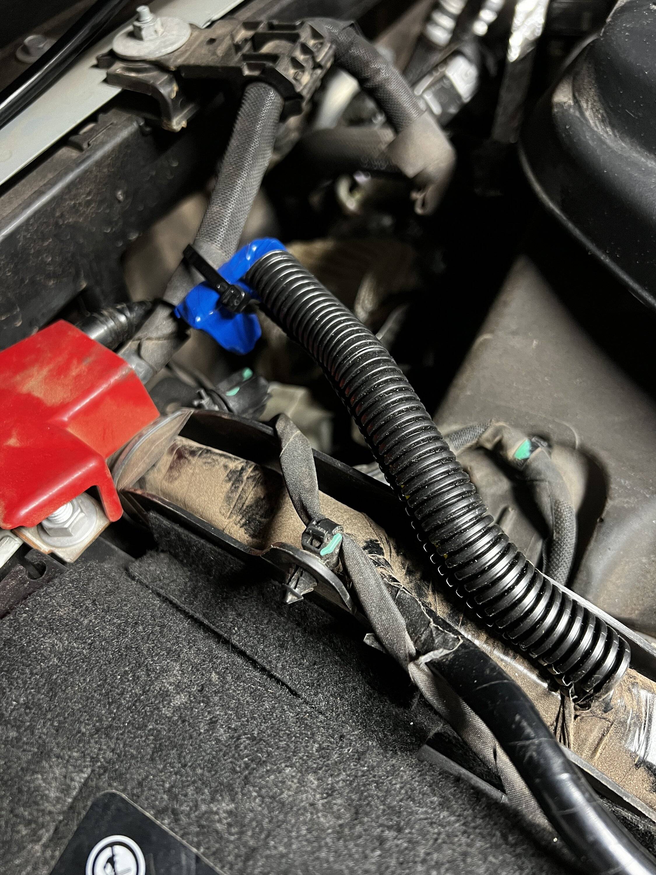

I wrapped the end of the aux neg terminal in blue electrical tape (so I can easily reference to my dealer what I touched, when needed), then put flex loom over it, and then zip tied it to the positive wire (the L shaped end actually helps with this zip tying.) Am I missing anything?
Now I just need to figure out a better place to ground my winch (which was grounded by AEV when they did my front bumper, so I doubt there is any slack left on that cable).
AND: I just remembered that I still need to attach my ARB twin to that negative terminal too. Anyone have a link to a cool negative bus bar setup?!

The least complex method is to insulate (i.e. cover metal thoroughly with electrical tape) the terminal connectors you remove from both aux battery posts.
It's best to secure the cables against vibration/chafing.
With the aux battery removed, the aux battery ground wire does not have to be disconnected from the main battery negative post.
If I understand your configuration correctly, your ESS/Aux battery negative cable is protected from short by the 150A PCR (ESS) fuse, however I'd keep positive and negative cables/terminals as far apart as possible.
