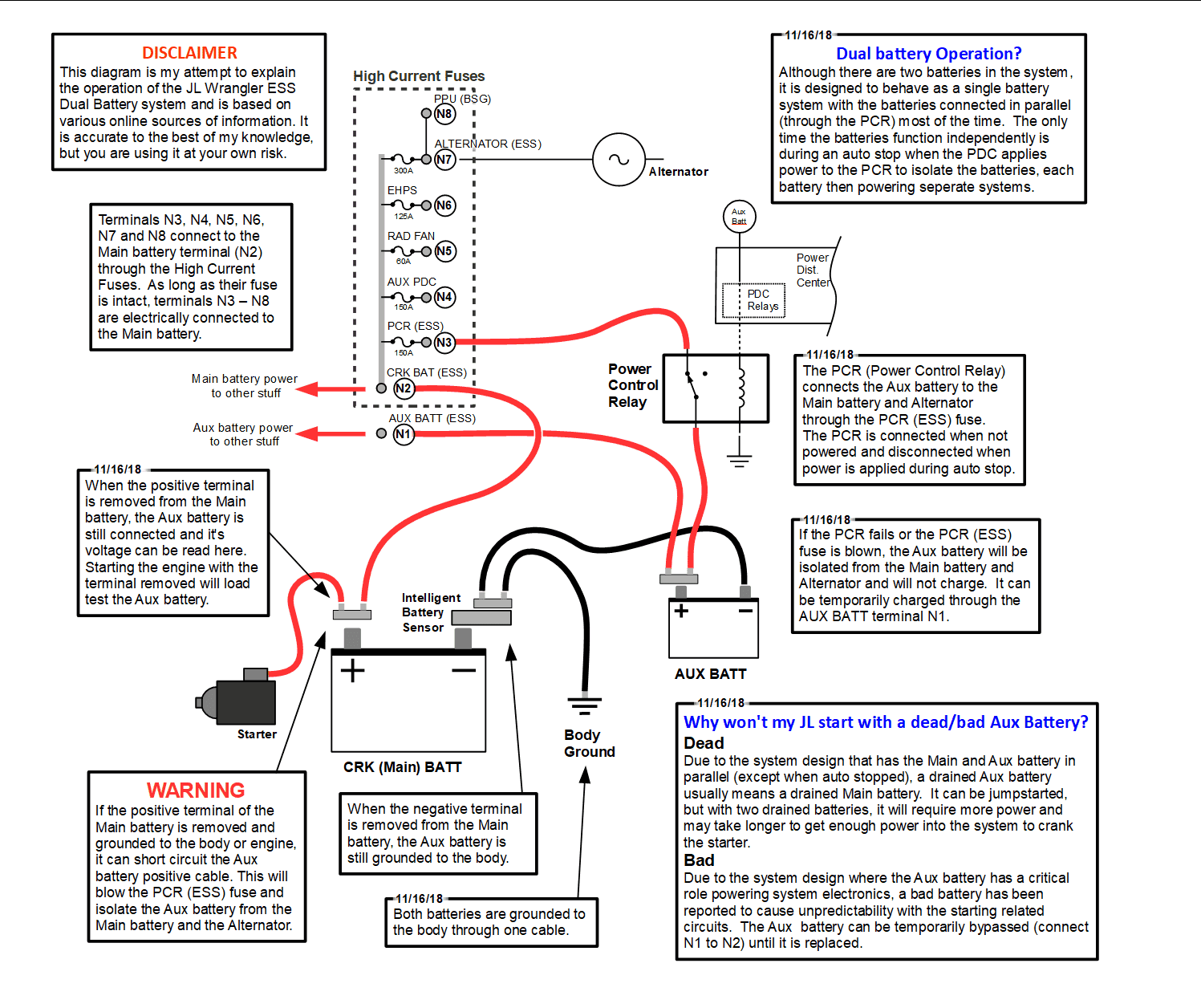

So, I did the bypass. Pulled the fuse and disconnected the negative Aux battery cable. I still have a "service ESS" warning light and message. Bad main battery?
Unplug the Intelligent battery sensor (IBS - not really intelligent) that goes between the battery cables and the negative post on the main battery. Leave it unplugged for 30 seconds. This resets the IBS.

It's really this simple.
There are no error lights because your JL is unaware that Fuse 42 is not in place, and that the Power Control Relay (PCR), that device that separates the batteries for an instant at cold crank and during ESS events, can't function because of this fuse pull.
Your JL aimlessly thinks it is isolating the ESS/Aux battery for testing, when pulling Fuse 42 prevents that, and instead, calls for electrical current from this ESS/Aux battery are instead routed to both batteries: which for you is only the main battery, because you have disconnected the ESS/Aux battery.
It is precisely because this method of removing the ESS/Aux battery from the electrical schematic is so silent, that it is recommended to turn off the ESS system, or risk it engaging from solely the main battery.
Here again, many vehicles run ESS from one battery. But to repeat, the perfect storm of a cold night, long traffic light, old main battery, and (aftermarket) appliances could find you sucking voltage from your main battery, which will early terminate the ESS event, hopefully in time for the main battery to still have adequate cranking power to restart the engine that charges it.
We can only guess what threshold levels the engineers at Stellantis set this early ESS event termination level at, and whether they were more aggressive with it than vehicles running ESS with only one battery (and most other vehicles aren't nearly as often outfitted with as many energy sucking aftermarket appliances), precisely because, as designed from the factory, the main battery is preserved during ESS events in the dual AGM battery JL, to effect the bulk of the work in the post ESS event crank., unlike in other vehicles.
Shane from Genesis Offroad knows a thing or two about the JLs energy consumption and from what I've read is fine running ESS events off the main battery, but it's also true, given the way Stellantis designed the ESS system, ESS will stop working after 6 ESS events under one engine crank, resetting itself at the next cold crank, if the vehicle sees identical voltages between (what it thinks) are the ESS and main battery, assuming there must be some electrical short between the two batteries that cause it to read a voltage this is a composite of both batteries linked in parallel (like what you see on the dash in accessory mode with the engine off with two factory batteries connected.)
Because Shane runs ESS events off the main, absolutely no disparaging intent implied, he faces this 6 ESS event test.
I've never run that many, (6) ESS events under one cold crank. It is an awesome kit for overlanders and I only mention this 6 ESS event condition to highlight when, and when not, your JL is aware of the changes you are making.
All this said, there is another route. You could disconnect your ESS battery and stop, no fuse pull, no N1 to N2 jumper, Jerry's original technique.
Doing so will prevent an early model 2018 without software upgrade from cranking. Dual AGM battery JLs in later model years will fail on the first crank attempt but subsequent ones will succeed provided the main battery has ample power, turning ESS off in the dash. In this case you not pulling Fuse 42 or jumpering N1 to N2 DID make the JL aware that something was wrong.
And some may call this approach, if you don't mind idiot lights in the dash, a good thing. You don't need to remember to turn ESS off with the button or buy tech to do it.
But, as raised by me in a prior thread about this, Jerry believes the ESS off light in the dash serves as an early warning sign of problems, that if you expressly engage, might cause you to miss out on knowing of problems with your vehicle, and he doesn't advise it.
I did exactly the same and now have the service stop start system!
Because you disconnected the ESS/Aux battery doesn't mean, before you did so, or by the mere passage of time, your main battery isn't also in need of service.
The steps you took now make calls by your vehicle to read only the ESS/Aux battery's voltage read all available batteries' voltage, which in your case is only the main battery. And if that battery is need of replacement, no differently than an ESS/Aux battery on its "last legs," you could have the message you describe.
Of course it could be something else but if it were me I'd load test the main battery.
