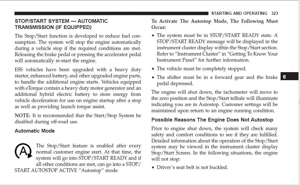

As for the first problem, this is very normal for almost if not ALL stop/start systems...the same should happen if you are at a stop light, the engine shuts off, at this point if you let off the brake to creep forward and stop again, the engine will stay running and give you the same message. I'm not going to lie and tell you i know why this feature exists, but I will tell you its quite normal.

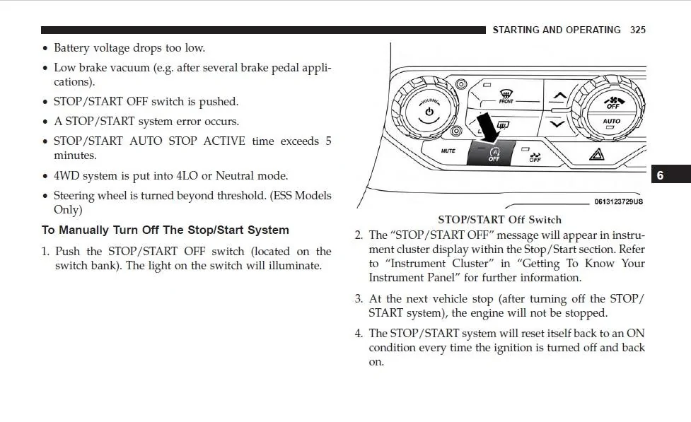

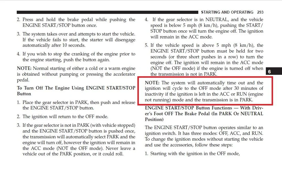

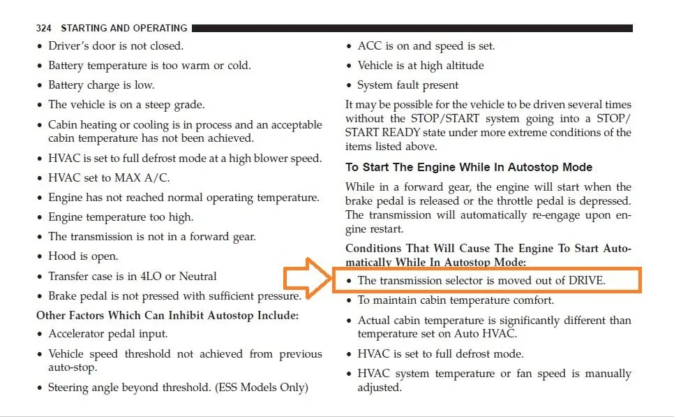

Ok... last oddity. When the auto start stop is working...and I pull into a parking spot. The engine cuts off but then when placing the car in to park...it causes the engine to restart. This seems like it should not happen. Is this happening to anyone else? it may not be Park that is causing the restart, it could be coming out of Drive, or going into Reverse...dont know exactly...but annoying nonetheless.
Anyone else having the above issues?
I never really understood this either. Why would the engine restart when attempting to park? The owner's manual describes this very scenario. I suppose you have to turn off the ignition prior to shifting out of drive as another poster recommended. Just seems odd. When parking, if your foot is still on the brake pedal you should be able to shift into park without the engine re-starting. Maybe it is designed this way so you don't forget to turn off the vehicle. Let's say you park, foot on the brake, engine shuts off, you shift into Park (engine still off). Now you exit the vehicle. You forget to press the ignition button to kill the vehicle before exiting because the engine was already off. When you leave the vehicle with the fob, does the vehicle automatically shut down so it does not stay in ACC? I read that the ignition will automatically turn OFF after 30 minutes of inactivity.
Thanks for the post ... should have looked at that manual first.
I have noticed if I cycle through from drive to park slowly ... happens less frequently. Ultimately going to shut this feature off. JUst not getting an MPG difference worth having the Jeep restart so many times.

As far as your first issue goes, you are right and that is normal. The battery voltage is too low and it cuts off the system before the vehicle won't restart. As far as your second thing, I have learned not to push fully down on the brake pedal all the way or to shift into park fast--engine won't shut off if you do either

Have you read your owner's manual yet? If you had, you'd know that's how it's supposed to work. And when you shift to park, the engine restarts because your ignition is still in run mode. Turn off the ignition.
