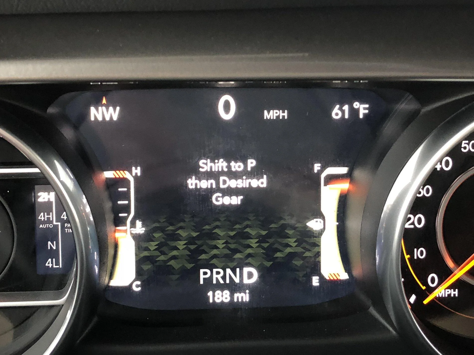

OK. I got my JLU (Automatic)on Saturday night. On my way home from the dealer I pulled up to my first red light. The engine shut off, as expected. But as soon as it did, a message popped up in the information center that said “Shift to P Then Desired Gear”
It does this every time ESS kicks in at red lights. Is this some sort of god awful bug? I wasn’t planning on disabling it, hoping I could entertain it so I could get better than the 12.5 MPG I got in my JKU for 5 years. But clearly this isn’t by design. If I wanted to shift this much I would have gotten the manual again. Heh. But I wanted the 8 speed ZF auto tranny. My commute is 30-45 minutes of stop and go city traffic.
So has anyone else seen this madness?
Thanks in advance for any info.
I think this may be an issue with the software. Your Jeep seems to think you're turning on the car for the first time but in drive, not knowing ESS is enabled. Have you tried pushing the ESS button off and then on again when this happens, to see if it resets anything for the next full stop you make?

Soo, my wife just called me this morning that during a red light something very similar to this happened to her, the ESS kicked in and turned off the jeep but along with it everything else and it started to flicker the dash/headlights. she said it took a while but it finally let her start it back up, i will be taking it to the dealer this friday. seems to me that system might be faulty or manufacturing plant is having issues with wiring?
