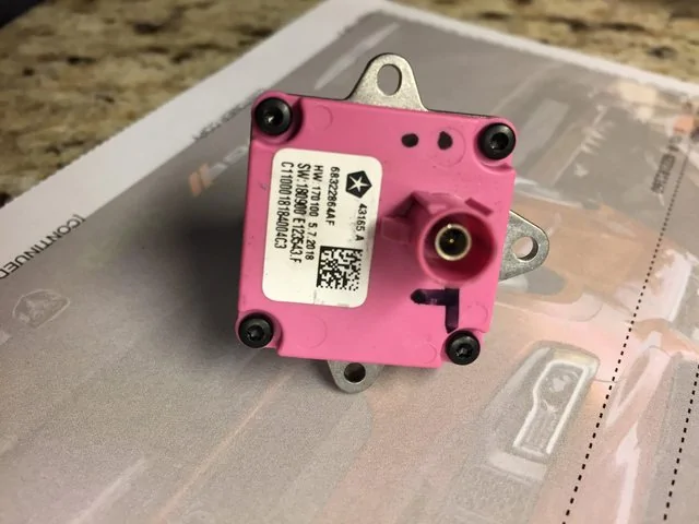

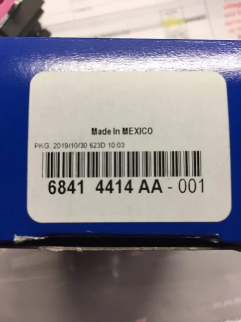

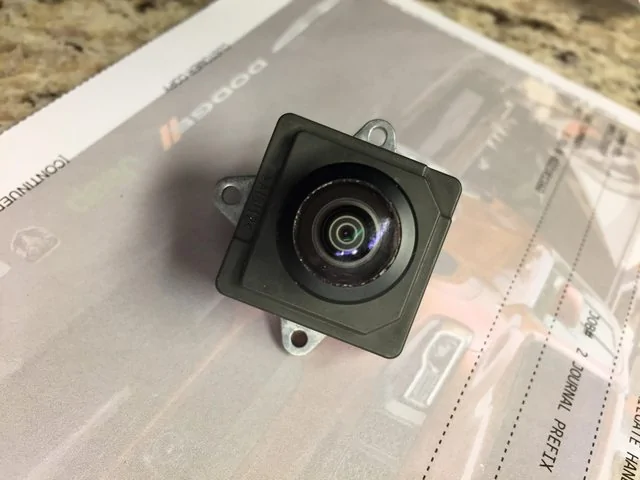

Regarding the rear back-up camera, it was as I suspected - there was a hardware part number change. When I did my research for the replacement part number, I found that #68414414AA replaced #68322864AF. I found this odd, considering my truck is a 2019, and there was a revision in the middle of the year. Here's a link for reference: https://www.moparamerica.com/oem-parts/mopar-rear-camera-68414414aa
This is the original camera (I kept it since I purchased the replacement, I own this. This is not to be sent back to FCA). Note the hardware part number (#68322864AF)
This is the replacement part number.
