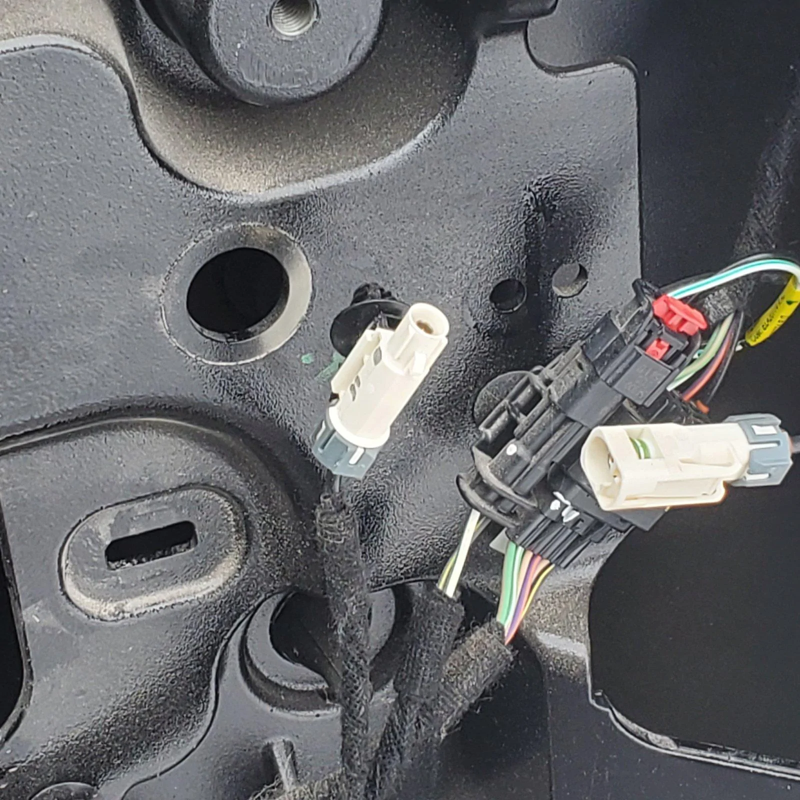

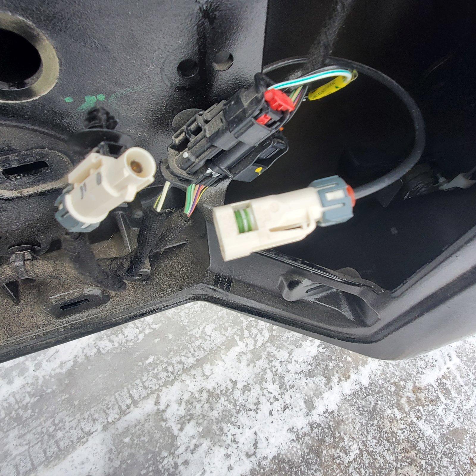

So cold snap and my radio is on and off and my lines are gone. How is yours after adjusting connectors? Jeep “cares” last advice was no advice and no fix.
Works perfect!

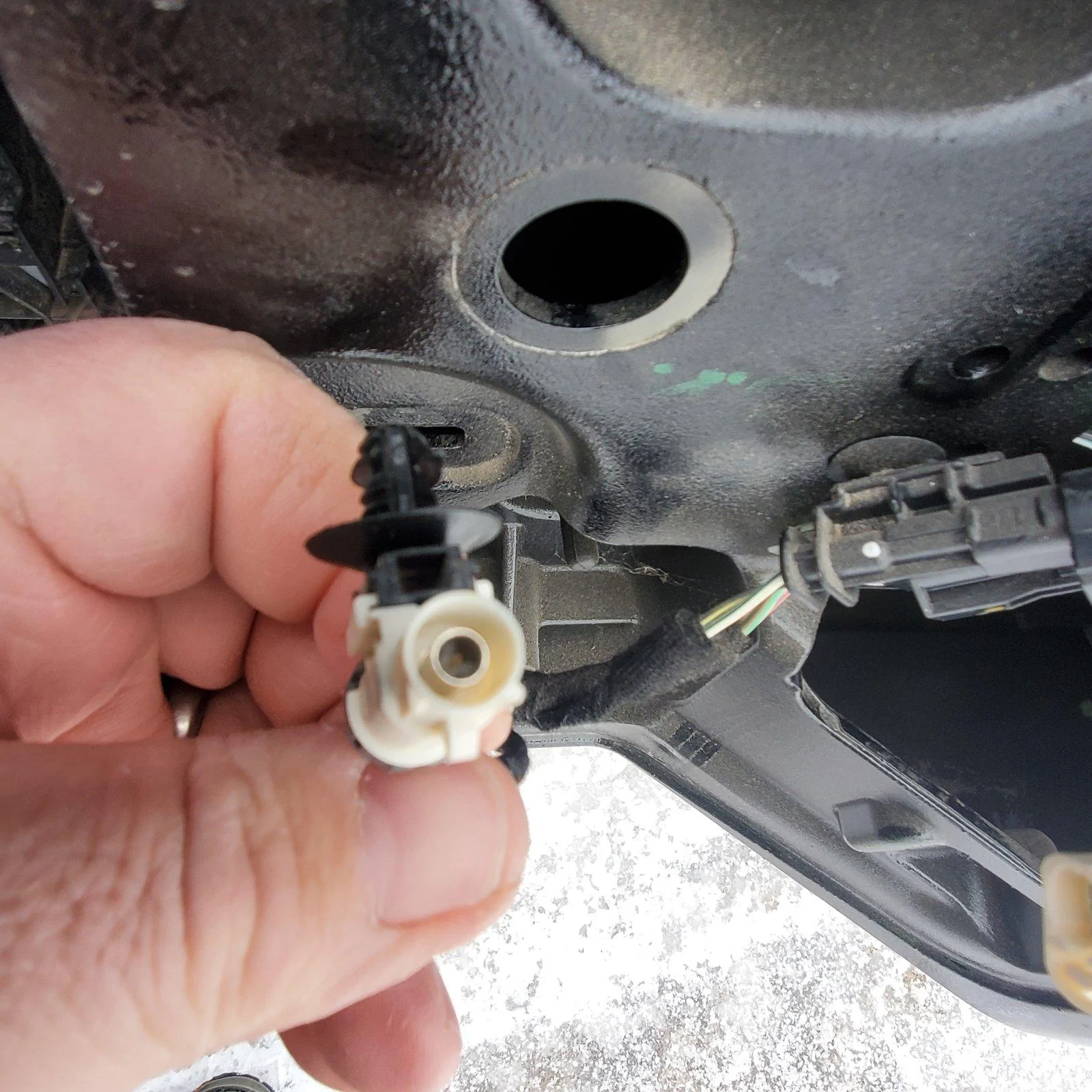

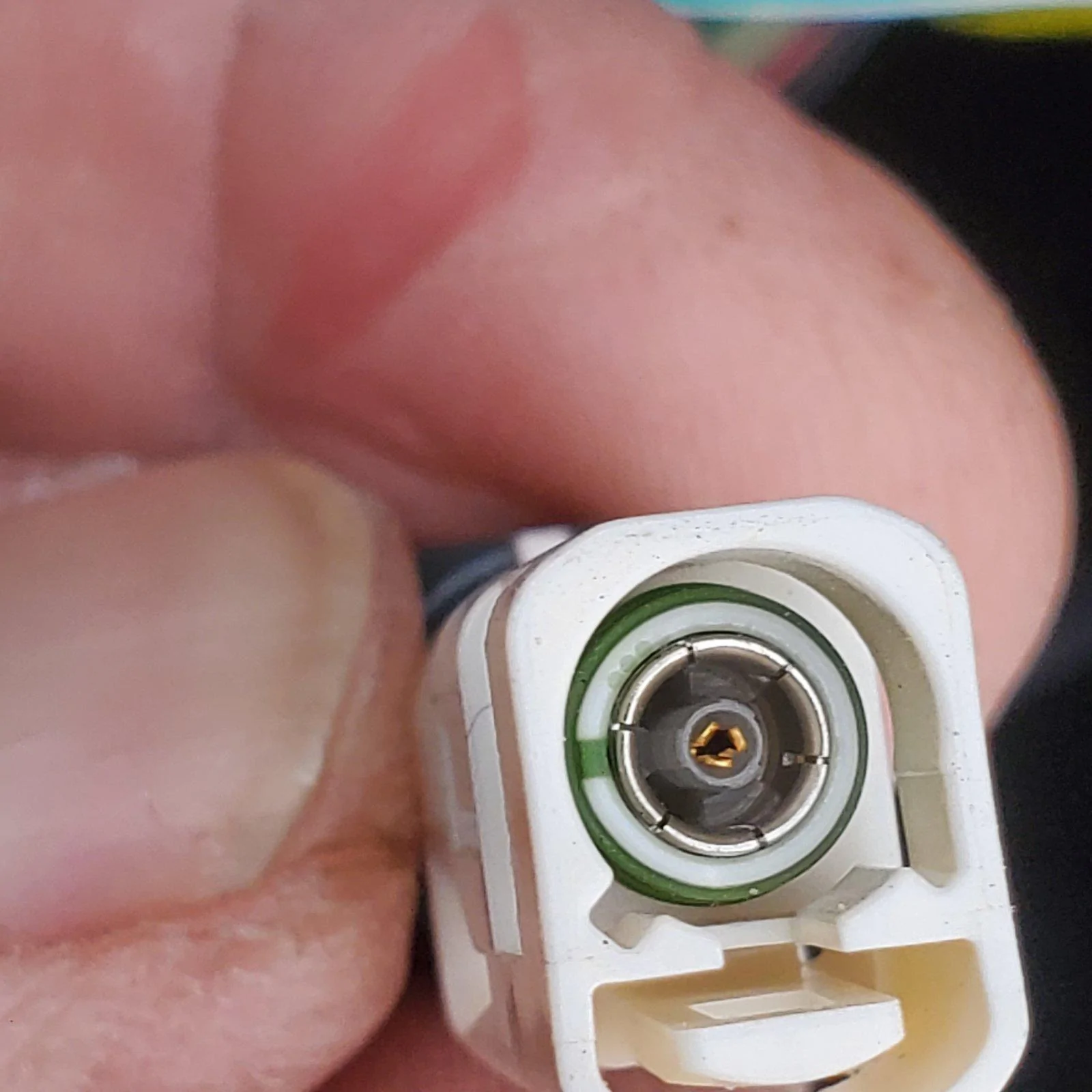

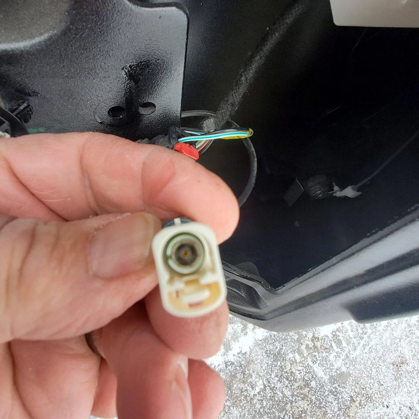

Lines came straight back after taking it apart and gentle air cleaning.
I believe it's a connector issue.
Hope this helps.
If you need more information let me know.
Best of luck

If you go to the back of the tailgate there is a panel that you remove. The backup camera is the thick black wire with a white plug on the end. You just disconnect the white plug and you are good to go.
Is the panel ON the tailgate or in the corner like by the taillight
Milburn
May 22, 2019
Ontario canada
2018 jeep wrangler unlimited Sahara, 2018 f150 lariat fx4. 2017 f350 platinum ultimate diesel, 2015 vw sportwagen tdi sel, 2012 f150 xlt
Open your tailgate. (Gently ")
Pull the black cover off the door.
Milburn
May 22, 2019
Ontario canada
The fix lasted for a month.
It started to cut in.and out again.
After a deep freeze.
I pulled it apart again cleaned it and this time added Fluid film. It took less than 5 mins and it works perfect again.That was last weekend.
It gonna get real cold tonight
I will check it again and see if the fluid film makes the difference.
I believe condensation builds up on cold nights on the ground (silver barrel) and prevents it from grounding. The radio believes the camera comes on and goes into a cut loop back and off with the radio.
Hope this helps
