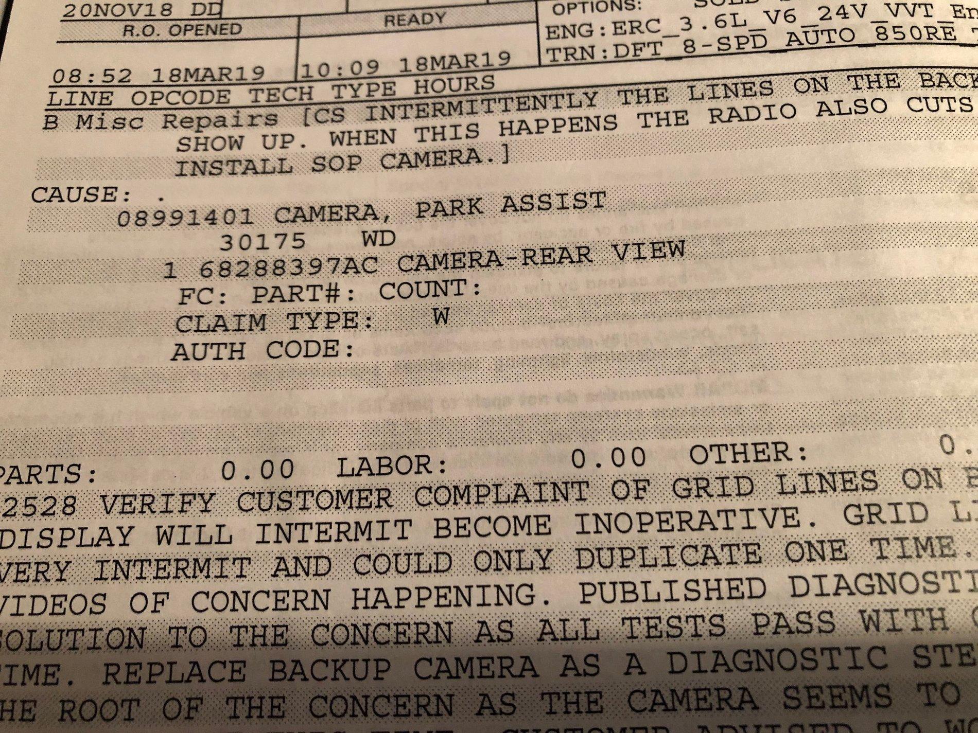

My camera was replaced in March 2019....no problems since then, although the backup lines can disappear if you shift to reverse before the system boots up. But they re-appear at the next shift to reverse. FCA knows its the backup camera causing the problem.

Here's what was replaced on our Wrangler in March. I will lose backup lines occasionally if the system is not booted-up before putting the Jeep in reverse.
FCA knows it's the camera. My dealer had the FCA service representative in, explained the problem and the rep said to order and install a new camera.

It's cold now here in WI and mine is acting up.
Has your camera replacement solved the issue?

I believe having the dealer disconnect the camera makes the most sense. 22 degrees here in Minnesota this morning and mine, with the camera replaced in March of this year is still good.

First cold morning of the season and it looks like the camera replacement was the winner! For anyone having this issue just have them swap out the cameras.

3 degrees Fahrenheit this morning in Minnesota, mine is still working. Camera replaced in March 2019.
