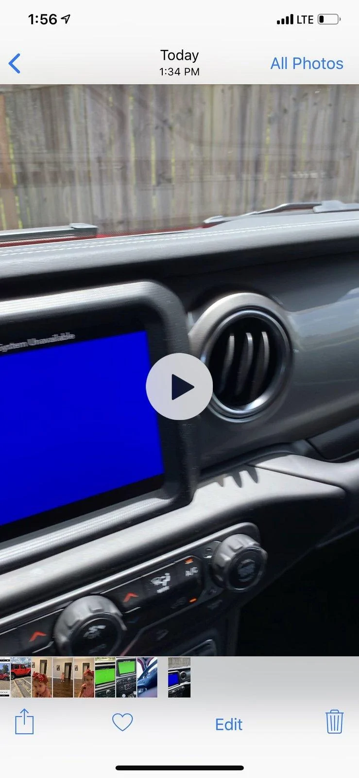

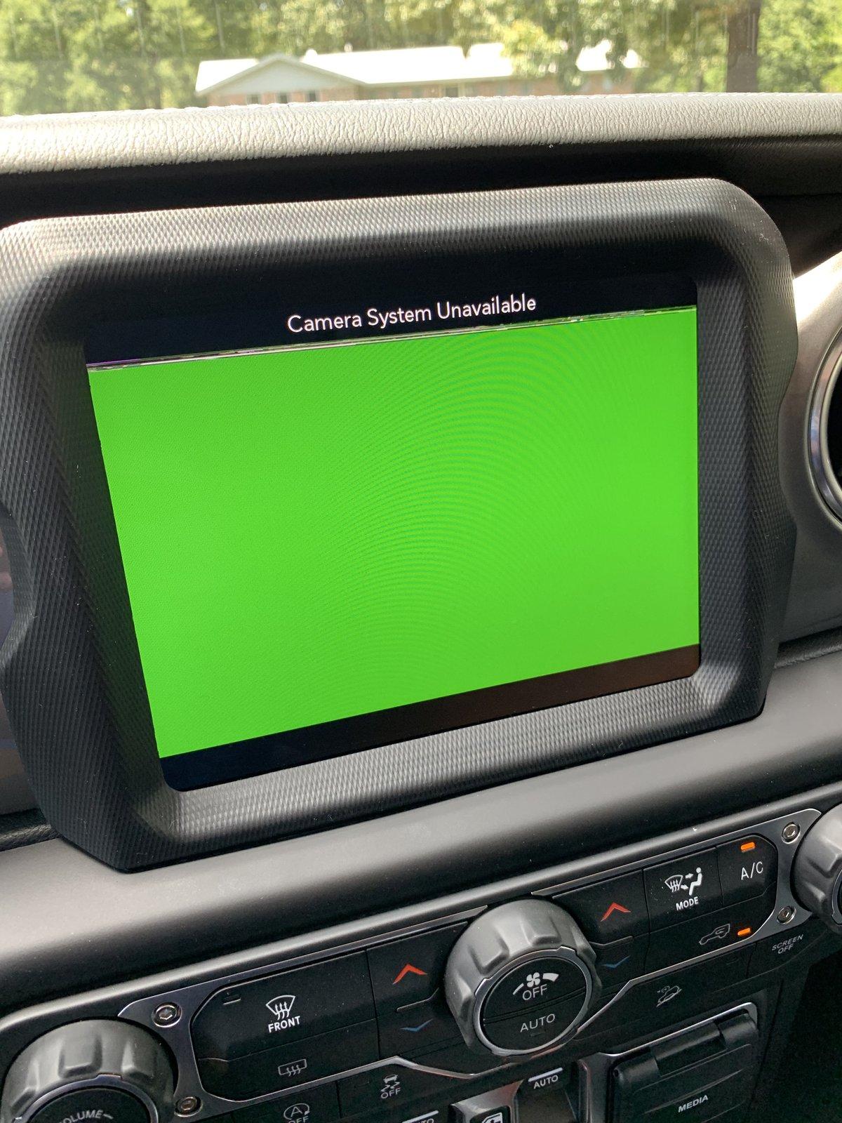

Just bought a new 2019 Jeep Wrangler Unlimited Sahara on Wednesday. Since day 1 I have had an issue where the backup camera will glitch out and either give a blue screen or sometimes a green screen. When it gets the green screen, the audio starts to cut out on every source every 2 seconds or so. I can then shut the Jeep off and open the door and wait about 5 minutes and if I’m lucky it will work for a while but then it starts acting up again. I took to the dealer today and waited 3 hours only for them to tell me that they couldn’t replicate the problem and to bring it back when it happened again or until I had video proof. I got a little aggravated but I told them I would get them proof. It wasn’t about 15 min after I left the dealership it started doing it again. So I took it back there again and am awaiting an answer from the engineers. I tried everything on this forum to know avail. I’m starting to think I should have kept my other vehicle. I have less than 200 miles on this Jeep with the majority of them having issues.
Beaswax1981
Jul 5, 2019
Sherwood Ar
2019 Jeep Wrangler Sahara
Well they sent me home again and told me to wait until the Jeep engineer comments back which could be Monday. @JeepCares
Brand new vehicle smh
