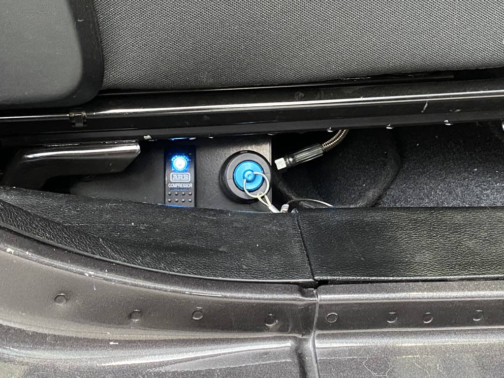

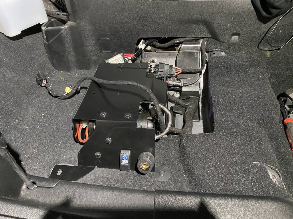

I have a 2021 JLUR, ARB CKMTP12 (portable) converted to a CKMTA12, and mounted under the passenger seat using an ARB 3550220 mount, all found here:
https://arbusa.com/air-compressors/on-board-air-compressors/
I use a MOORFlate kit with a 7.5 foot hose extension, so I can air up/down evenly and very quickly.
https://myoffroadradio.com/morrflate-off-road-4-tire-inflation-deflation-kit/
I had a reinforced custom power extension loom cut so I could route behind the driver's seat, around to the firewall, and around to the battery.

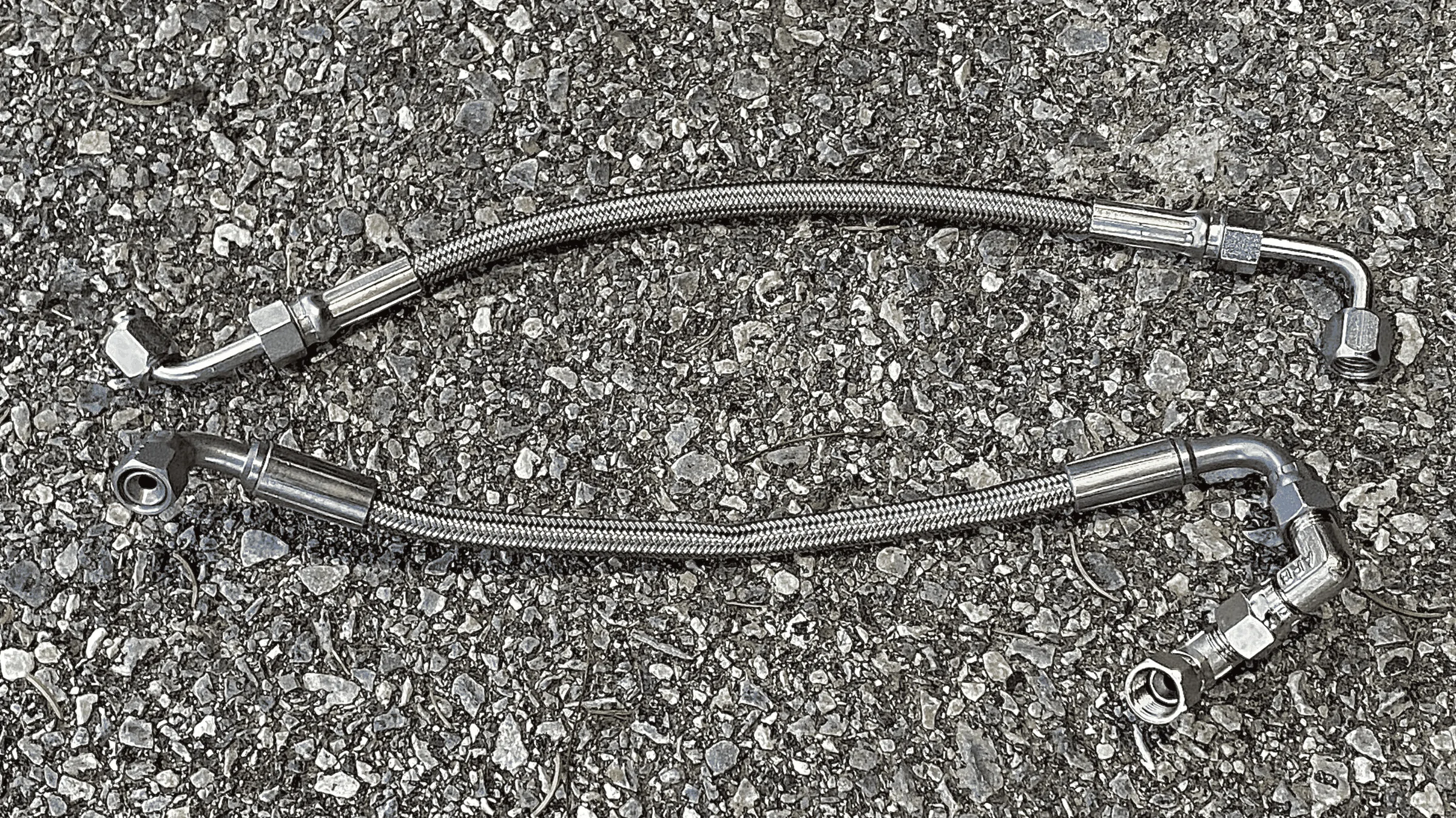

I had Kelly Industrial Supply cut a replacement hose so one end faces one way and the other end faces the other way. As you can see in the attached image, trying to MacGyver things wasn't working out. :)
A few issues I had to overcome:
  • I had to raise my passenger seat rear bracket ends by 1/2 inch or so, since the under seat wiring kept hitting the top of the compressor mounting bracket bolts.
  • I had to add a 7.5 foot air hose extension, so I could route the MOORFlate hose out through the winder, rather than have the door open when I'm airing up/down.
  • The compressor toggle switch is always lit, not sure if I missed a wire in the wiring. I was told not to worry about it since the draw is low, but still, I want to correct that, just don't know how. EDIT: a buddy told me I can disconnect the blue wire, it just means power is available to the on/off switch...apparently you can use an aux switch to manage power going to the compresor, so the blue light would be on if the unit is getting power.
Now that I have a Goose Gear full platform, I'm thinking I might replace the ARB dual compressor mount with the one that sits the compressor flat on the cabin floor.

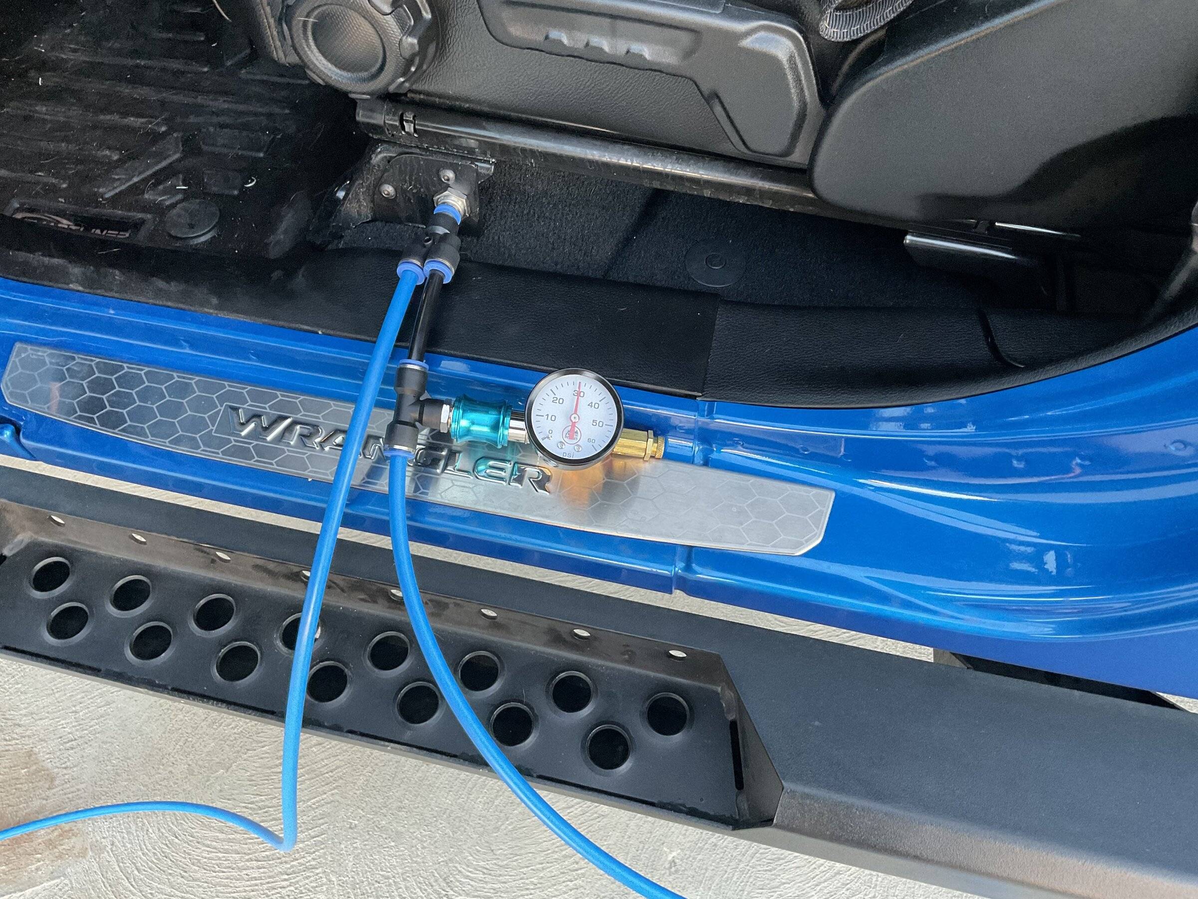

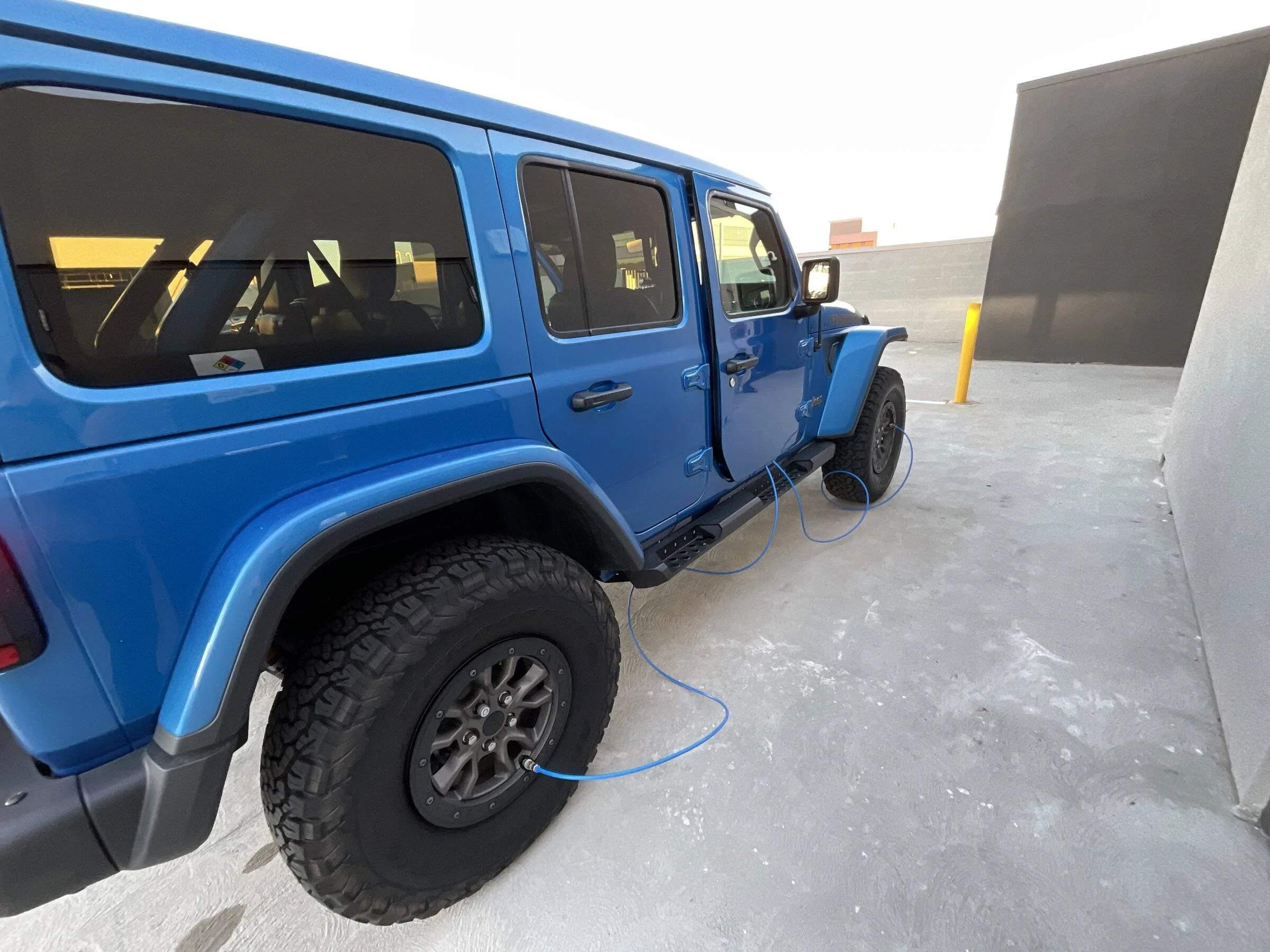

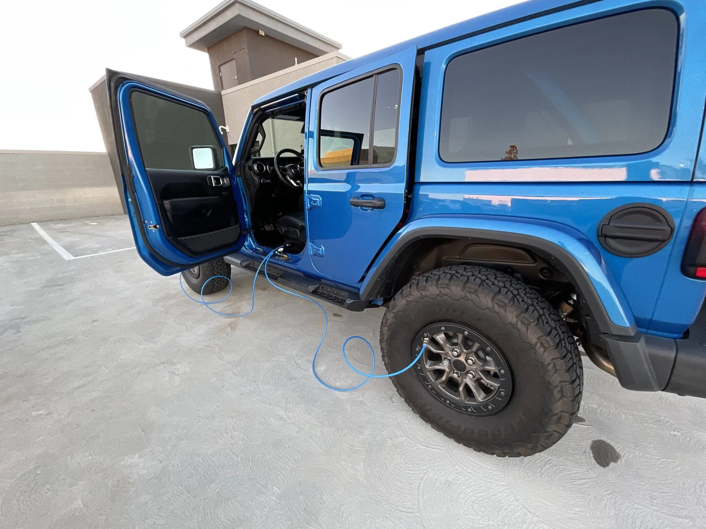

I went with the under the seat mount, it’s actually funny… I’m working on the release valve right now so once once all tires get to 33 psi it automatically releases. I love this system!
