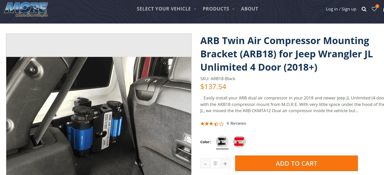

Hello,just purchased the 392 in the 24 model, would like to install the dual,ARB or compatible air compressor. Finding out a lot of options don’t work with the 392. Under seat option is now gone because of electric seats, fender mount is gone because of washer tank location, rear location is shallower due to larger muffler on 392. Anyone have any other solutions?
Jeep Wrangler JL 2024 392 ARB dual compressor options Screenshot from 2023-10-05 08-04-40

I didn’t think that bracket worked for the 392?
Yeah, unfortunately it doesn't. The cubby in the 392 is all but gone to make room for the exhaust.
EDIT: The option from MORE in post #3 looks like a possibility though..
Yes, I have seen that one installed and liked it the best...but IF I remember correctly, it is not for SOT...so depending on which top you have. I have the SOT but mine is a 2023 and went with the under pass seat option. I was lamenting not having powered seats the other day and memory functions...I will be quiet about that!

Don't think this option will work with the 24's. Was in the stealership the other day looking at 392 and it appeared to me that this area is now smaller. Be nice to know the reason why jeep expanded this plastic piece.

If you do go with the twin, add the compressor manifold kit. It is recommended by ARB. The Twin puts out a lot of heat at the quick connect and this eliminates the problem.
I have my twin compressor like the pic above Left rear corner behind the seat, 2022 Diesel and 22 392. Works great
