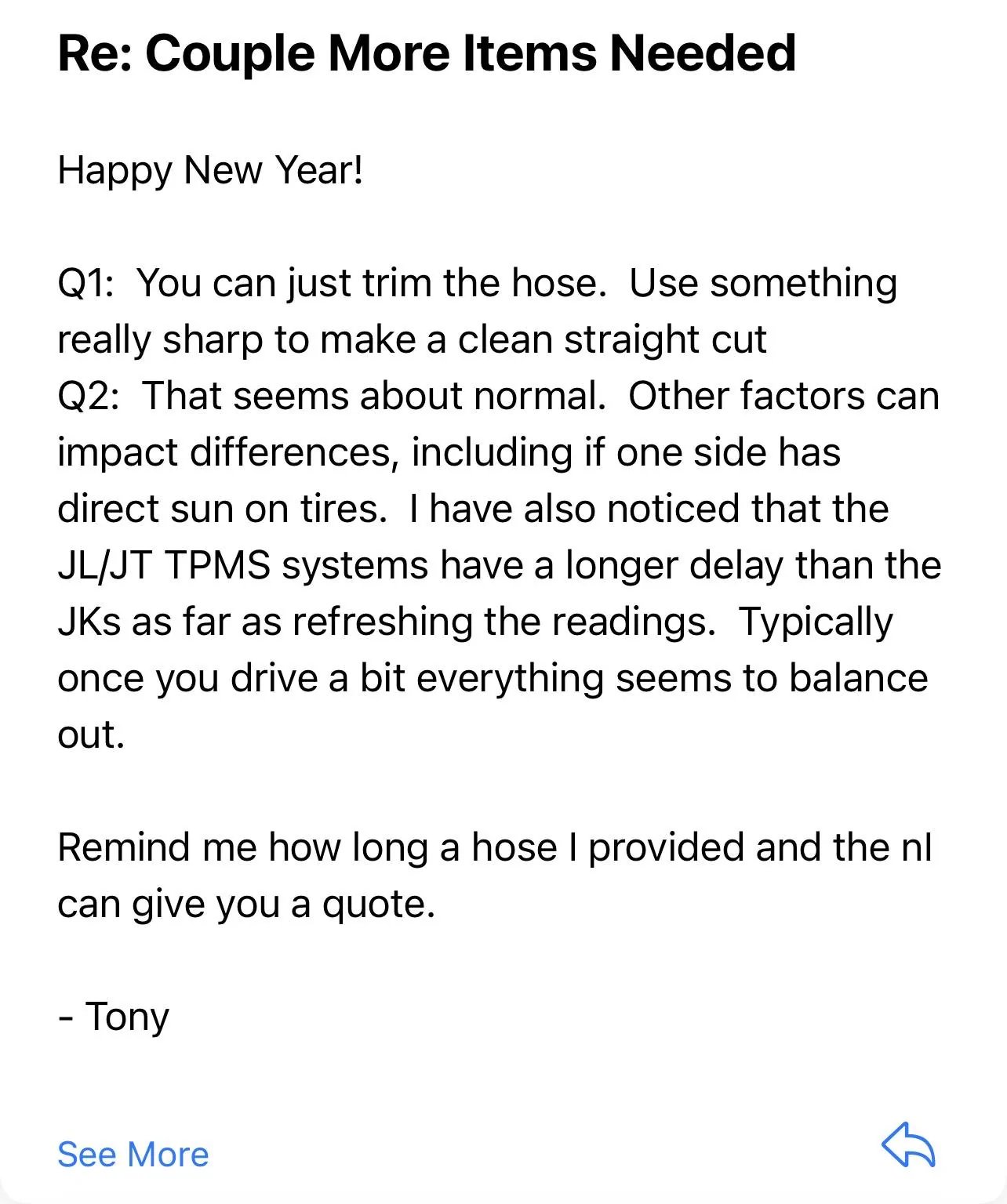

Next time allow a minute or two after the compressor is off and you start disconnecting the air hoses. I think that will give time for the pressures to equalize. I am planning to piece this system together on my own so I would really appreciate some feedback on this.

I wanted to see if anyone else using this system usually sees variation between tires when filling up all 4 at the same time such as this.
I do. I had much more than this though. I had 1 tire stay at 23 PSI while the others were at 33 PSI. What I would do is just shut the compressor off for 1-2 min and it would equalize. Not sure if actual difference in the pressure or if the TPMS was off since it was always the same tire. Anyways, no need for worry on your part.

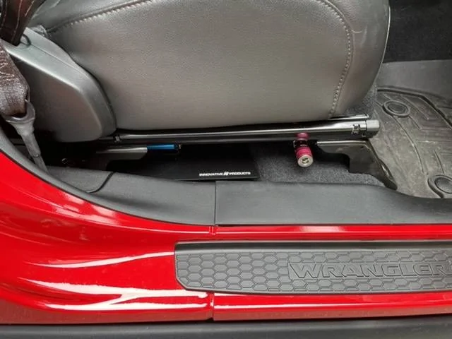

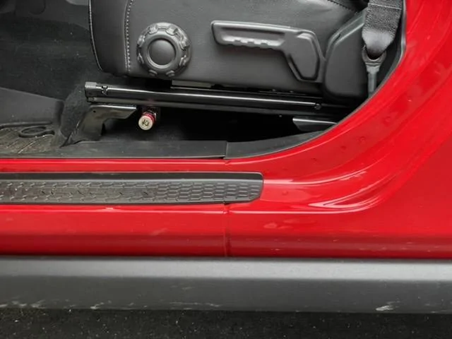

Does the innotive mount under the driver seat? I currently have my arb twin compressor just under the driver seat just laying around I’ve seen other mounts but I let for passenger seat I see their page says passenger seat as well
That isn't a real difference in air pressure between the tires. That would be close to impossible. It's just that the TPMS isn't updating evenly. I see this all the time.

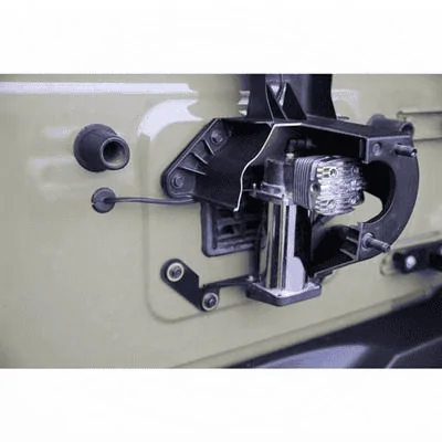

I was so intrigued by this install and wanted to copy it, finally found other pictures and unfortunately the compressor is mounted outside the wrangler inside the spare carrier.:(
It mounts under the pax seat. I have it in my JT and love it. When my 392 gets here, it will get transferred over.
