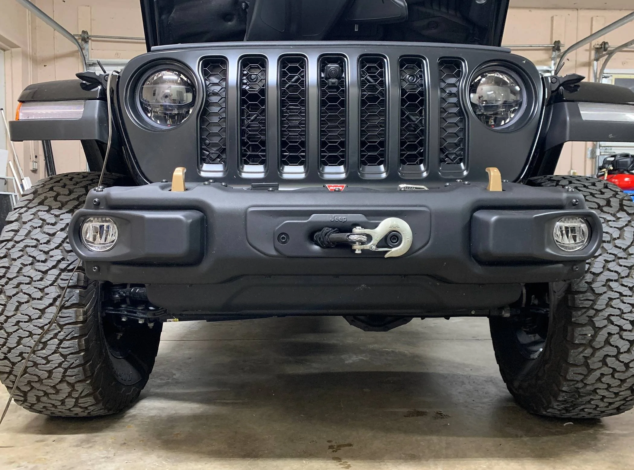

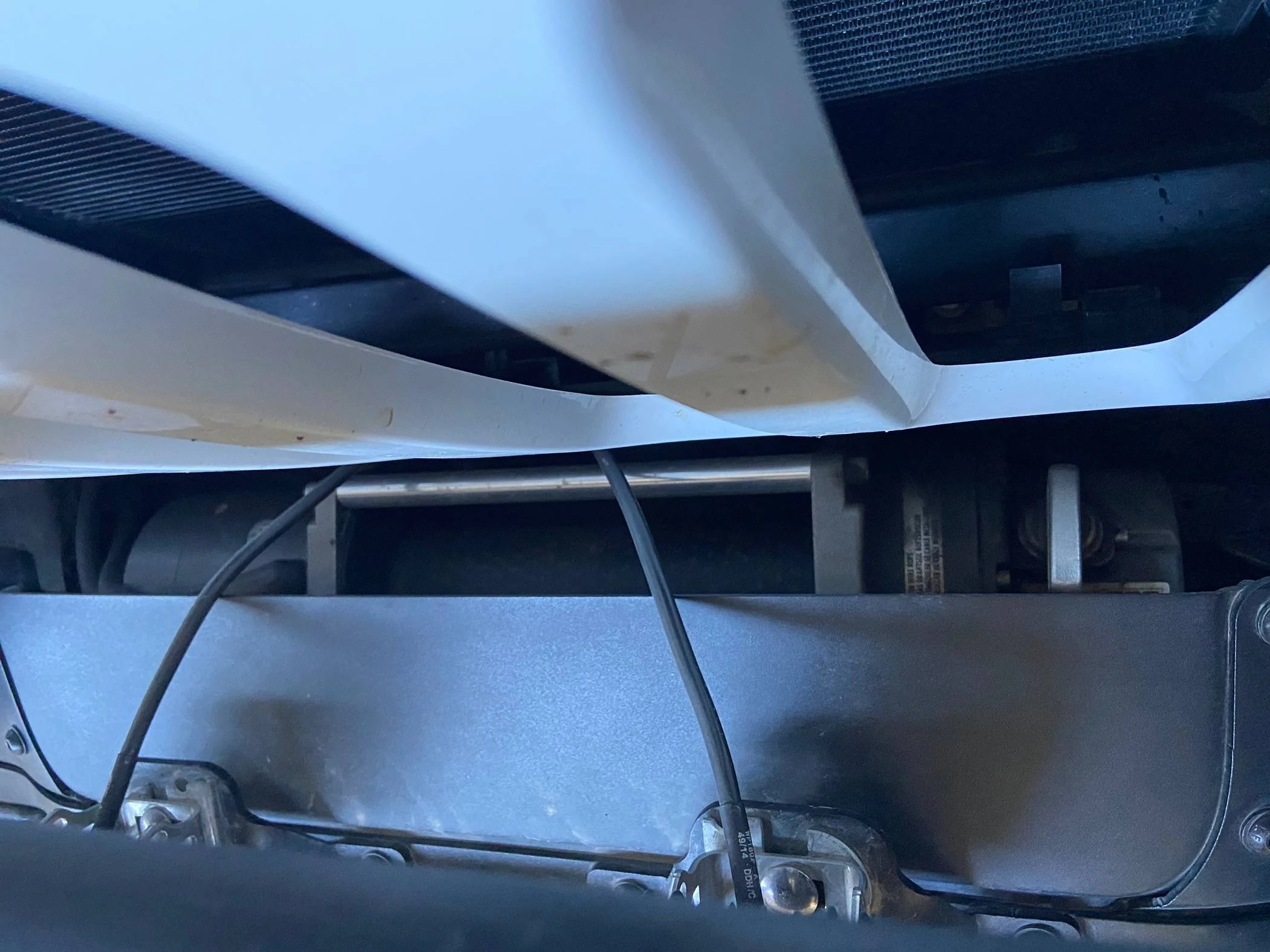

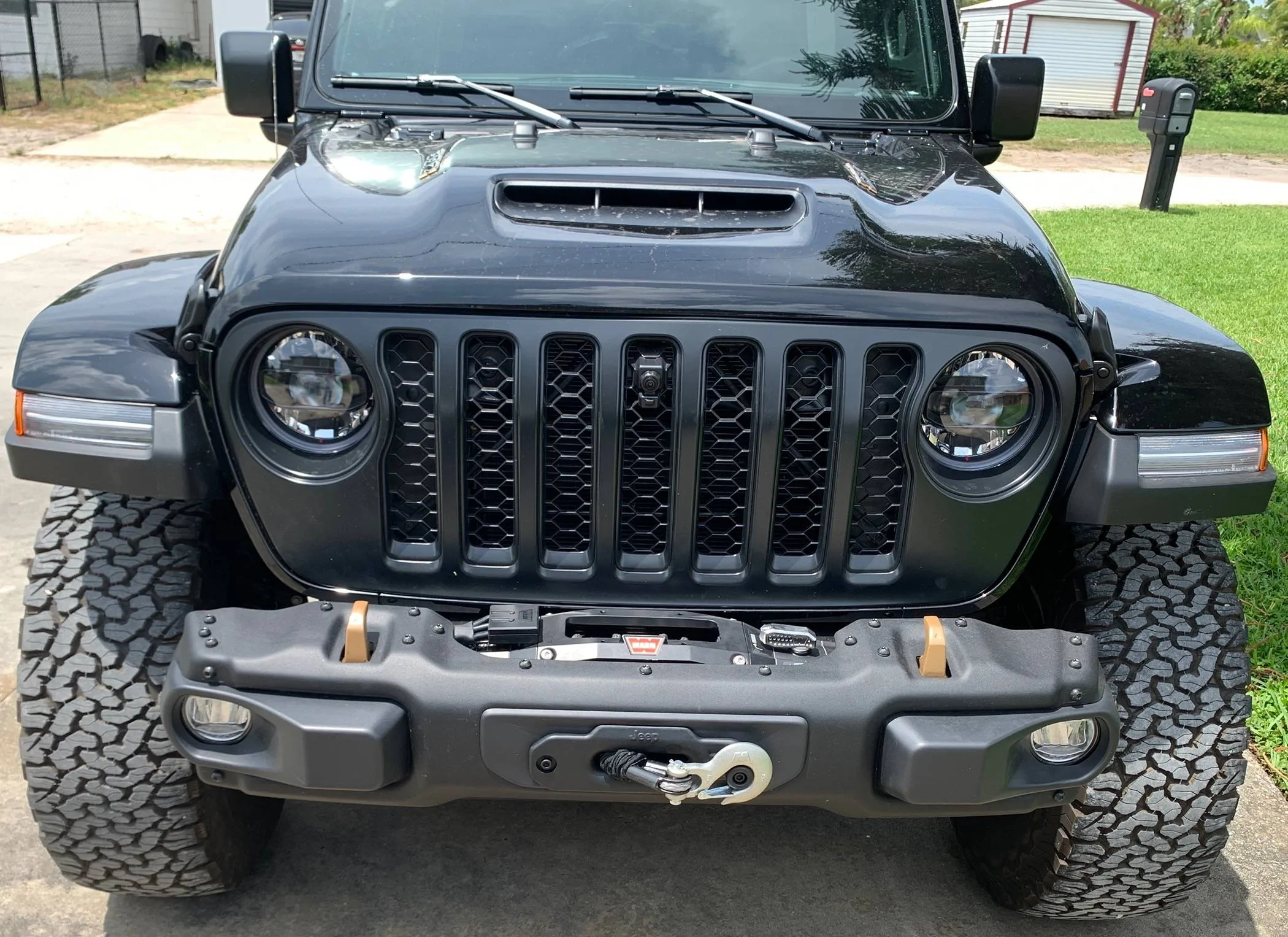

Finally installed Warn Zeon 12S winch on my 2023 392XR. Used the Warn Relocate Control Pack Kit to move control box to inside engine bay for a low profile install on factory steel bumper.
Used a Stinger 500 amp relay triggered from factory Aux 4.
And a 2024 Jeep factory fairlead.

That looks really good. How is the control box mounted?
