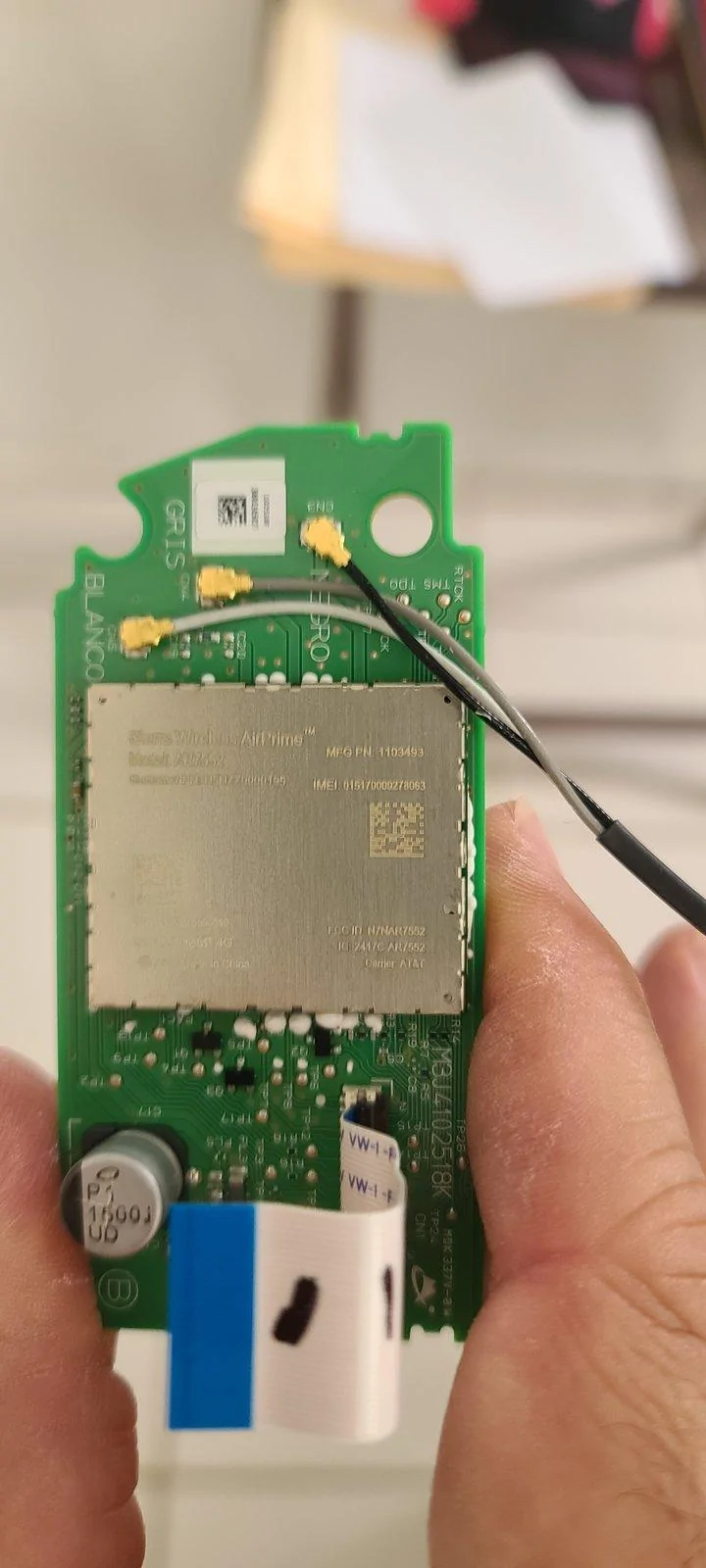

I resolve the same issue replace the sierra wireless airdcar, the card are damage. Its easy to change. And the gps its working again.
Do you have any more information? My 8.4 UConnect has lost all cellular connectivity, which apparently has result in my GPS, compass and Guardian not working.
Where is this card located? Inside the head unit or somewhere else? Is it a MOPAR part number, and if so, what's the number? Any additional detail would be helpful.
Its inside the radio in the right side panel. Its easy to change davicarm_0 on ebay and tell him about the card or send him this photo. I buy to him.
Good information in case this happens again and it’s out of warranty.

Luckily mine was still under warranty- I just always like to understand how all this works. This failure for me necessitated a complete head unit replacement b the dealer. Working great again now!
The dealer also told me I need the entire radio replaced. They tried a software update 1st and no dice. Why wouldn't they just replace the GPS card?
