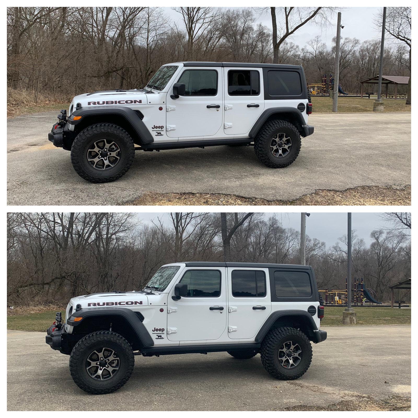

Installed my lift over the course of a couple days.
Synergy 2” with track bars and control arms. Love it.
I was going to pay nearly $600 to have it installed. Figured if I took my time I could get it done step by step. Only tool I didn’t have was a spring compressor (thanks autozone free rentals).

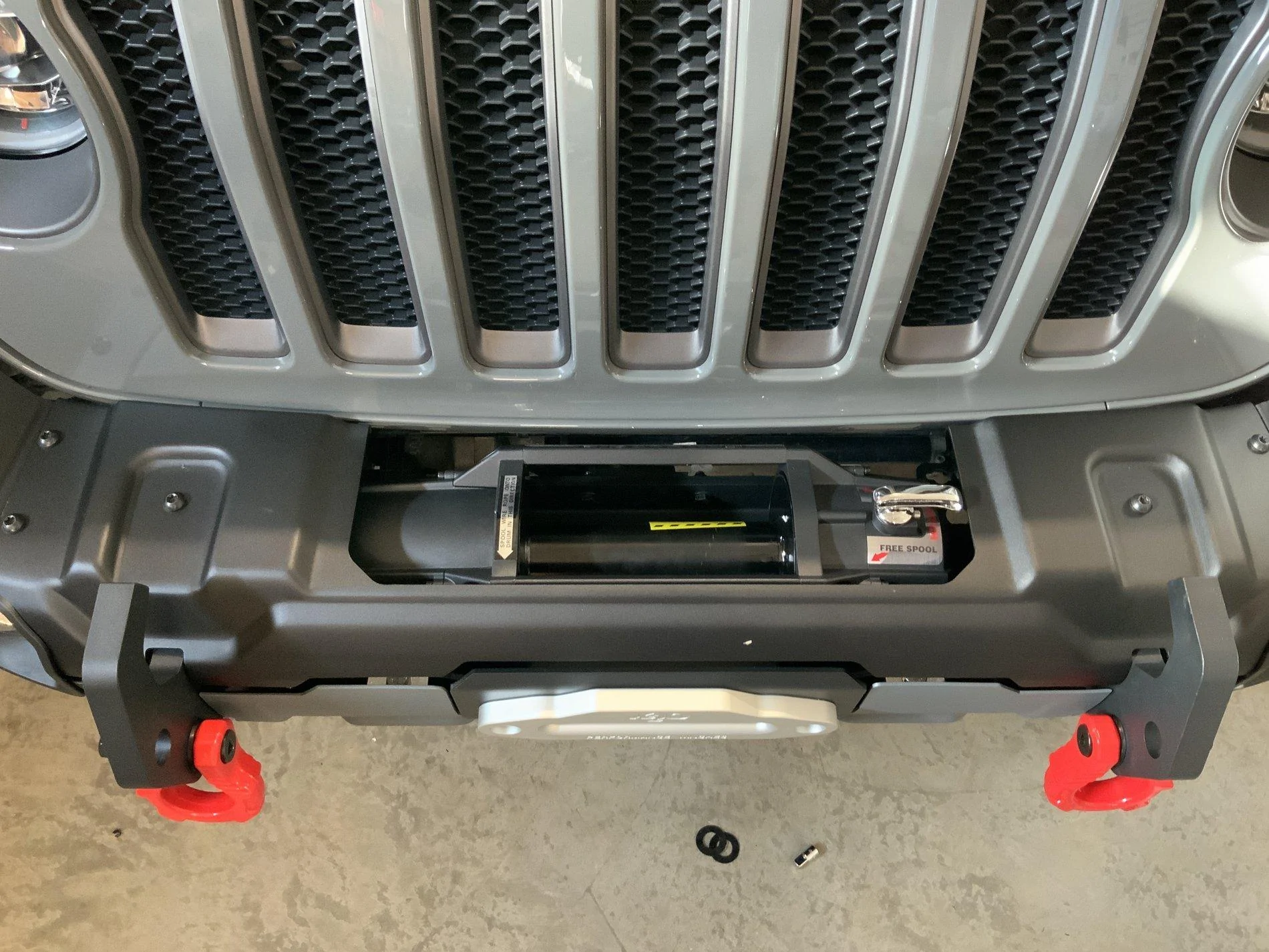

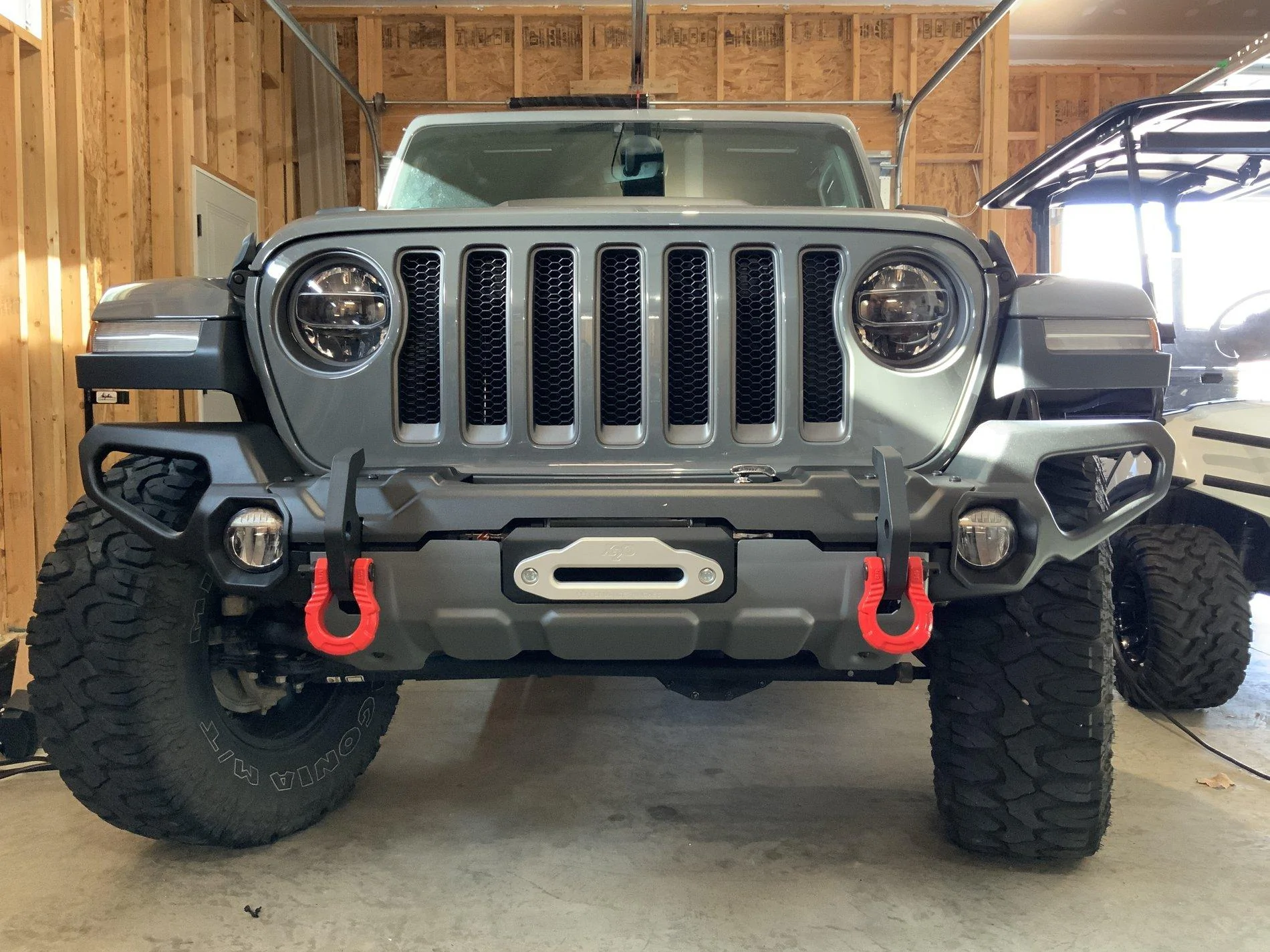

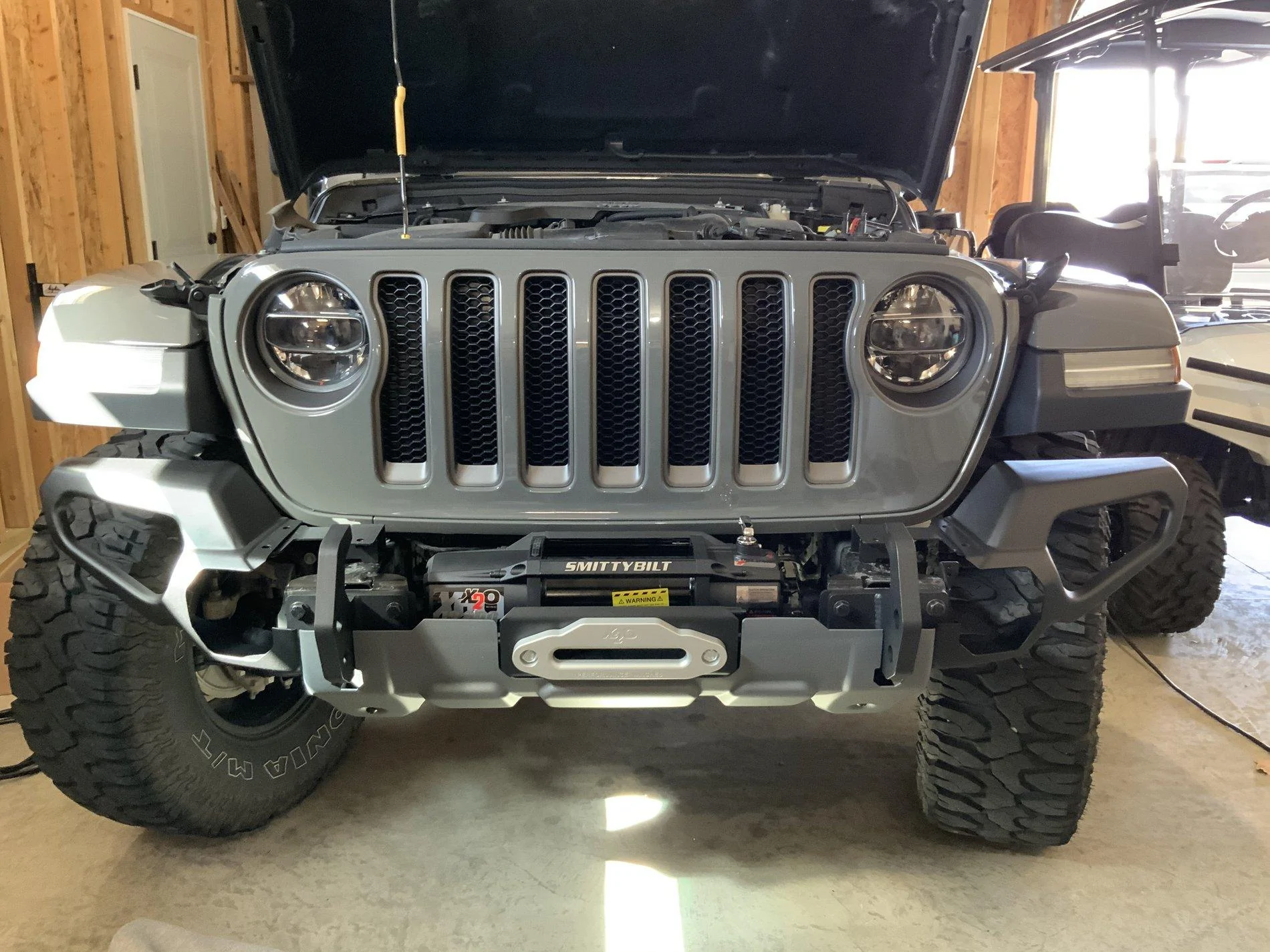

Just got in my RR Venator bumper and decided to install it along with Gear America shackles and a Smittybilt X2O 12k winch. Got the winch all hooked up just to find out it has a bad solenoid, switch, or both. Un-wrenched it and will be returning it to Summit in favor of the Badland Apex from HFT.

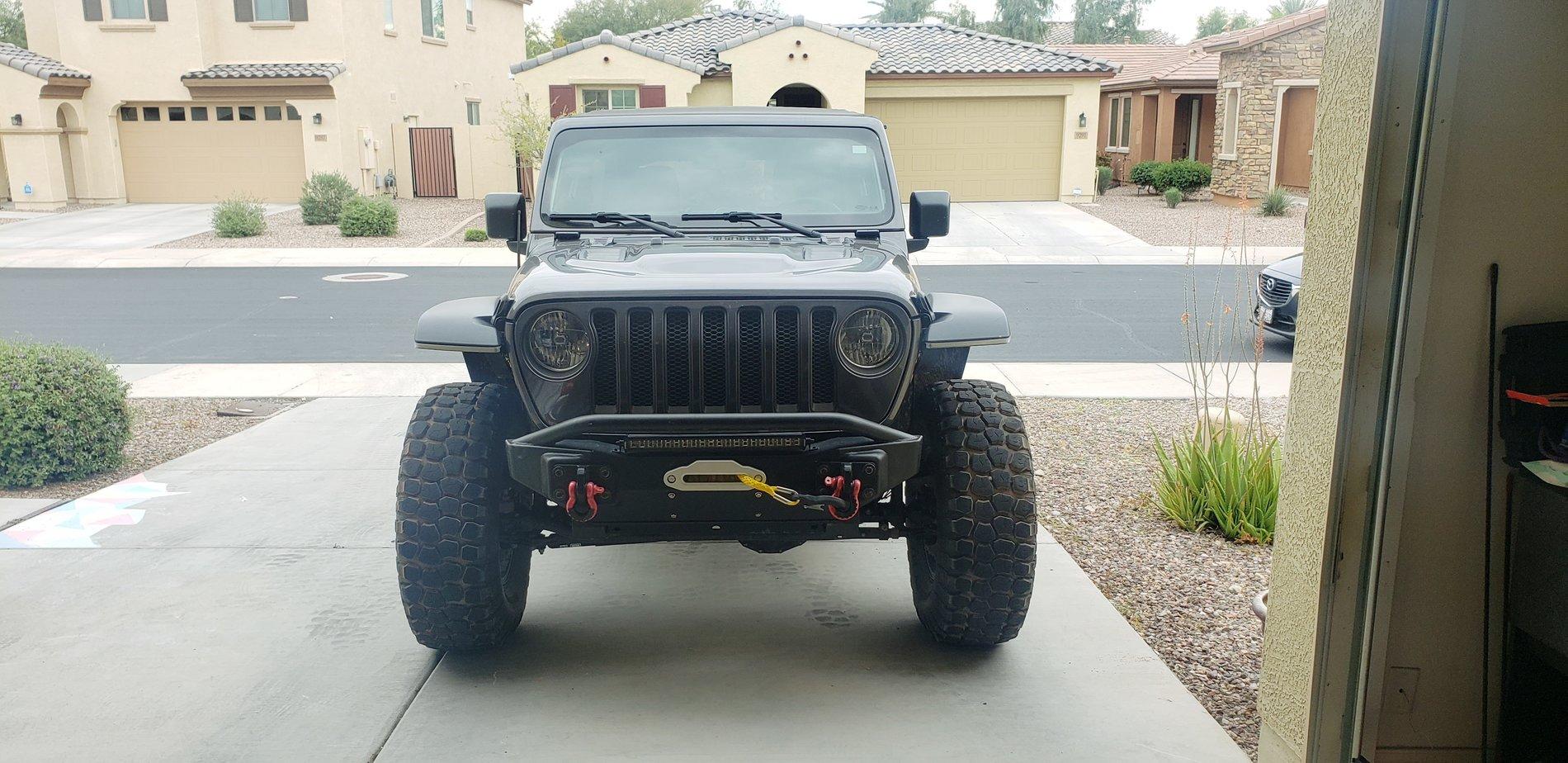

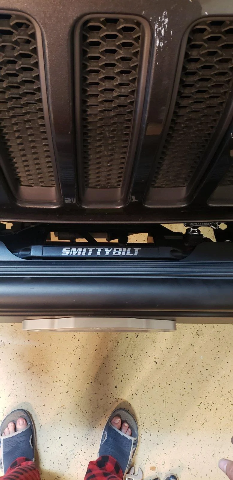

I installed a winch in my Roam Offroad bumper. I still need to figure out where I'm going to put the selonoid.

Nice job on installing it yourself but you really don’t need spring compressors when installing suspensions on a Jeep. Just loosen up the control arm bolts and drop the axle far enough to where the spring is easily removed.
That was the case with my factory springs but there was no way I was going to get the axle low enough to get the synergy springs in using jack stands and a floor jack.
I see... taller jack stands may come in handy for you in the future.
I use 6 ton jack stands and a floor jack and have done several lifts using the same setup. I have used spring compressor before on other suspension installs and I just try to avoid them if I could. They work, it just feels like a ticking time bomb :time::please::whew:
