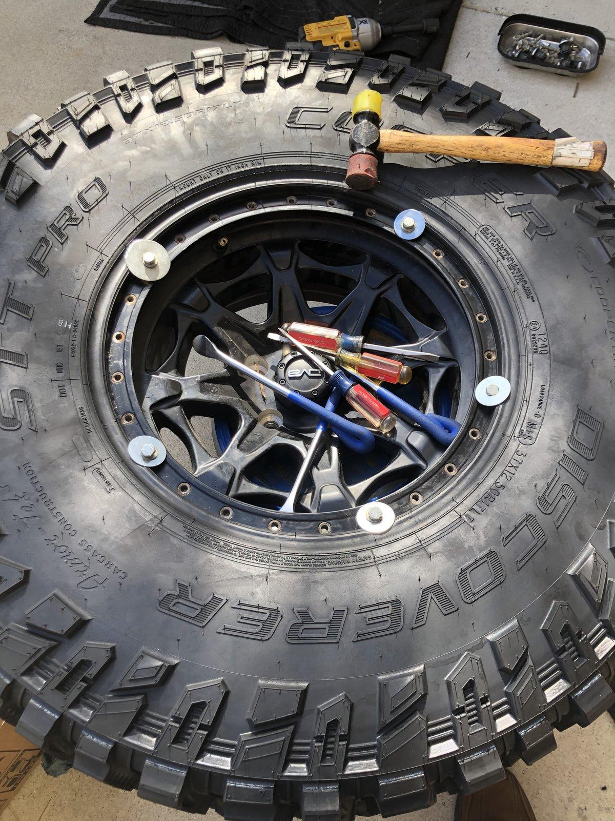

I replaced my rear tires on beadlocks, my least favorite wrenching job, and Not just because I have to put the tires back on.

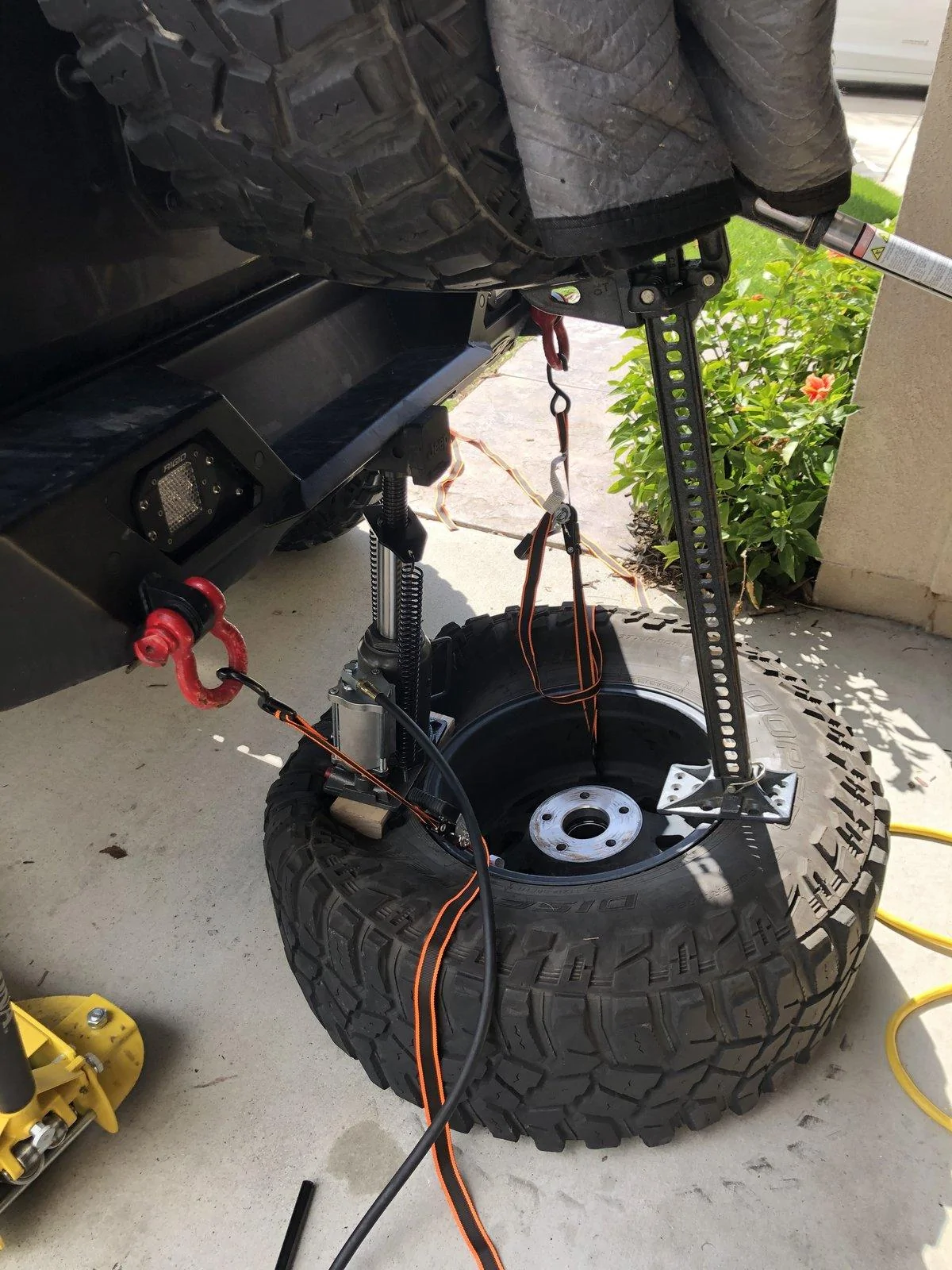

Well aren't you clever. I put my wheels up on a 35 gallon barrel so that the weight of the tire pulls down when mounting tires by hand. I like the bolt and washer trick to apply pressure. I will use that in the future. To break beads, I place the tire and wheel on the ground and take another vehicle and drive up on the tire as close to the bead as possible and then move the steering wheel back and forth and it will pull the bead off.
The bead breaking was complicated because the drive is rather slopped. I tried just the high lift and it lifted the jeep up and it started to slide around even with the wheels blocked I don’t have d-rings on the front. My wife’s Audi and my Ducati are no help either.

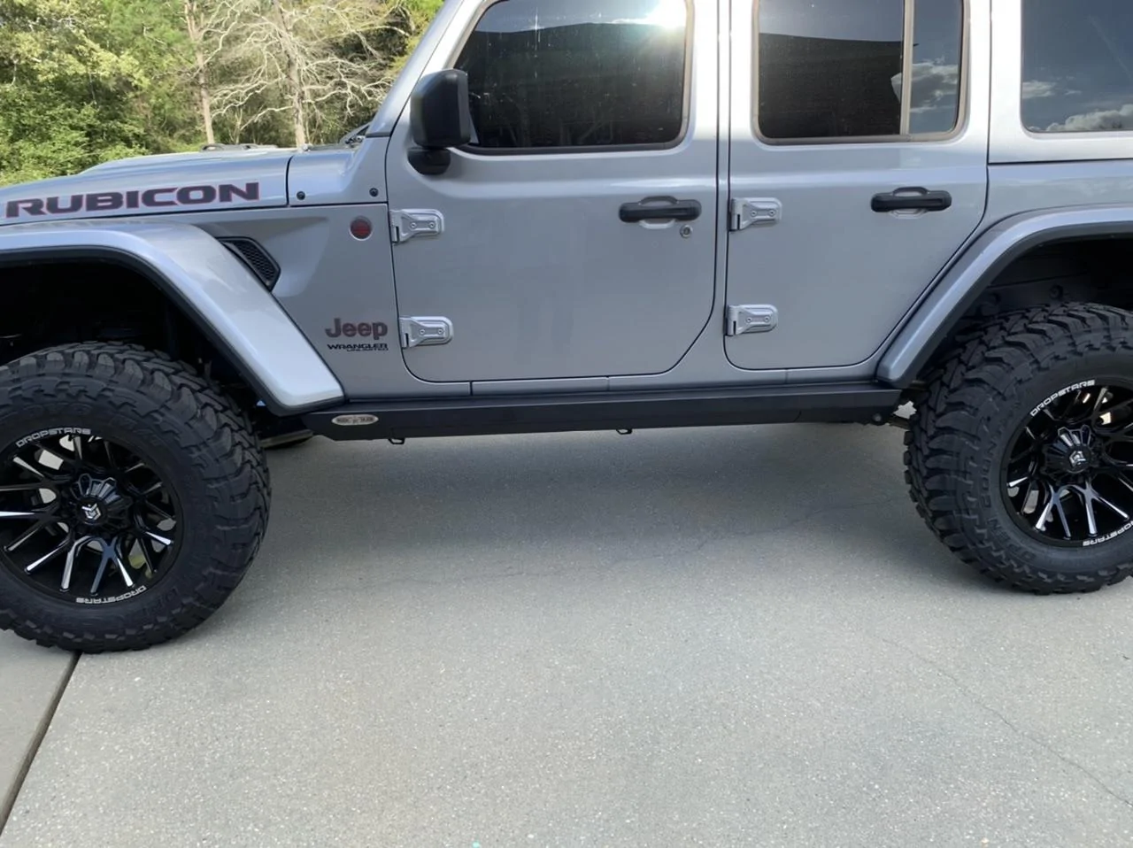

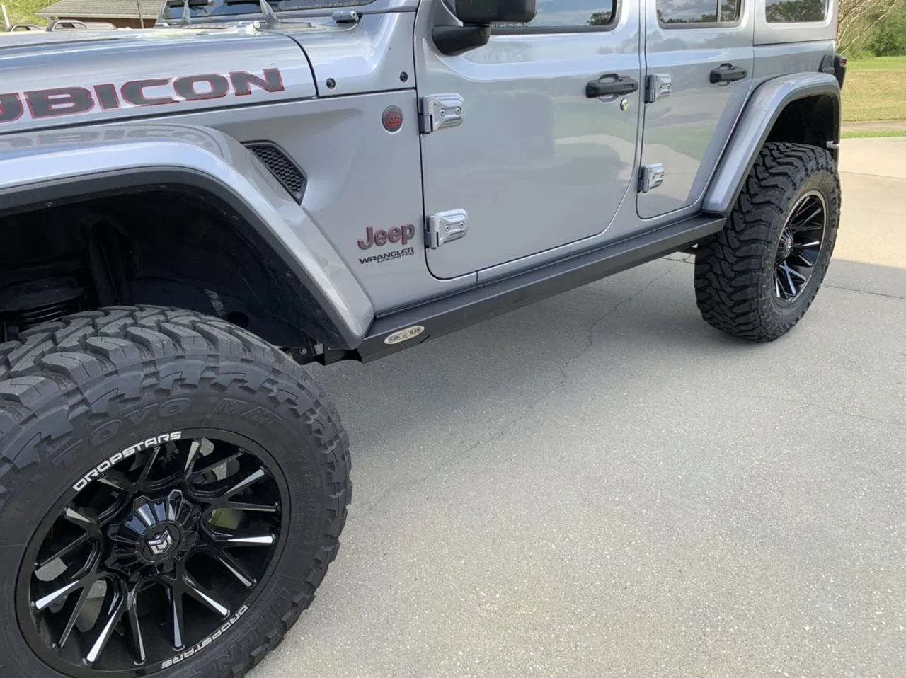

So finished the Rockslide Engineering power step install this weekend. I was asked on this thread a couple of questions: Fit and finish on steps appears to be top notch I guess I will see how it holds up. You will need two people a couple of times during the install, just to big and heavy to do by yourself. Lastly the holes in the bottom of the Jeep are to small for the connectors so you will need a pin removal tool and silicone to seal it back up.
All that said I am loving them so far.
