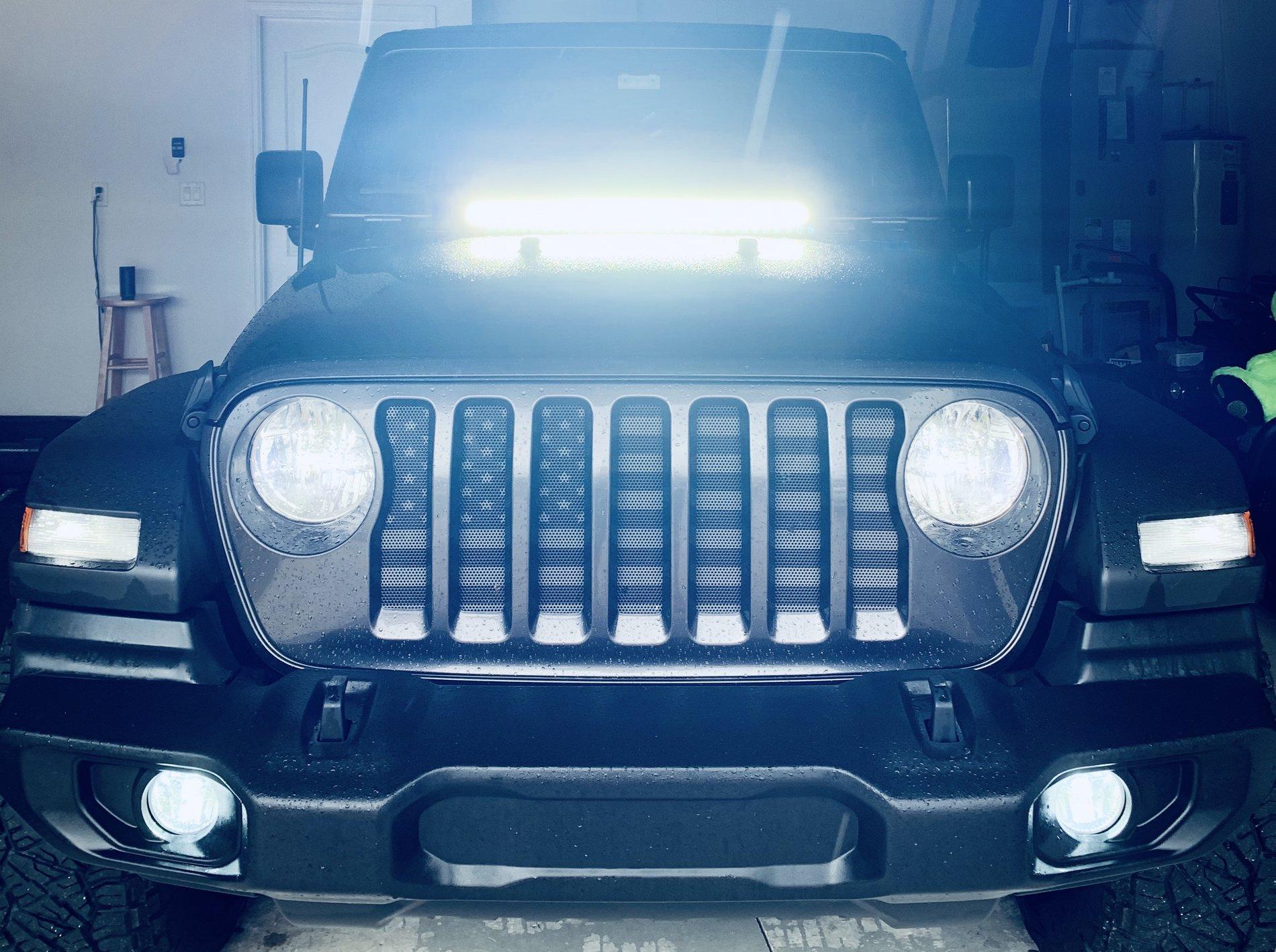

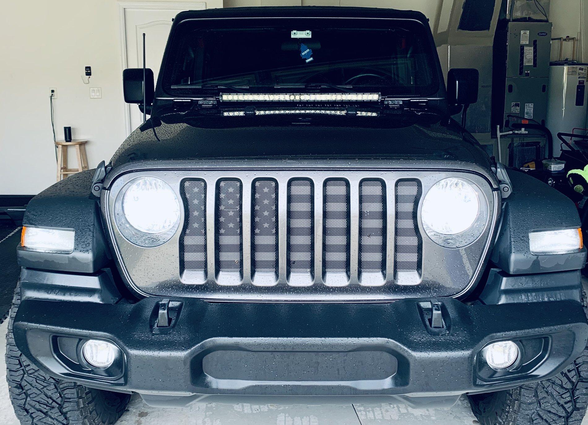

on my stock jl, i measured my headlights with the halogen bulbs at 35-36 inches. i did swap them out for the supernova led head and fog lights. and i love them. they light up the road nicely (still measured at 35-36 inches). i do get flashed a couple of times. only because they are @$$holes. i'm not planning on adjusting them because i want to see whats up ahead like pedestrians, deer, and morons driving without lights in the dark. half of the times dumb@$$es run their light (all kinds) on high beams.

Had LED bulbs put into my JLU halogen housings. On the drive home I noticed I was lighting up the trees 20-30ft off the ground on either side of the road. Saw it for myself that the halogen reflector isn’t designed to focus/control the LED light so you are blinding people and sorry to say...you’re being the “@$$hole”.
You yourself want to see hazards, but don’t become one yourself.
Either get yourself some upgrades halogen bulbs and reflectors or splurge on a proper LED kit, some are only $300.
first off all, my led lights are aimed in the same directions as to the stock halogen lights. since i had the led lights, i've been flash like 2 times since may of this year. and whats ironic they were running their stock led lights on high beam. most $300 led kits are crap. in your case you need to adjust the headlights so they are not lighting up the trees 20-30 feet off the ground. since you just joined this forum and only posted 4 post, i take it that you havent look thru out the forum and see what other have done or run for led bulbs, etc. so congrats on making an impression of yourself within the first 5 post and start calling me and potential members an @$$hole.
