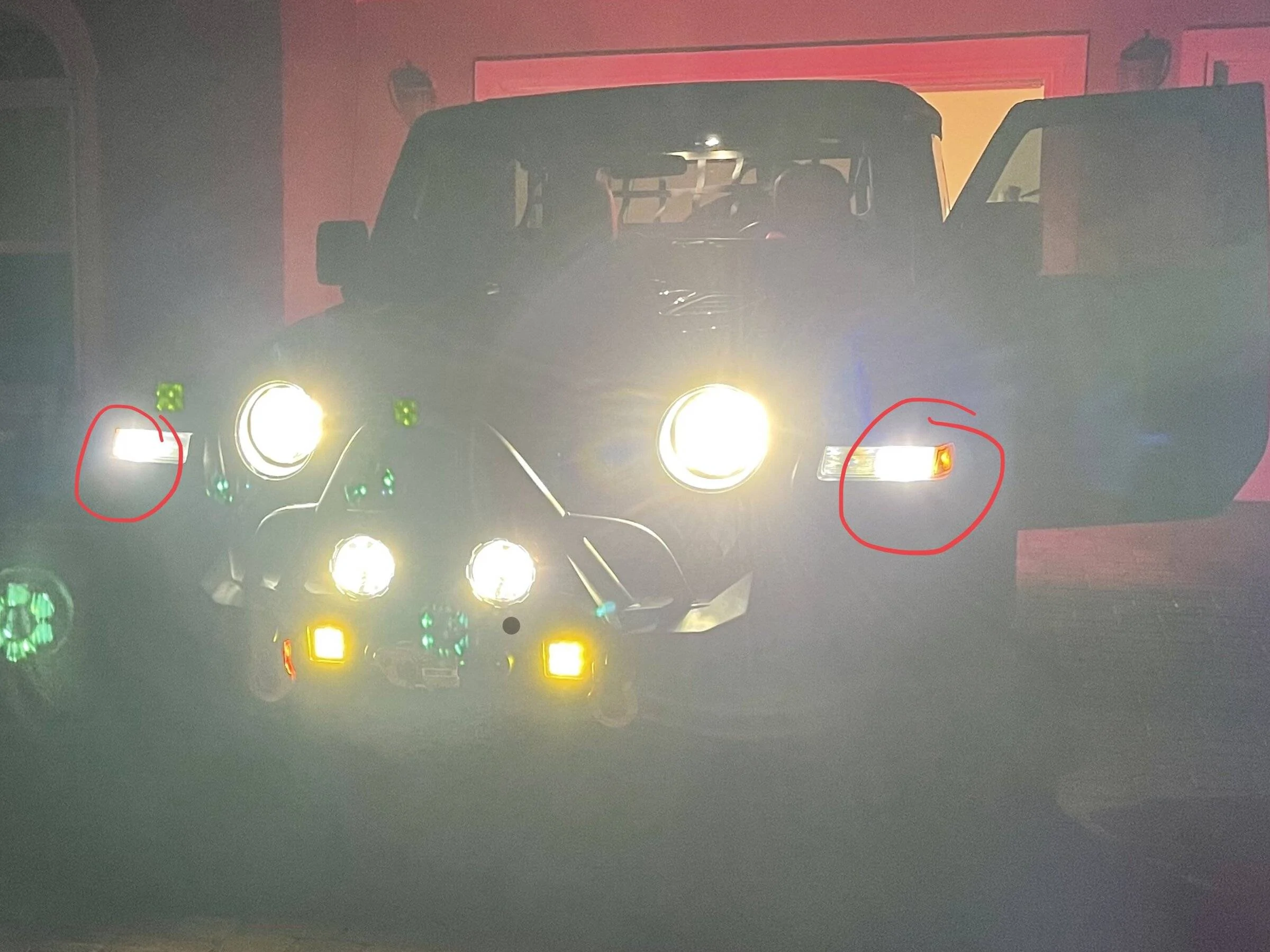

By oncoming drivers that believe your high beams are on?
When I'm towing at night, very rarely, it's worse.
Yes, I had to adjust my headlights lower. 2021 JLUR with LED pkg.
