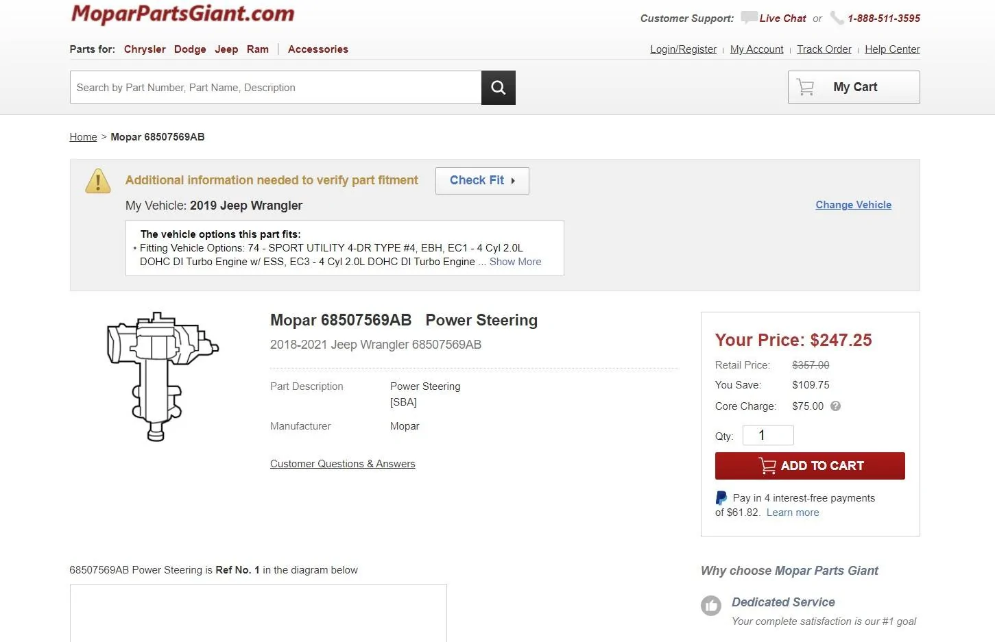

Even if I had to pay for the iron steering box, I was willing to do it. Online it's pretty cheap. Way cheaper than aftermarket. It is hydraulic. I suppose a pump conversion to engine driven instead of electric motor driven hydraulic pump is possible with the factory box. In the case of the JL, the pump is actually electro-mechanical. You get the good and bad of both technologies.
Here's the current iron steering box. $250 online is cheap IMO. I'd do that before getting a $2k PSC aftermarket system, for my uses anyway.
