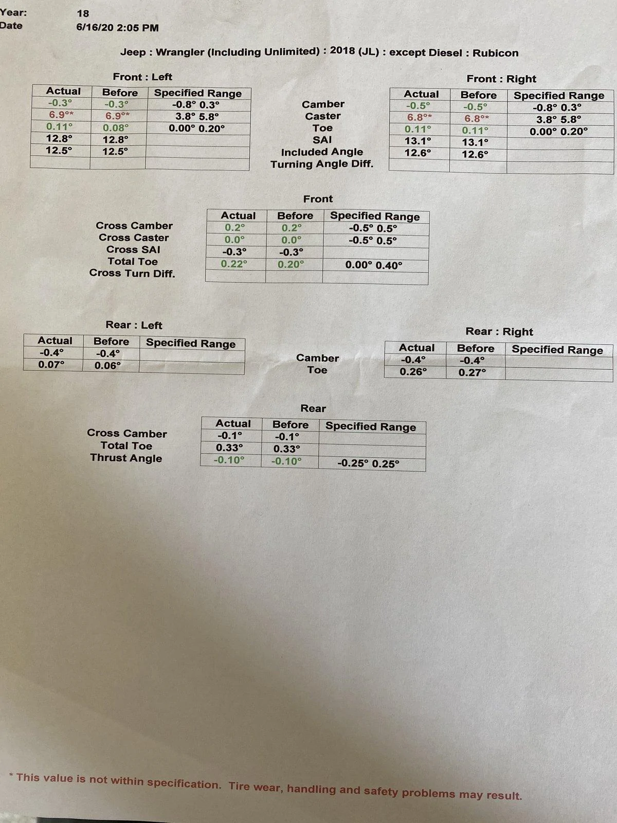

Just installed adjustable upper control arms and had Jeep realigned. I already had lowers on there when it was aligned last year.
Running - 2.5 inch teraflex lift with full steer smarts up front and rear track bar bracket. After the shops alignment the car seems to be pulling to the right a ton.
Do these numbers look right?
