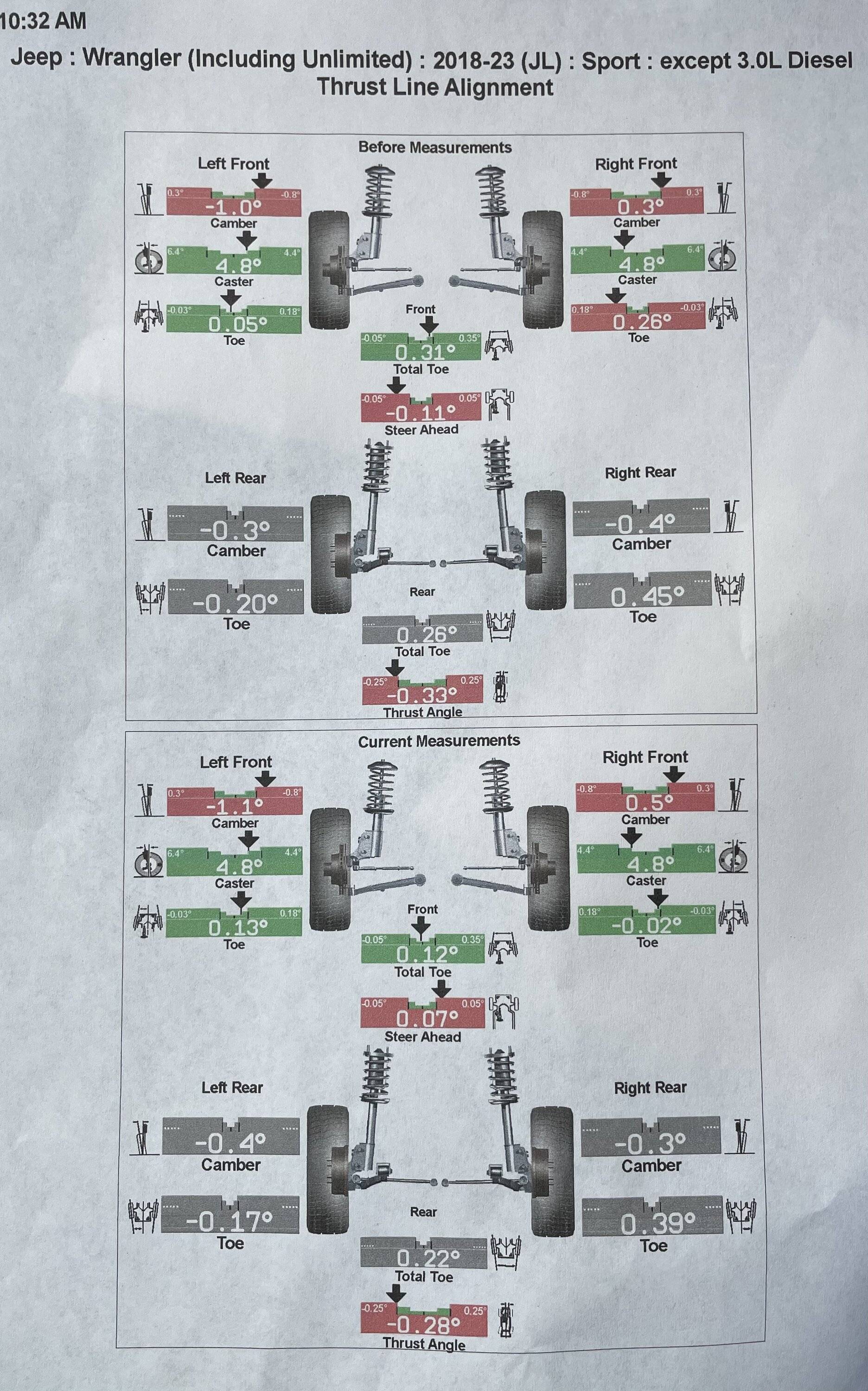

Hey all,
Just got done installing Clayton 1.5 Overland lift in my '18 JLU sport. (springs, 8x control arms) I took it to the alignment shop to get some numbers and they adjusted the toe. I'm new to adjustable control arms, so now time to fine tune. Based on this alignment report, for thrust alignment, left side is set back (right side forward) ever so slightly. (.33deg/.28def)Is that how i'm understanding it? Caster on the print reads 4.8, but on the axle it's reading right at 6deg caster Also, any other numbers stand out? Any feedback would be appreciated
