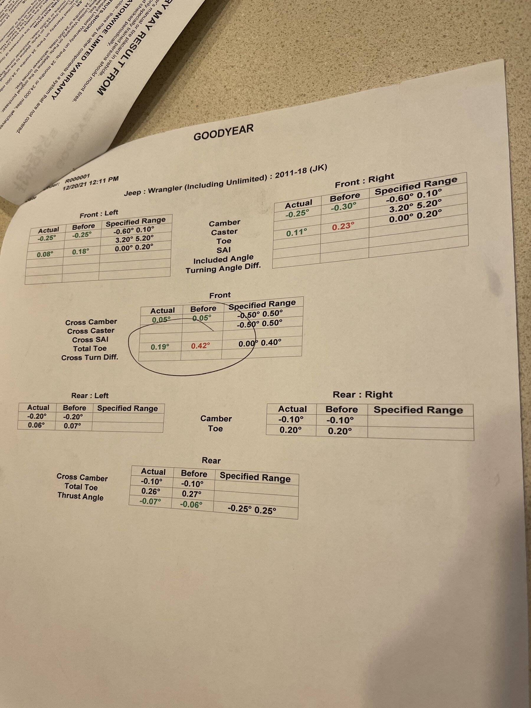

I got a new set of tires installed on my 2018 JLU sport and the shop claimed the vehicle needed an alignment. While reviewing the paperwork it seems they set the machine to a JK instead of a JL. I tried looking up specs to compare between the vehicles and to see if it’s OK, but I’m a little confused. Attached is a picture of the print out they gave me, hopefully the adjustment they made didn’t make things worse.
Anyone have any advice on this?

You should be slightly toed in, they did it right.

Your toe was way off base, did you smack a curb or something? Could have set it up as a Chevy pickup, doesn’t matter, they couldn’t adjust anything but toe anyway.

I just bought the Jeep from a used car lot a few weeks ago and really haven’t driven it much. I must have bought it like that and didn’t notice. Just one of many marks the last owner left on it I guess.
Hopefully nothings bent now that I think about it.
