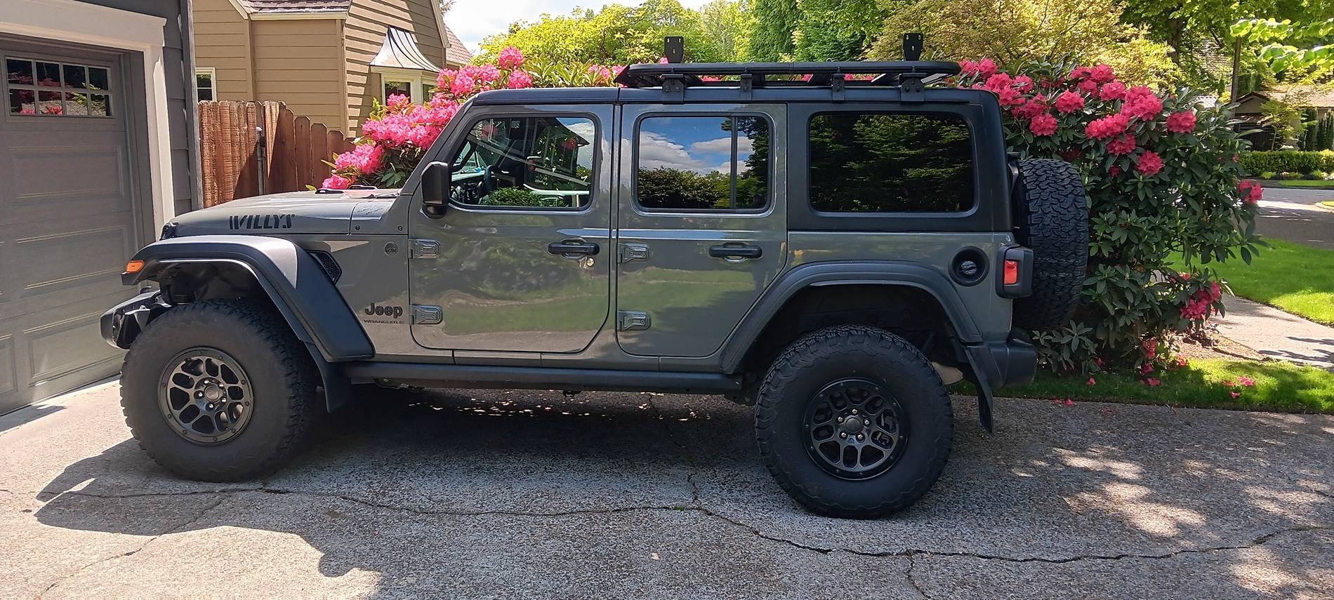

23 JLU Willys XR 2.0T. Came with a clutch type limited slip rear, open front, and a FAD. I'm not a fan of clutch type limited slips, but better than an open diff.
Money was not an issue, I could have easily bought a Rubicon. A few reasons I didn't:
1. I'm not rock crawling this Jeep. The 4:1 Rubicon transfer case to me would be too low, especially coupled to an automatic tranny.
2. With Rubicon lockers it is "all or nothing". Open or locked. Fully locked isn't the greatest in snow packed roads (I live in the PNW). With TrueTracs they're always on, work great, but invisible on pavement.
3. No wires or anything to make them (TrueTracs) work, no added complexity to fail.
4. The money well spent was the XR package. HD axles, mild lift, 4.56 gears, 35" tires, etc. That was the foundation.
Jeep Wrangler JL Adding front locker to Willys? 20250503_140134
Am I correct the newer Willys comes with a Rubicon type rear locker? And no FAD?
In my 23, I swapped in TrueTracs front and rear. Did a Mopar FAD delete plate, and a Tazer so the Jeep doesn't recognize the FAD is missing.
Anyways, to the OP, I would recommend a TrueTrac up front. Much better than an open diff, it is always on, and is invisible driving on pavement.
