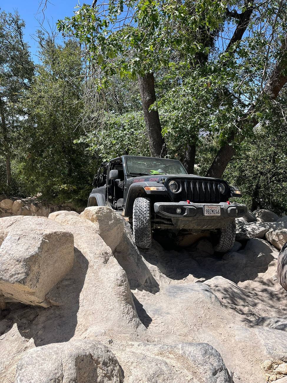

This obstacle, on a trail rated a 7, required a few feet worth of front locker use.
I used the locker before I ever got to this point. I wasn't even using my rear here
