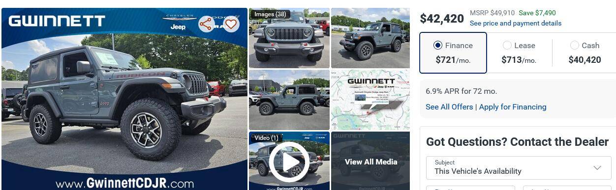

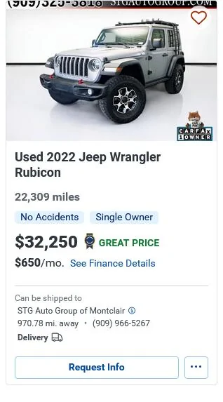

Look on autotrader. I think you're seeing Willys for $45k ish, I found a new one for $33k across the country. New Rubicon for $42k. Get you in a low mileage used one for $32k. I would say those are significant savings!
Autotrader is great, looking there now.
Willys comes out to $39k with the hard top when factoring in employee pricing and cash bonus. My dealership has said they would offer that on a new order as well. Rubicon comes to $45k. Used are definitely a good option too...
