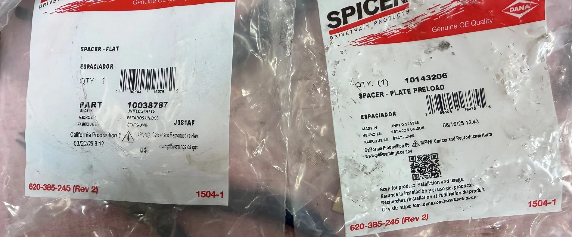

  1. Bronco Raptor Locker actuator coil Dana Spicer P/N 10102021 sourced from any Dana Spicer dealer
    1. Differential Solenoid Spacer, Dana Spicer P/N 10038787
    2. Differential Solenoid Plate, Dana Spicer P/N 1014320

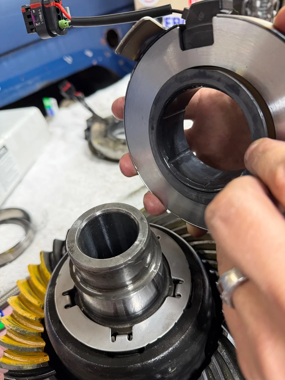

      Jeep Wrangler JL Front Locker Coil Replacement with Bronco Locker IMG_0240
      Jeep Wrangler JL Front Locker Coil Replacement with Bronco Locker IMG_0241
Just executed this repair to the Advantech m220 wide out of a 392 installed in a sahara. Lockers wired to Lasfit switches. Spacer plate and spacer flat are essential. Also mouser 571-1-1718645-1 connector and ferrules. Additional pictures to this great write up. Thank you community.
